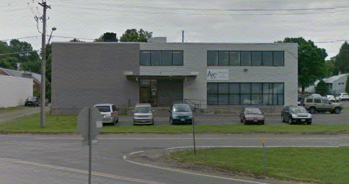

No, but it is always handy and fun to lookup the company address on Google Street Maps. These guys occupy Suite 2 in this building. They don't even display their company name. Makes you wonder.:eek:
The efficient power amplifier was described as a summer project in Elector of 1982 and was also used by several Japanese amplifier companies at the time, so nothing new here. The distortion reducing schemes correlate with publications from Sigfried Linkwitz also from the eighties.
