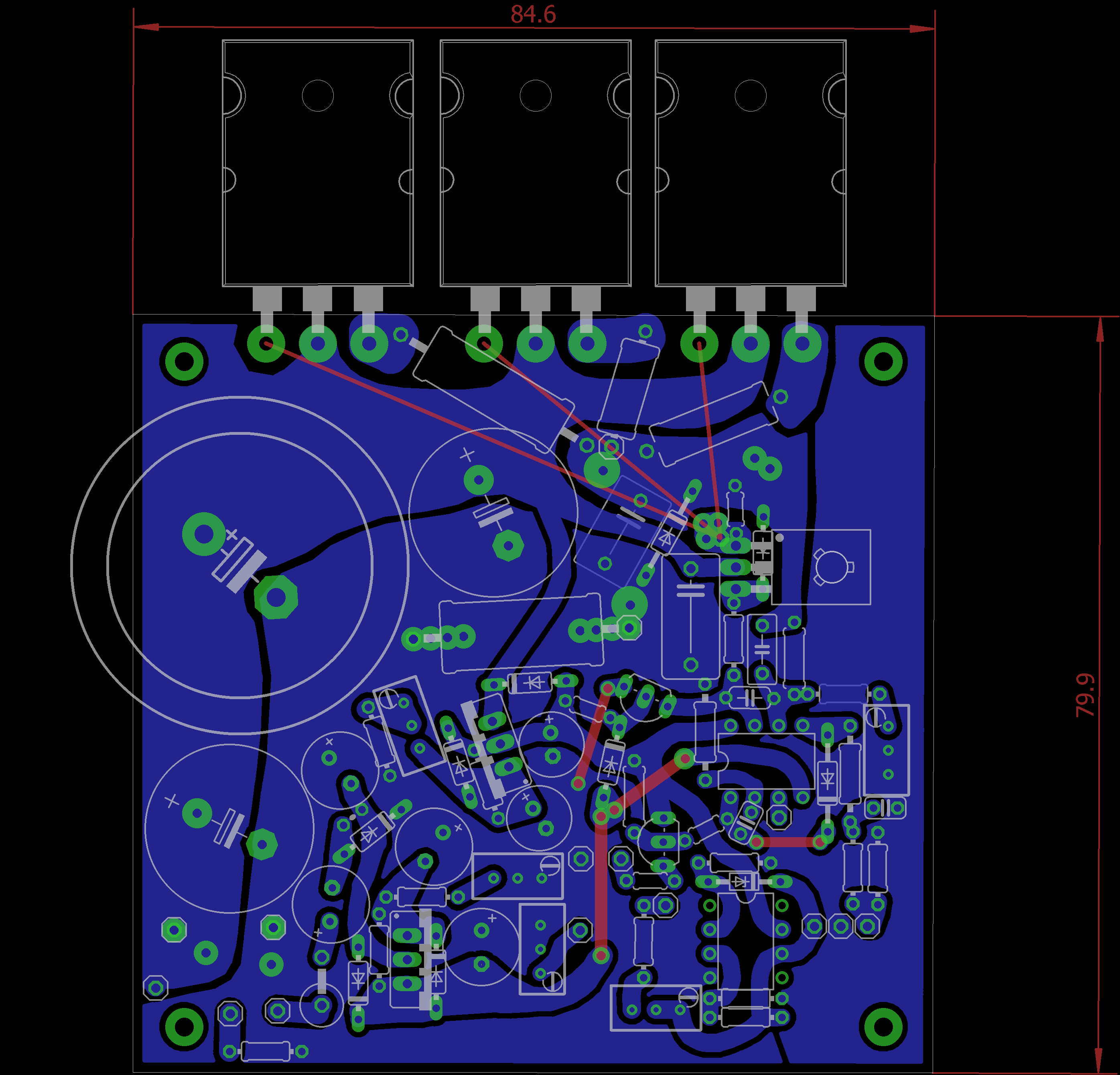

Someone considered using this PSU ?
DIYfan: Adjustable Lab Power Supply - take two
I built it on veroboards, two channels in one case forming +/-30V split supply's if necessary. 2.5 years has been passed and it is still in use all day long , it eats everything and protects it at the same time. It is really variable from every corner.
Decided to use it in audio circuits with 50V DC transformers, so i made PCB. If tested and ok, i will publish the PCB's
Please, All credits to the Owner of that linked blog.
Hi rensli, thank you for posting. I have seen that design before on electronics_labs. I like that you have had long term success with it! I am still debating whether I will use the 317 or not. I probably will since its the easiest to work with.
