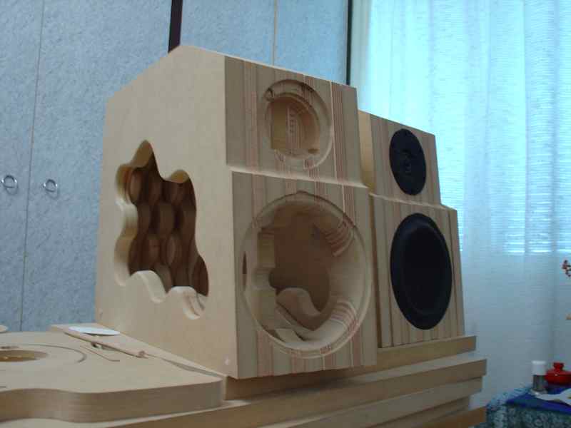

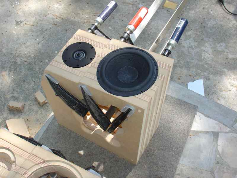

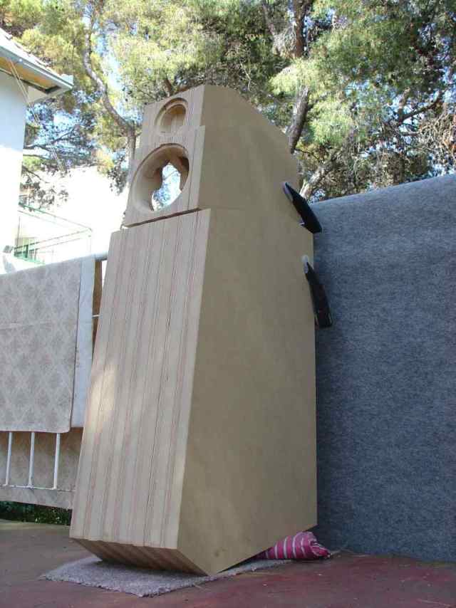

Hi all
Thanks for suggestions ;-) so I can go booth way...preamp at the input and output.
I mean to use this thing (DCX) for driving 2x3 amps for active 2.5way loudspeakers which was based on Edgar’s EVE II but it turns out as a completely new project.
So I’m stuck with project that is very time and money consuming, but I hope it will worth the effort I put in.
The drives and the amps
Aleph mini - ScanSpeak 2904/7000
Aleph 30 - ScanSpeak 18W8545
AlephX - ScanSpeak 21W8555-01
preamp would be AlephP1.7
now, if any one of you ever build something from Pass knows how much it cost and how much heat it produce...now think how much it's for six little monsters :)
any way it's fun ;-) ... unfortinaly it takes time to make something like this, especially if you don’t have place where you can work everyday on project like this.
I was hoping, that DCX would help me, to get this thing sing as I would like to ;-)
Here are some pictures ( I have place some of them on the forum before ...but ;-) )
