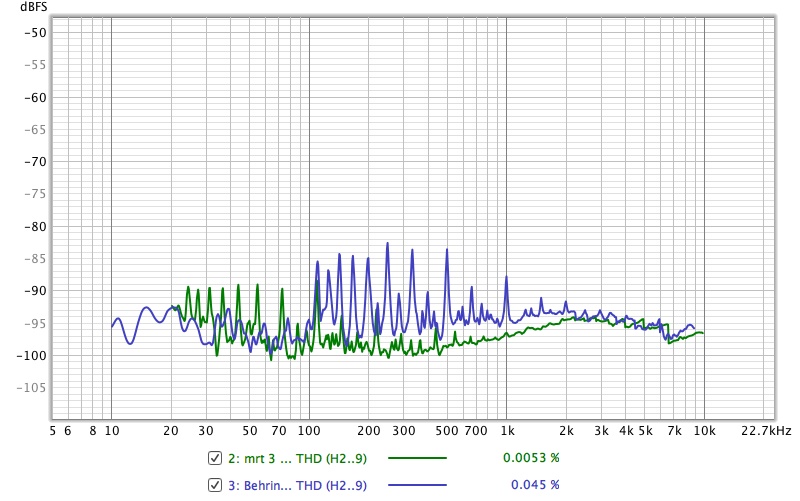

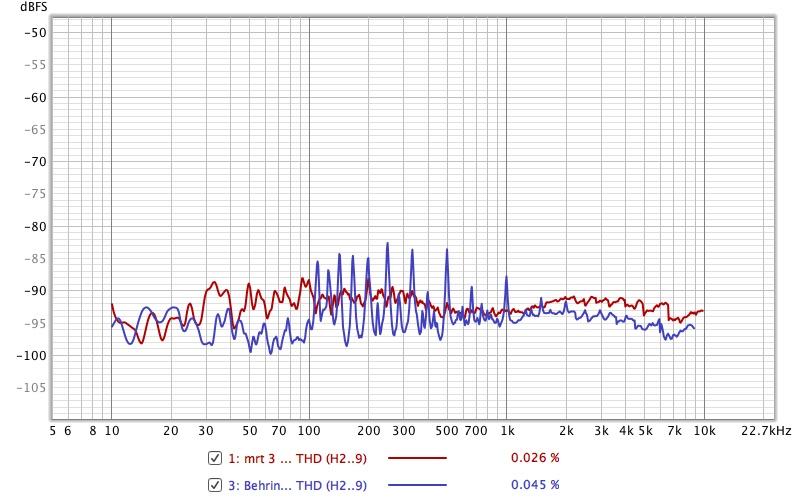

Not sure I am following the discussion too well, but I took the attachment of post #4411 ("Tommod4") and compared it to my very quick and dirty minimally gussied-up 12-smoothed curve.
There are two curves in the attachment, one looks a tiny bit better than the other. My distortion curve is the one marked "Behrin...". The plot shows the crap-level below the fundamental (which in all Behringer plots is just flat, of course).
Both not audibly different than my quick and dirty test since the THD is in the residual test noise level and well below most homes and so a waste of time, at least judging from this one datum.
I am using a coax S/PDIF input A digital input (which isn't quite an AES signal and so to Behringer's credit that it seems to use it just fine anyway). So there's still room for people to argue about all the crap introduced when using the analog input A.
Have I previously mentioned I bought this Behringer about a dozen years ago. Basic model hasn't changed except for LE budget omissions.
B.

Pano is right, the unit is stock although quite old. But I used a digital signal to Input A (as many people will be doing) and therefore skipped past the DCX's input ADC conversion. Some people (not me) think that the input ADC and the output DAC are weak links inside the DCX, so maybe not the full-monty stock as some use theirs.
My posted test results are done with my "vintage" equipment in the loop and would have looked even better had I used a louder input. Testing with a louder signal raises the signal further out of the noise when testing but, up to clipping point should not increase relative distortion.
Also, I just sat down and ran REW and just posted the first curve that I got.
Anybody with REW and some cables can test their unit. I been pestering this thread to show test results for many years. Looks like it's happening now.
