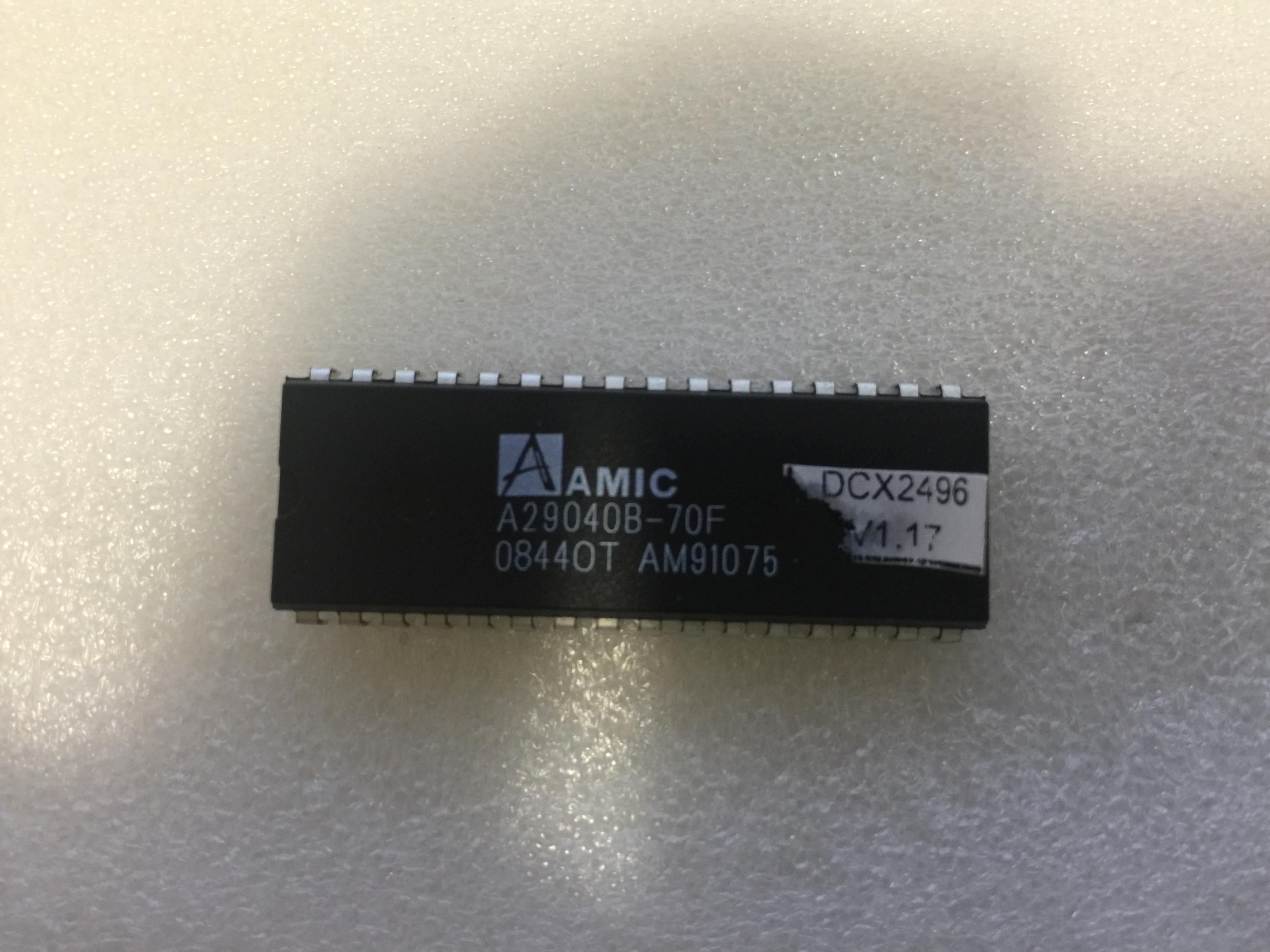

DCX2496 Flash corrupt?
I am looking for some advice/help. I have a DCX2496 that I have used for many years to crossover my home built ESLs. During one of the PC to device configuration saves something must have corrupted the Flash. I was using a usb to rs-232 converter which I learned is suspect. The unit boots to the product splash screen and locks. Tried a factory rest of <page and >page while powering up to no avail. Can the factor prom be reflashed with the V1.17 image on the Behringer website? Is there anyone that can reflash this prom?
Many Thanks.
Kono

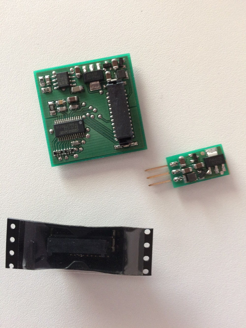

I'm that guy...have a few left...let me know if you have any questions...
