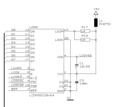

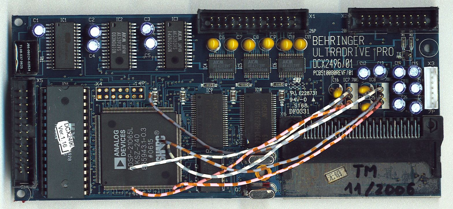

I've decided to mod my DCX to full extent. I already did the capacitor passive out and digital direct in mods and further I'll replace the power supply, the clock, the ASRC and DAC's in that order. It's a whole lot of work and investment but I love my DCX and going for a Nadja DSP would be more expensive as I estimated. Also I like the sound of the unit very much as-is, especially after getting a WaveIO and a ReflektorD for it, and switching to AP Linux for playing hi-res files.
Let's talk about the power supply. I'll ditch the SMPS and go for Salas shunts. I studied the schematic pretty closely so I know my way around the DSP board. The number of required voltages is pretty high but after some design decisions I decided to leave out the +-15V rails as I don't need the output stage, also ditch the +9V feeding the two on-board 7805s. One of them feeds the A/D converters, which I don't plan to use, and the other the DACs. The +5V for their supply gets further lowered to 3.3V via a transistor and some resistors. I find that unacceptable and plan to separate it.
The voltages I'll need are 5V and 3V feeding the digital part and also for the front panel and another 5V and 3V for the DACs.

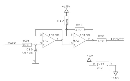

The only hiccup in this plan is a TL072 amplifying a signal PWM0 to LCDVEE and this is where I need your help.
I guess it's for setting the contrast on the front panel LCD, but I'm not sure what voltages does the TL072 output and could I simply replace it with a trimmer and set the contrast manually if that's what it really does. I don't feel like dissecting the DCX just to measure the LCDVEE now when I'm in the design phase knowing the fragility of the DSP board.
Anyway here's the compete schematic and the picture of a half-complete DSP board mod.
Please point to any flaws in my plan.

BTW the TL072 on the display brightness is preceded by a low-pass and you could just measure the DC at it's output.

If this is a unit you're going to hang onto for awhile, consider modifying it with Jan's modification. The stock DCX2496 has numerous issues/drawbacks for those of us using it in a non-professional environment. Jan's modification fixes every single one of those issues.

Gino, If this is a unit you're going to hang onto for awhile, consider modifying it with Jan's modification.

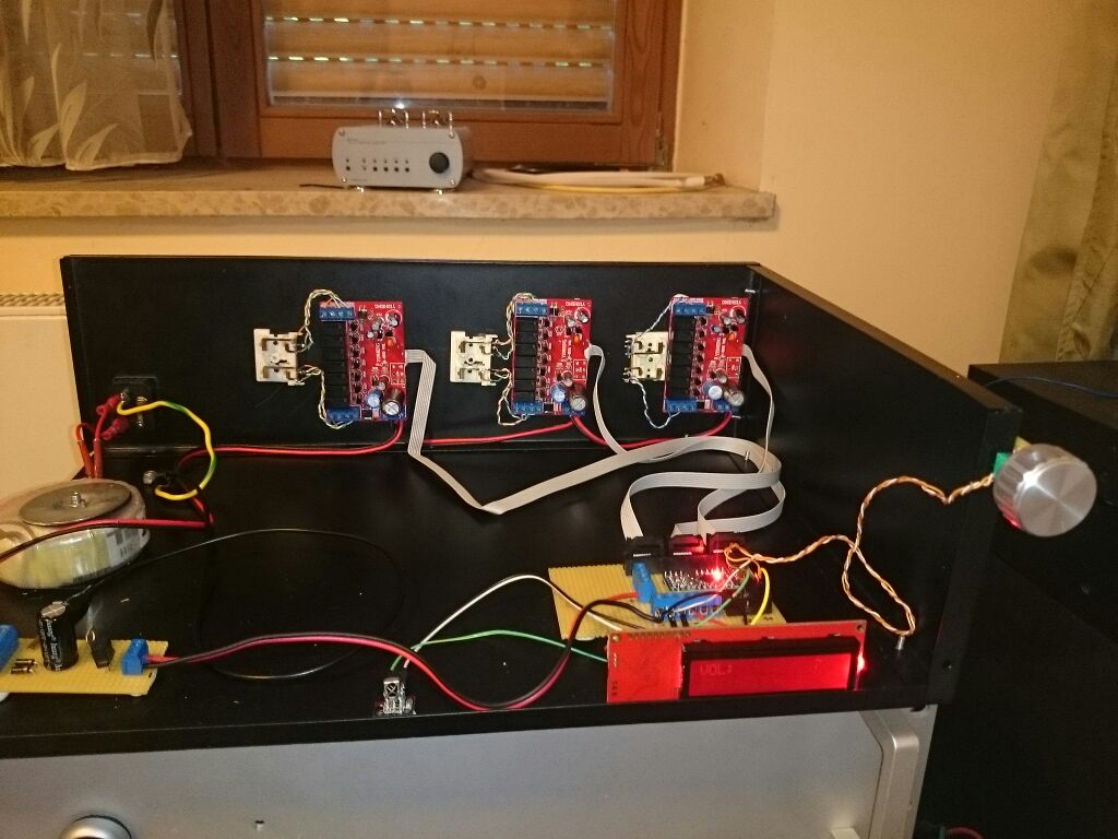

Jan, can you confirm that the TL072 actually controls the display contrast? I just made an educated guess...

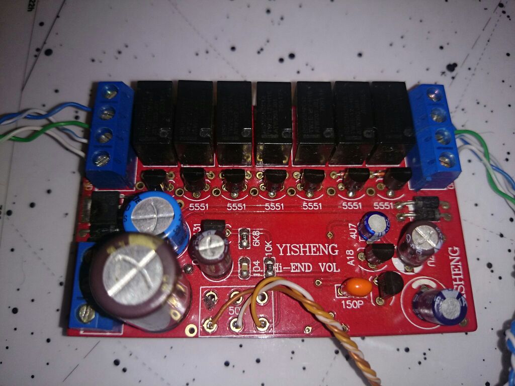

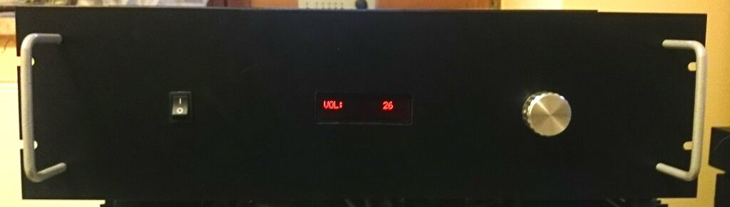

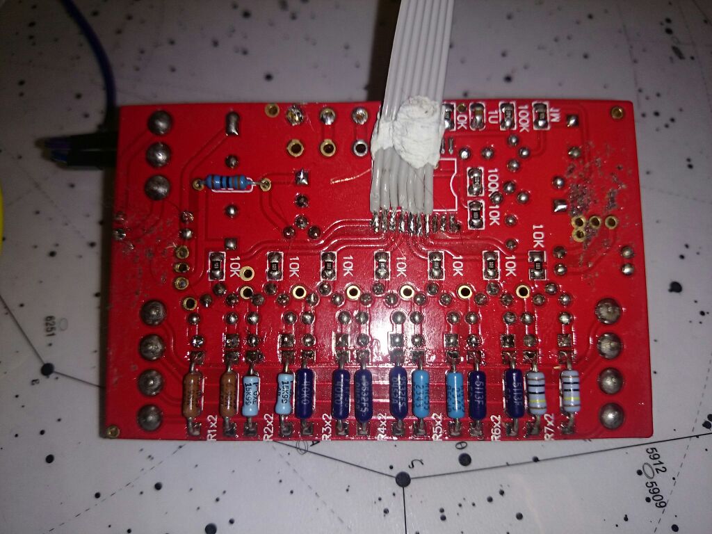

As for controlling the volume I came up with an elegant solution. There are numerous relay switched resistor network-style around, either in DIY or as an flea-bay kit.
Those use a analog-to digital converter to control the relays via a pot. I desoldered the A/D converter on three of those ebay-boards and connected the relay driving transistors to an arduino microcontroller.
They are very easy to program and have an array of available extensions as a display, rotary encoder od an IR receiver.
And voila - a six channel volume control for under $200!

Well gino, I can give you my example of using a DCX.
First, my music is on a computer running AP-Linux and with no volume controll, the volume is set to max permanently. Then the computer is connected to a USB "soundcard" with SPDIF output. The card is Lorien's WaveIO asynchronous USB interface. I feed the SPDIF signal directly to the DCX AES/EBU transformer with a coax cable. After the DCX is a 6-channel volume control I described a few posts earlier. This is where the attenuation of volume happens. From the 6-channel vol ctrl the signal goes to three different amplifiers, for treble, for midbass and for a subwoofer. I use a dipole arrangement for the treble and midbass so some sort of equalization is required and the digital crossover helps a lot too.
Did anybody measure the power consumption for each power supply rail under load? Tnx
After the DCX is a 6-channel volume control I described a few posts earlier. This is where the attenuation of volume happens .
