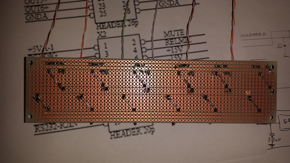

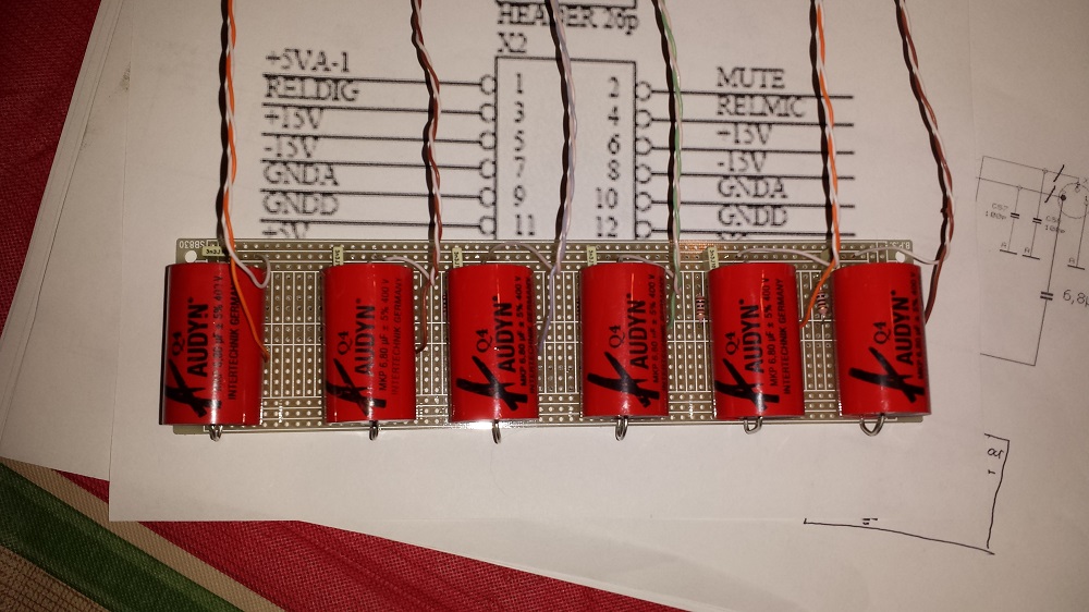

I did find one image showing someone's mod that's pretty much exactly what I'm trying to do. Not flying completely blind, but it's a little less than I'm comfortable with.
If you guys with experience modding these units wouldn't mind giving me a double-check, I'll post some pictures later as I progress so you can stop me if it looks like I'm creating a smoke machine instead of bypassing the output stage :p
Edit: Here's my board so far.
So, I got one of these units to tinker with. Does anyone have any of the images that used to be here: passive output stage for DCX2496 tweakanalog5.php and all the rest of the pages seem to be missing. I sent an e-mail to ask, but that was a few days ago. I'm pretty sure it's abandoned.
I'm pretty sure I have the board for the passive output built properly, but the information that's available now is so sketchy, the yahoo group is gone, and most of the pages are at least half gone. I'd really love to see (without digging through 368 pages of mostly dead links) any images of the ribbon cable tapped into or really anything from their passive modded unit.

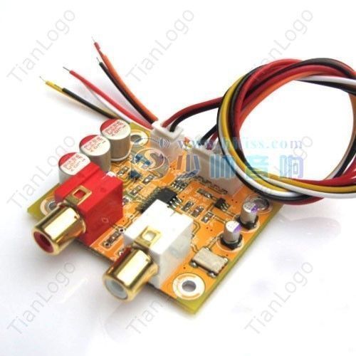

What I've been wondering for some time now, is are the AKM DACs in there fed regular I2S? [or not?] So could I drop in pre-made ES9023 boards [single-ended out] and SHARE the I2S signals with the AKM DACs? Say 50 Ohms R in each leg to the ES9023 {x3 DAC boards} I2S pins [SMD resistors]? Assuming I had the proper PSUs... maybe 3 of these:
Curryman DAC (ES9023) | MiniDSP
or 3 of the sub $20 cheapies from *Bay? I would probably use bits of wire_wrap wire pre-tinned to tack onto existing I2S pins on AKM DACs [or to: them].
Or Ti PCM5102A boards; they only need 3 of the I2S lines to operate [well, ES9023 can do that with a dedicated clock on MCK, on say the Curryman board] :
http://www.ti.com/lit/ds/symlink/pcm5102a.pdf
Someone may have replied to my query about that this implant idea, I forget.
384kHz/32Bit PCM5102A DAC, I2S input, Ultra Low Noise Regulator - DIYINHK
Then there is my other question about adding USB-to-I2S in on the DCX, NOT USB to S/PDIF. Hmm. At some point it gets to be pointless with all the newer technology that has emerged. But I have a DCX to play with... time? not so much.

I would only be using for home HiFi RCA jacks... everything looks like a FLAC-DAC to me. Well, that's not quite true, I have various stacks of amps to play with, from Carver cubes to Samsons to Behringer A500s [to MOD of course], some have differential in, but i think they use some iffy opamp to convert to single-ended. active cross would be for me to play with the many drivers I have, LRAD/ATC, Neo10s, Neo8s, Neo3s, various PE closeout moving coil drivers...enough to make one heck of a line-array, I would not passive cross. Oh I have a case of huge non-polar caps :) but. Maybe 60uF?
SO you have SPDIF coming out for 2 stereo channels? Are you sorta confirming if I tacked in a few ES9023 boards running asynch 50Mhz MCK, that I could pluck off 3-wire I2S per band and have RCA jacks....to my "stereo", would my simulcast idea work? 50Ohms per I2s leg to ES9023 [times 2-3 of those]? You may recall, I have oh, 100+ ES9023 laying around, and some blooper boards...100s of LT regulators, clocks, all that. Time? Not so much. drill a few holes for RCAs...
At one point I was psyched to drop on 3) Broskie Unbalancers implemented with 6n16B-V tubes, lotta work.
If you would like to tap into I2S than you should think joining in one case DCX and your DACs, Most likely move DCX to a bigger case, or join two of them. I2S should transfer signals only on very short distance. If you do not want to do that than S/PDIF with appropriate transmitters is the way to do it.
posted here a few times already, but one more time (hope its ok):
wolfson transceiver chips (just 2; wanted to do 3 but ran out of motivation, lol) and some wire-wrap wire to tap into the i2s pads. was not really hard.
I plan to repeat this with AK transmitter chips. but its known to work (pretty well) with the wolfsons.
I would not put dac chips in the same box. I like this being a 'numbers box' (no analog at all, just digital in and digital out). the PSU does not matter (I know, its debatable, but my take is that the PSU does not matter at this level) and spdif 'exports' very well from one box to another. some people like exporting i2s. I'm not really one of them, but to each his own.
fitting ES9023 boards to DCX
I was thinking take RCA jacks off of cheap ES9023 boards and get them to fit as close as possible. I would probably not ever change DACs.
Some of the PSU mods I have considered would be very cheap for the stock DCX, and for the ES9023{s} I could insert a better dedicated 5V.
Alternatively, yes, I see that I could make SPDIF DAC-amps too, I somehow thought keeping leads short and using straight I2S would give me the cleanest sound?
