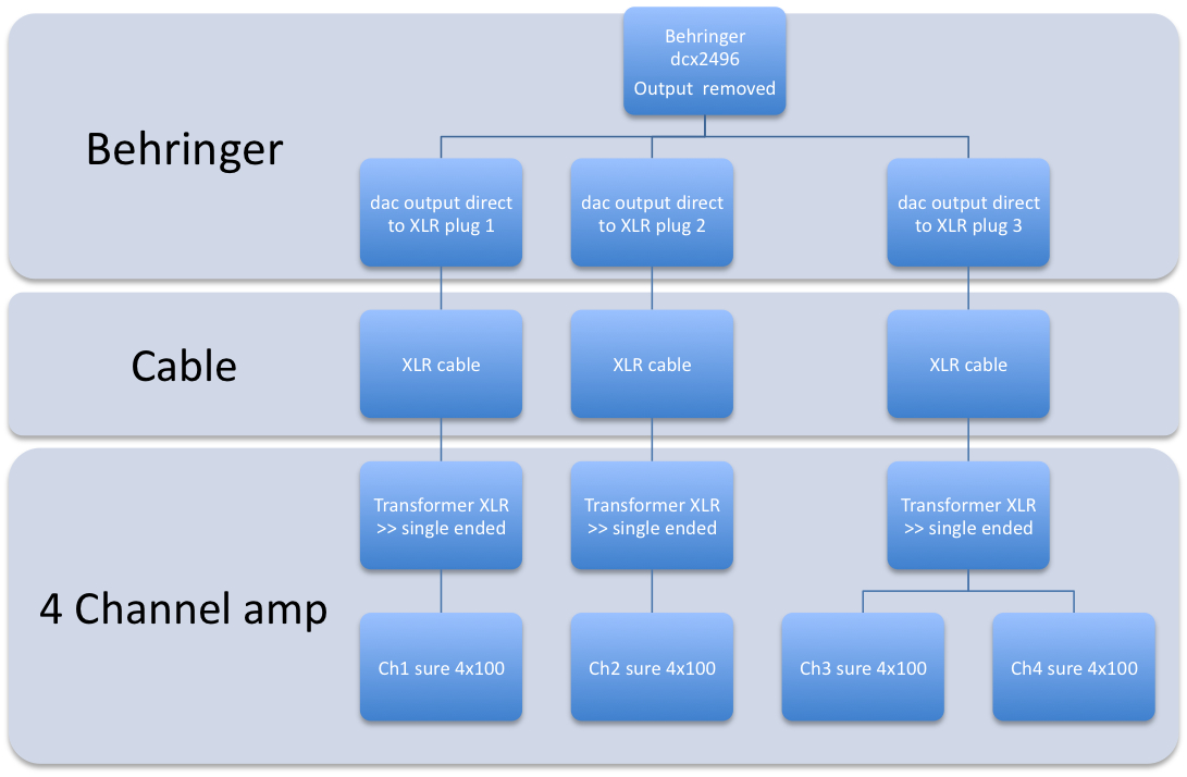

All,
I would like to know if the following is feasible.
Remove the complete output of the DCX2496, connect the dac outputs directly to the xlr connectors (no filtering of the DC voltage etc.) and replace the output with input transformers in my amp (see picture).
The advantages would be:
- very few parts (no caps) in the sound path.
- fully balanced until my single ended amp.
- DC voltage eliminated (though at the other end of the cable)
- expensive but few parts..... so very fair price!
All this inspired by the application note by Jensen transformers on connecting balanced and se equipment.
Thank you for your input.
Peter

Hi, it works only on the paper.
Change the output is not like change the bulb in a lamp.
The trafos works caring to the impedances seen by the primary and by the secondary. The ratio of the transformer is the key of this matter. You cannot forget. Otherwise the trafo doesn't work properly.
In your suggestion you don't care about the impedance matching. By the trafo you reflecy to the primary the impedance of your amps by the ratio2 of the trafo.
It works only, probably doesn't "sound"; only if you are lucky and the amps match the output impedance of the DACs. Study the data sheets and you will understand.
Better if you place the trafo inside the DCX. Look for a trafo with a center tap, and you place a "stupid" RC cell on this center tap, 33-47uF/10K is a classic. 10K or different depending on your amps, and you have to change the uF.
This RC filter:
1) helps a lot to clean the signal ... even if close to 75-100KHz you can ear a sweeter sound with the cell installed
2) matches the input impedances of your amps.
It is a classic, purist, solution to the DAC matter. The datasheet almost of all DACs describe this solution.

You need to charge DAC output with around 1k Ohm
You need to filter RC as well
A lot of people who used output transformers directly had DAC failed in time...

I am running direct out + and - signals from AK4939 to the primary of JT-11-EM (and exiting SE thru RCA). No other components (no resistor, no cap...). It works , so far. Are you saying that this is potentially wrong? Pls explain. I am not doubting you, just asking what is the correct way.

Yes It works! but...
I guess the problem guys had became because charge viewing by AK4393 (no 4939) was not 1k Ohm, depends also of course of amplifier input R value.
I do not know exactly when and why It was hapened because It's not my situation;
The other way of investigation should be the overload when switching on amplifier, depend on security with different amplifier (so many situation with so many amplifier I guess);
Another way became perhaps because no filtering at output ADAC and maybe some ground current appears.
So, usually It works, sometime It breaks down...
In doubt, my advise not to follow that issue...

Based on what I think I learned about the DAC-transformer direct-out (from Jensen information prior to purchasing the trafos, also from the pool of knowledge from this forum) I made the simplest connection. Balanced V-out direct to the primary, no filter bcs the transformer blocks the DC by design, and the correct type of output transformer. The impedance of the transformer, the one that the DAC "sees" is actually depending on the next device' input impedance - it "reflects back" that into the primary, or so I understand.. In this case the next device is an active multi-channel volume controller with an input of 50 K so I guess the DAC "sees" a much bigger impedance than 1 K ... And it works OK. But after reading your posts I am doing a reality check. Anybody else to chip in?
The primary of the following transformer passes any DC imbalance around the transmit circuit.
It does not block that DC.
The transformer prevents the DC reaching the stage after the transformer.
Any DC imbalance in the primary circuit will lead to increased distortion as a result of increased saturation of the transformer.
