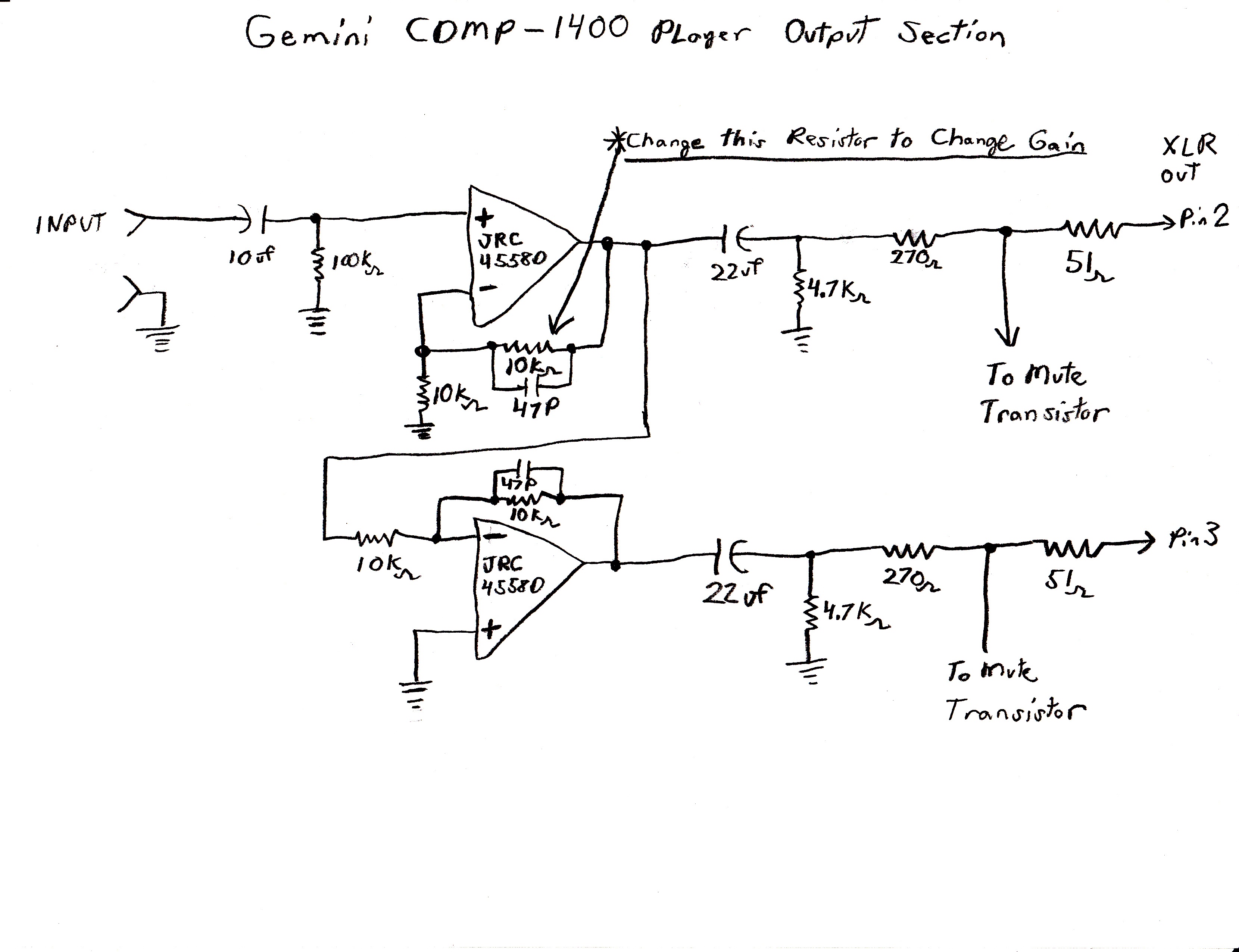

Thanks for your input. This system is a dedicated PA sound system for outdoor pyromusicals. The player will be the only source ever and the outputs will drive QSC amps. The only missmatch I have is with the player. With this applicashoin I think it best to mod the player not the DXC. I could use a level converter but would rather not have another box on a portible system.
Any thoughts on modding the CDMP-1400 player?

Yes of course, depends on the app. Just wanted to give my 2eurocents.
I don't know that player, but a schematic of the post DAC analog part should make it clear if/how that gain can be increased. Do you have any?

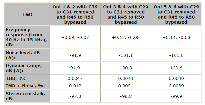

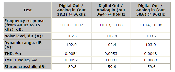

Improve crosstalk on active output mod
Over on the DCX yahoo forum I was discussing strange cross talk measurement result when measuring the DCX2496 (see also request of Jan some posts ago) with the acitve output mod from Jan
As it turns out, the lowered crosstalk is caused by the last low pass filter stage after the DAC (on the active outputboard). This filter stage can be easily removed by removing C29 to C31, and bypassing R45 to R50.
Results without low pass filter removed:
Test</STRONG>Digital Out / Analog in (out 1&2) @ 96kHzDigital Out / Analog in (out 3&4) @ 96kHzDigital Out / Analog in (out 5&6) @ 96kHzFrequency response (from 40 Hz to 15 kHz), dB:+0.10, -0.07+0.13, -0.08+0.14, -0.08Noise level, dB (A):-102.2-102.8-103.2Dynamic range, dB (A):102.0102.4103.0THD, %:0.00540.00530.0048IMD + Noise, %:0.00920.00910.0089Stereo crosstalk, dB:-59.8-59.6-59.6
Results with low pass filter removed:
Test</STRONG>Out 1 & 2 with C29 to C31 removed and R45 to R50 bypassedOut 3 & 4 with C29 to C31 removed and R45 to R50 bypassedOut 5 & 6 with C29 to C31 removed and R45 to R50 bypassedFrequency response (from 40 Hz to 15 kHz), dB:+0.09, -0.07+0.12, -0.08+0.14, -0.08Noise level, dB (A):-91.9-101.1-101.0Dynamic range, dB (A):91.9100.8100.8THD, %:0.00470.00440.0040IMD + Noise, %:0.0120.00910.0089Stereo crosstalk, dB:-97.8-98.8-99.9
This makes stereo image even better. Definitely worth a try!
P.S: don't mind the lower noise rating of out 1 & 2, probably some test wires were picking up some noise.

+/- 12 VDCWhat are the supply voltages to the output opamps?
.15 VRMS into the output Section and .3 VRMS outWhat is your existing maximum Vpk from the player?
+-12Vdc as the supply will limit your maximum peak output voltage to ~10Vpk if the loading is light.
Are you confirming that the peak output voltage of the player is 0.3Vrms ~ 0.424Vpk?
But if 0.3Vrms is an average reading or meter scaled to read out rms from an average then it is not the peak output of the player, unless you feed in a fixed test voltage and adjust the test signal until the output shows signs of clipping.
Andrew; The 0.3 VRMS was measured using pink noise and a DVM. The unit has a Output Level speck of "2.0 +/- 0.2V R.M.S." What ever that means?+-12Vdc as the supply will limit your maximum peak output voltage to ~10Vpk if the loading is light.
But I should be able to get 1.23 VRMS out of it.

Jan; Here is the output Section of the CDMP-1400 player and what I think will change the gain. Andy
Yes that will change the gain. Strange though that you only have .3V or so. It is configured for gain of two and if the DAC is a voltage-out DAC that should be enough for several volts.
You should measure the max output level with a CD with known max level of a sine wave. You can probaby burn one yourself.
