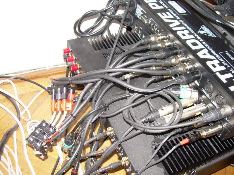

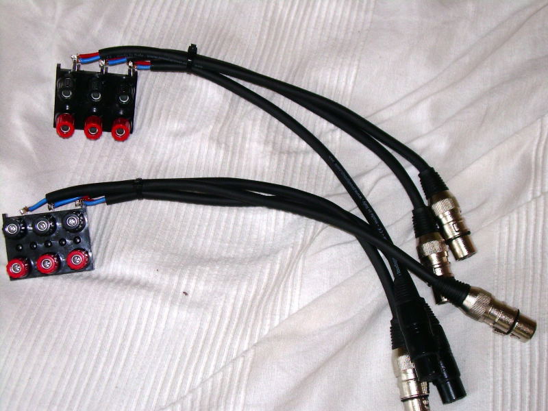

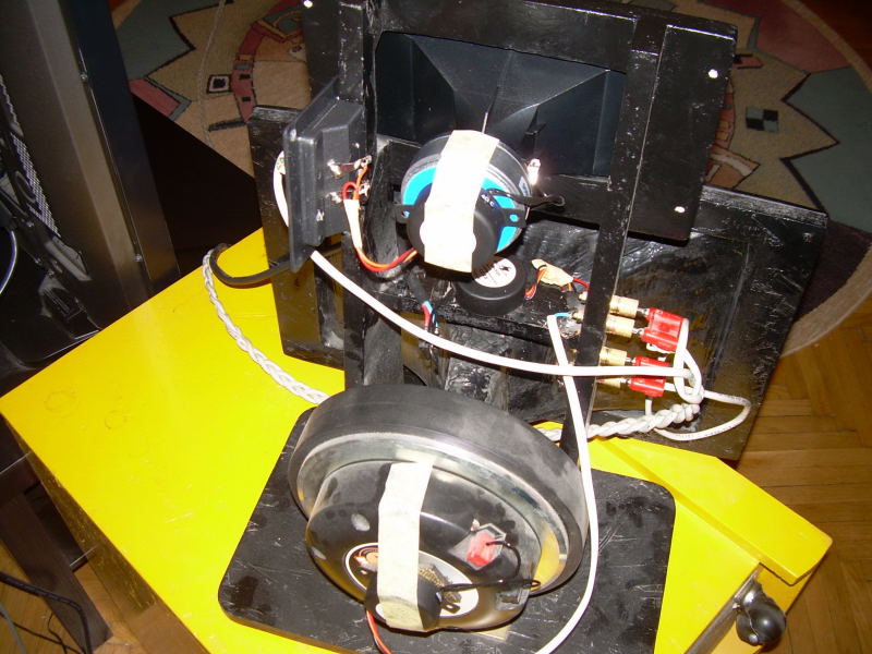

Some results from using 100V trafos with DCX and my horns
As I've promised I show you some results using 100V trafos with my horns (105-110dB@1W/1m) and DCX2494/DEQ2496. From the possible scenarios I tested two:
1. DCX outputs --> poweramps -->trafos --> horns
2. DCX outputs --> trafos --> horns
My system used to be something like this: DCX outputs --> -20/30dB attenuators --> poweramps (-20dB) --> horns and I had trouble with brum and limited volume control to accomodate various digital source levels.
After setting 1. I can take out all resistive attenuators and need only -15dB of amplifier input attenuation to get needed acoustic level in my room. I haven't any kind of noise (brumm etc.) and can accomodate more easily digital source levels using only DEQ2496 digital volume. I am listening symphonic music and I was extremely satisfied with the results.
After that I want to try taking out poweramps and the situation were something similar but I've got some limitation on the treble channel at high volume because these have about -12dB less sensivity. So, I cannot listen to big symphonic works without clipping treble channel and have returned to situation 1.
Meantime I have studied the possibility to change the treble channel (ribbons on horns) and find that Eminence's APT150 is the perfect candidate with phenolic membrane, 90x40 coverage and 105dB. I made the change and now can use either 1 or 2 scenario but choose the more traditional 1 and seems I stay with it from now on.

Yes, these are 100V/2.5w/5W/4ohm transformers; so 22:1 (5W) or 32:1 (2.5W) ratio for tension and 500:1 (5W) or 1000:1 (2.5W) ratio for impedance. I'm using the most expensive ones, toroids, fully shielded, large bandwidth. For my system, DCX and DEQ and 100V trafos aleviate the need for any 6 or 8 channel volume control. For volume duties I'm using the +/-15dB digital volume of the DEQ2496 which stay near 0dB at the prefered listening level. Also, DCX outputs and poweramps are working now at some voltage excursion, more relaxed and out of crossover distorsion zone, not the case before.
Worth to mention that sub-bass channels (<80Hz) are taken from DEQ's analog outputs, follow the same digital volume control like main channels but are not using trafos, just a pair of resistive attenuators.
