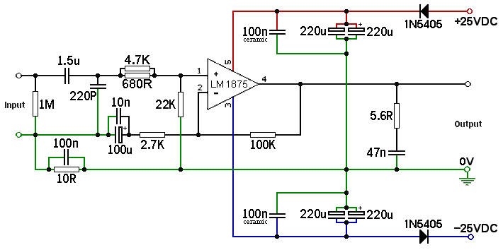

A quick fix for that schematic at Post#539 would be: Change C2, C6 & C7 all to high quality 470uF caps. Or, if board space permits, change C2, C6 & C7 all to 440uF (ordinary 220uF caps used tandem for 440uF at all three locales).
P.S.
That schematic at Post#539 (and in the datasheet) is incomplete and therefore please see the Stability chapter in the LM1875 datasheet.

Hello, what would be input impedance of the amp, using this board:
Is it 1M Ohms?
Worst case 2uA input bias current means about 80mV offset. Typical 200nA input bias current means 8mV offset. Maybe some chips will have significant offset.
One solution would be to solder a 8.2k resistor from the right pin of the 47k to the left pin of the 1.5k, and use about 2200uF for the 330u cap.
the loop AREAs are still enormous.
That is the size of half a business card. The size could be halved again if SMD parts are used to make it smaller than a stamp, such as approximately coin size. Smaller loop area is doable at the cost of having no space for a standard soldering tip to fit.
The 47k is creating an output offset because the +IN & -IN resistances are very different.
Output offset is 3mv~45mv depending on chip manufacturing variance. One may note that a tight input load Reduces output offset. When you're looking at skewed resistor values, then you're looking at a chip amp Rigged to run at slightly higher voltage than it should. It was either that or derate for 40% less output power. That's not a big concern for a TDA7293 because either 70W or even 45W is far too loud inside a normal house. However, cutting off 40% of LM1875's output power might be of greater concern due to clipping distortion--I assumed that was a far too high price to pay for parts value monotony.
Although not assumed to apply for non-inverting amplifiers, a different possibility is that you could be looking at where a buffer should have been used and wasn't.
CM-rejection style input, rarely seen on buffers, never on audio amplifiers, is one of the very few times that symmetrical resistor values are useful. Usually it is more important to balance out the current instead. However, albeit horrendous labor, it is entirely possible to do both at once on an audio amplifier, without adding any more active devices.

I don't have a balanced current LM1875 yet; however, I do have a proposed rough draft for one with both the skewed resistor values and CM-Rejection style input:
(this is the LM1875TurboII with the CM rejection feature hastily pasted on, rather than thoroughly incorporated--the combination is not tested)

The sch in post552 is wrong.
The input components are in the wrong places.

#552

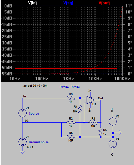

Daniel, you should reference the opamp inputs to a single point. The 10R separating the two will only increases THD.
I don't understand your matching of resistors, as it seems to me that even 1k - 20k does not match 20k - 1k as a voltage divider.
If you are looking to have the same current for each voltage divider then the feedback resistors should be X time larger than the input resistors, where X is the gain.
Example: Gain=21, input 1k-20k and feedback 21k-420k.
Does this make sense? Not very practical I think.
#552 Daniel, you should reference the opamp inputs to a single point. The 10R separating the two will only increases THD.
Thanks for catching that! That schematic was made for the purpose of asking a question. And that question is input noise rejection, like this:
Common mode rejection by BV
Looks like a buffer should be doing that job, because an amp will be less effective by proportion of the gain (so that won't be perfect); however, it still wouldn't miss by much.
