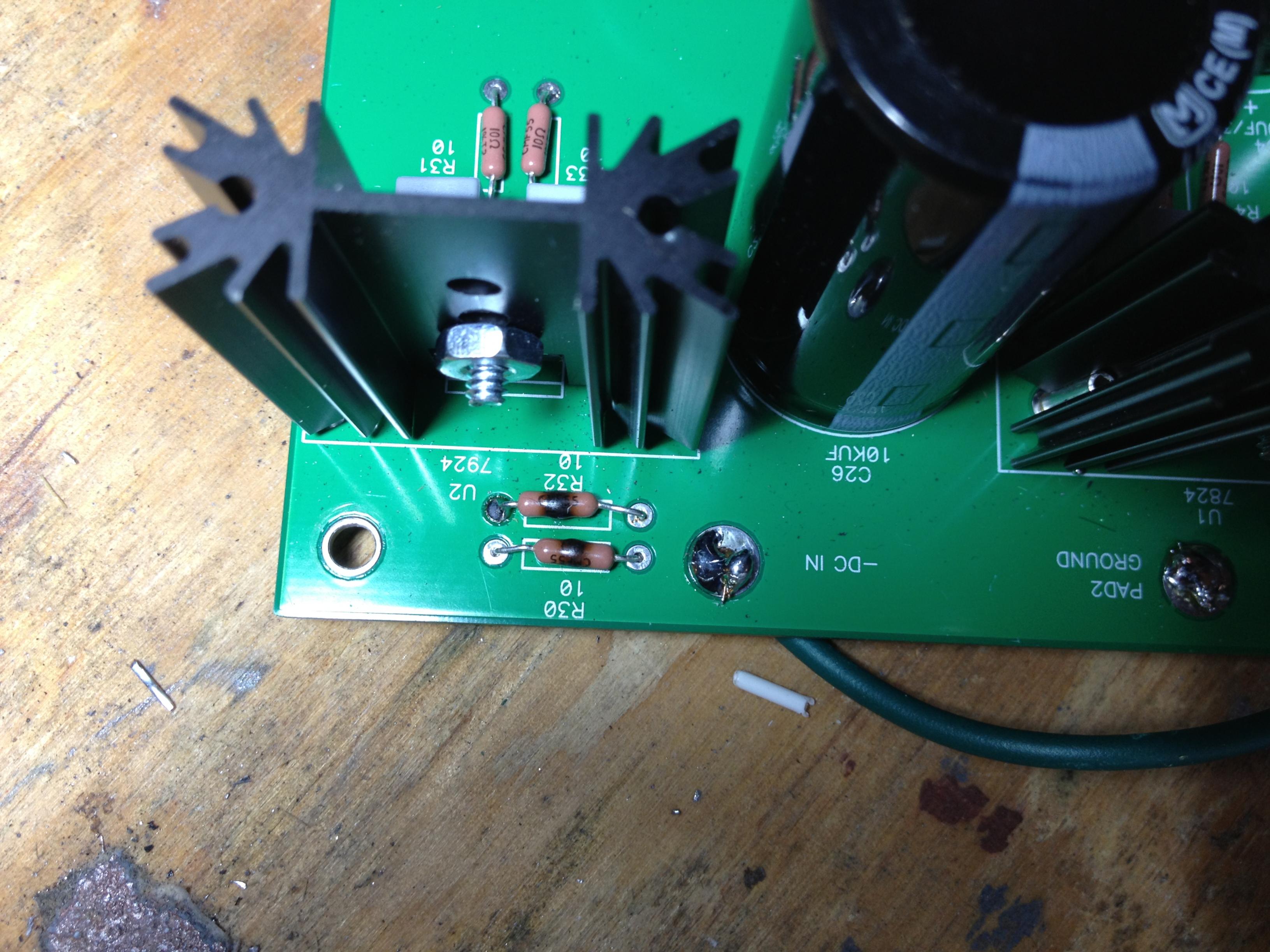

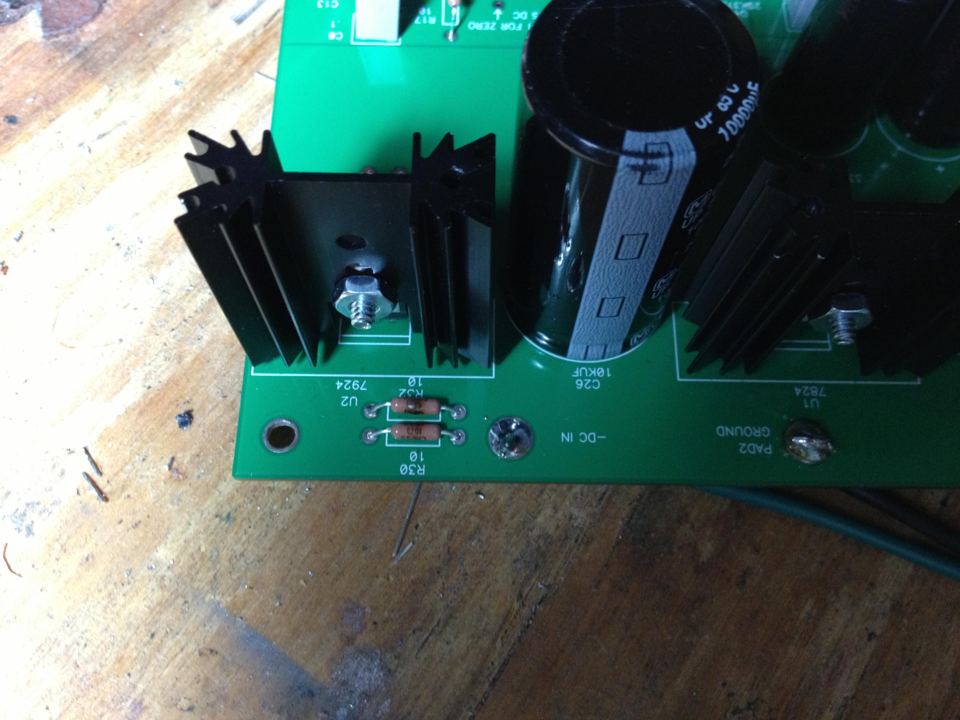

Hooked it up again. Wired as recommended above, started checking voltages. To start wit what I know, I checked past r3 and r4, got just below 24v as expected, did same with r31 and r33, got -24v on one, -31 on the other. This had happened earlier, but I thought I had fixed it when I cleaned up the solder. So I redid the solder around the voltage regulator, hooked it up again. Smoke! Resistors 30 and 32 on both boards smoked and died. I checked the voltage at the jack and it was +-34 as expected. I will replace the resistors, but don't want to just burn up another four. Any ideas?
Time to build the light bulb tester, I suppose...or a bit late.
Here are the pics, not sure what you are looking for. Both boards were plugged in, both sets of resistors fried before the negative voltage regulator fried. No good reason for having both plugged in...
For what itis worth, my guess is that in"fixing" the solder for the regulator I created a short, which caused a surge and fried the resistors. In which case I would need to find out if I killed the regulator/s.

How do R31 and R33 look? Any discoloration? If any, the problem lies to the "audio side" of the schematic.
If only R30 and R32 were toasted, that suggests:
(1) the power supply is working (and you measured the negative voltage rail of the PSU disconnected from the amp boards, and confirmed that, true?)
(2) the problem lies around C26 (polarity installed correctly?) or the regulator U2.
You said R30 and R32 on BOTH channels were toasted? That suggests a parts "installation" problem first (i.e., C26 or U2) pinouts, and more remotely a soldering problem (i.e, unusual to have the same soldering issue on two separate PCBs).
Since R30 and R32 are now toasted, remove them, and measure the resistance from the R30/R32/C26 junction (placing the other meter lead on ground). If it measures zero, or very low, Check c26 and U2 as starting points:
(1). You certain you installed a "negative rail" regulator--they are very similar/identical to positive rail regulators?
(2) Did you ISOLATE the regulator from heatsink and chassis ground, if needed?
I just looked at your pics on Post 29 again. R31 and R33 on the one board I can see look OK.
I'd put my money on your U2 mounting. It might have to be electrically isolated from the heatsink (if the heatsink is grounded). That would entail using a THIN isolating pad (mica), thermal grease, and probably a non-conducting screw (i.e., nylon). I haven't done any other research into the tech sheet for U2, but I suspect that's your culprit..... the regulator tab is grounded via the heatsink.

Yeppers.... I just dug up (the Internet is your friend) a datasheet for a 7924 -24v regulator, in the TO-220 package. The heatsink tab is internally connected to Pin 2 of the regulator, which is the INPUT pin coming from your power supply. Unless your (1) regulator is electrically isolated from the heatsink OR (2) your heatsink is isolated from the PCB ground, you have a DIRECT power supply-to-ground SHORT. I'm not familiar with your PCB, so I'd recommend you mount ALL FOUR regulators to their respective heatsinks using mica pads, thermal grease, and nylon hardware.
Once done, that should get you to your next level of testing. Good luck.
