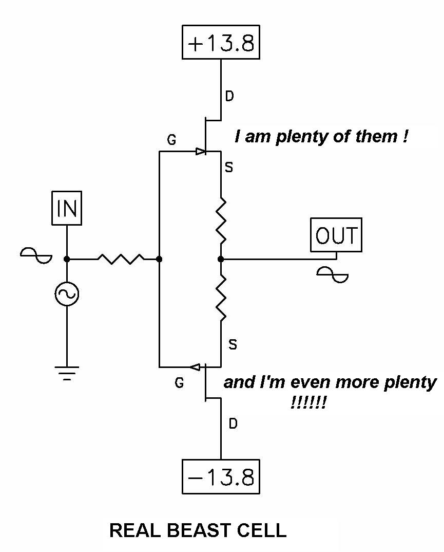

With that out of the way, here is the basic schematic:

"actually 2352" Jfets
say that 2352 goes to two channels
say that each channel is made of two SE bridged ;
say that each SE is made of 2352/2/2 jfets , which means 588/2 = 294 paralleled complementary followers ( I'm lazy to count them on pics)
lets say that each follower cell is biased to conservative 5mA
so each SE is biased with 294 x 5mA=1A47
say that each follower have output impedance of conservative 35 ohms ; divide that with 294 ..... so it have pretty low 0R12
let again say that two SE stages are bridged ; that means 0R24 of output impedance , each half with 1A47 Iq , meaning that peak current can be at least twice that
so - I think power is more than impressive , even if Beast Watt is certainly mucho expensive one
in any case - Beast is fun for Papa and - in same time Demonstration of Brute Force - tossing that number of preputium made Toshibas in a toy , while some other audio manufacturers are not having that number of Jfets to put in regular production
disclaimer - maybe I slipped somewhere with "2" divider , so if I erred , it was in decreasing some value and/or number

I bought some (8) 2SJ74s a while ago just in case I decided to mod the input of my Zen V4. I guess they were cheaper back then. 8 2SK170s are available as well. The rest of the idea should be obvious ;-)
OK, time for some math:
First of all: AFAIK current headphones aren't designed for 120 Ohm sources any more, so I'll just ignore the calculations I just did and calculate that stuff again, without that resistor.
My headphones are:
- Sennheiser HD570 64 Ohm, 102dB@1V, max 100mW
- Sennheiser HD280 64 Ohm, 102dB@1V, max 500mW
- Etymotic HF2 16 Ohm, 105 dB@0.1V, max 120dB
I'll assume the source produces 2 V peak or sqrt(2) V RMS.
Since the "Beast" doesn't have any voltage gain, and neither does my B1, 2 Volts peak or sqrt(2) Volts RMS will be the maximum voltage.
- The 64 Ohm headphones with 102 dB @ 1 Volt* will deliver 105 dB @ sqrt(2) Volts RMS and draw roughly 31 mA (peak) per channel.
- The 16 Ohm in-ears With 105 dB @ 0.1 V* and 120 dB max will produce 120 dB @ ~0.56 V RMS and draw 35 mA (peak) per channel.
At my desk I usually use the closed HD280 and wear ear-plugs underneath, just to get rid of all ambient noise.[special= What the f***?]%[/special]
It's not my preferred option for listening to music, but it's what I (have to) do for now. At least for a couple of hours every day.
105 dB minus 20 (or more) dB due to the earplugs... mh.. I guess 6 dB voltage-gain wouldn't hurt. Especially if I don't want to get in huge trouble when turning on the power amps without checking the volume control on the B1 first ;-)
If I understood the article on the "Beast" correctly, each pair of 2SK170/2SJ74 will deliver 20 mA max, so with just 2 pairs per channel I won't need any voltage gain. If I want any voltage gain, I have to use all 8 SJ74s.
So, before I try to figure out any more details on my own, especially the voltage-gain-stage: Could this actually work?

ZM,
The Szekeres headphone amp is a mosfet follower buffer. With my Sennheiser 595's, about the same efficiency, I run it about 8 o'clock for normal listening. Seems like a buffer would normally be fine, but adding ear plugs to the mix could be an issue.

yes if you are doomed to put something inside your ears anyway, why not use earphones(buds) with a noise supressing headset. this way you would not need voltage gain.
by the way i built a beast of 20 jfets (roaoarrr), or 10 parallel buffers, for phones(senn 52 ohms) and in my experience, the more jfets the better. It sounds supremely transparent this way but had i more fets i d double that number, at least.
2V for headphones this sensible is already loud, at least on my hd 570, why dont you try it first? it s the simplest circuit i know of
