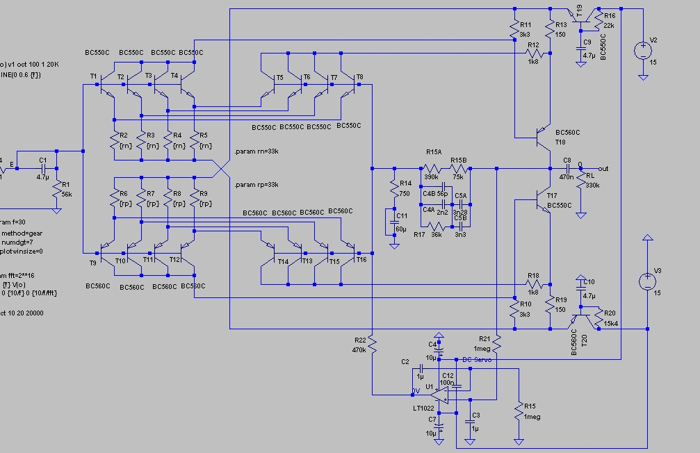

As this is the time to play, I decided to see what happened if I added a DC Servo to the simulation, and the results seem quite promising.
Run the included file and look at THD, both at 1K and 20K.
If the simulation is right, the results are amazing.

Hi carlmart.
That looks very good.
With the servo you can omit the resistors PP and PN (= 0 ohms).
Why extra power supply for the servo? I ran the simulation with same supply for all, it makes no difference.
My PCBs are already done. But one could perhaps put a small piggyback board with the servo on them.

Of course you're right about not using a separate supply for the servo.
But I was thinking of using a Jung style supply for the main power and a separate one for the servo.
Yes, it's very easy to assemble a prototype piggy-back for testing the servo with actual audio, and see what changes. Eliminating the input and feedback caps could bring big improvements. But this have to be listened to.

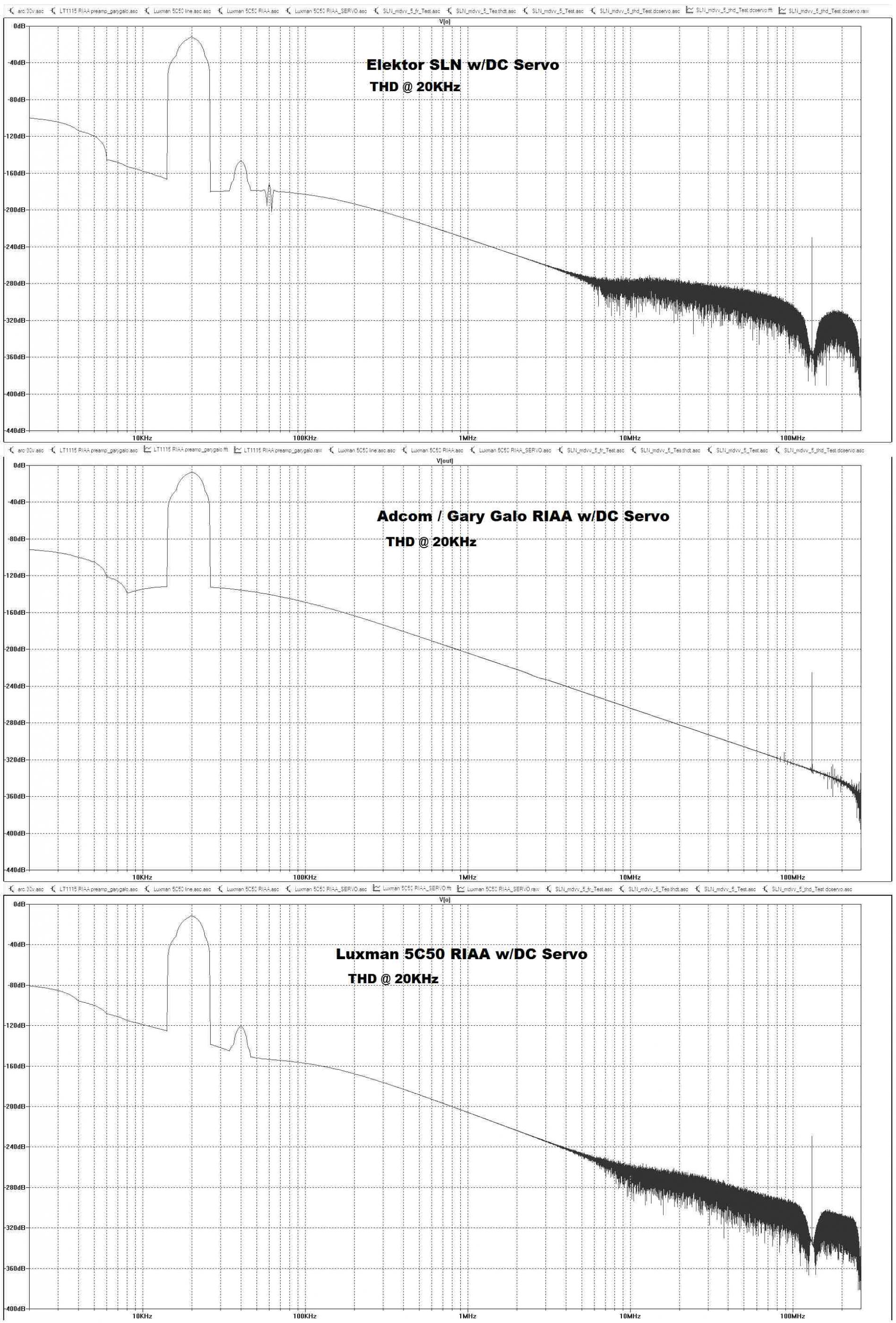

I'm not sure I can show those designs here, because of copyright reasons, and also because it would mean taking the focus off the SLN project.
But here are the three asc sims that can be run on LTSpice.
The SLN sim, set for 30Hz does show a great increase on the THD figure, even if that doesn't show to be so serious on the curve, which still looks quite good.

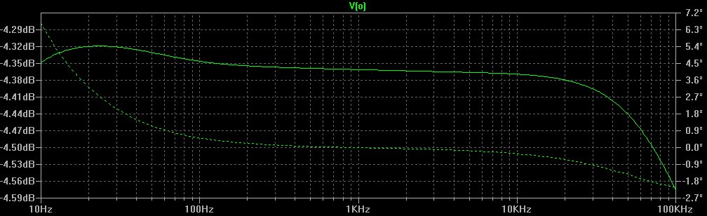

screen copy for those who can't use .asc-files: (modified SLN/Supra1)
Circuit & simulated frequency response with reverse-RIAA input signal.
OK, the servo is slow enough not to shift poles significantly. Great!
