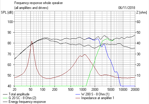

The theory of filters says we use the low-distortion Linkwitz-Riley solution, which can be 12 or 24dB/octave and a -6dB crossover point:
715080d1542008118-restoring-monitor-audio-r300-bookshelf-speakers-steen-duelund-1-414-root-2-png
In the real world it doesn't work so well:
599660d1487267698-restoring-monitor-audio-r300-bookshelf-speakers-monitor-audio-r300-md-resurrected-cabinet.jpg
714065d1541548033-restoring-monitor-audio-r300-bookshelf-speakers-ma-r300-md-4th-fr-png
See the curve marked Energy-Frequency response? Big dip near crossover where the 8" bass becomes highly directional? This makes the tweeter sound too bright, recesses voices and generally becomes a mess.

In the above graph system7, the dip you refer to must be that 2dB trough at 2.8kHz, and I would doubt that that is significant. 100 to 20k +/- 3dB seems pretty good to me.

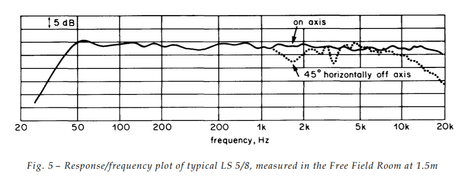

As someone who used to mix on various BBC monitors too many years ago, my understanding is that the "BBC dip" is simply a directivity mismatch between the woofer and the tweeter. Since the monitor(s) were designed for flat on-axis response, the off axis response shows the dip:
attachment.php
Ref:
http://downloads.bbc.co.uk/rd/pubs/reports/1979-22.pdf
http://downloads.bbc.co.uk/rd/pubs/reports/1983-10.pdf
From Sean Olive on the subject: "Many poorly designed 2-way loudspeakers already have dips in the sound power response in the cross-over range 1-3 kHz where the directivity of the woofer is too high compared to the directivity of the tweeter at those frequencies. As a result, this produces a notch in the sound power response of the loudspeaker, usually followed by a peak. Depending on the bandwidth and depth of the notch, it is the peak that is often heard as sounding objectionable (harshness, hardness or excessive brightness)."
Personally, I did not like the dip for mixing if the monitors were not pointed directly on axis to my ears as one would compensate for the hole in the response, in the mix. Then listening to the mix on loudspeakers with no off axis dip made the mix really bright in our ears most sensitive hearing range.

Folks, the so called BBC dip is simply due to a directivity mismatch between the woofer and tweeter as these speakers were optimised for flat on axis amplitude response which resulted in the dip off axis. In other words, it is a design flaw.
Newer research involving Floyd Toole's "spinorama" objective speaker measurement process and Sean Olive's subjective listener preferences shows that smooth off axis response is just as important as smooth on axis response.
