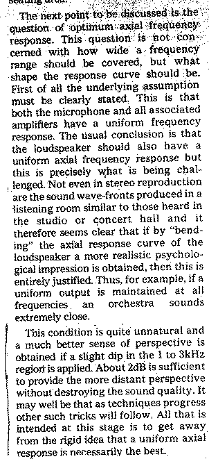

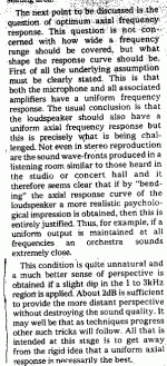

found this lurking on the internet

well I have read enough references to a 1-3kHz dip giving an enhanced sense of depth, from Broskie to Linkwitz that suggests the illusion it gives is real. However Sreten is probably right that in some designs its there for other reasons. Certainly my apogees have the dip in the crossover.
Of course it could be an old wives tale that has become accepted ignorance!
Sreten likes to make up stories based on his POV. On another occasion he claimed the so called BBC dip was in fact a peak at the upper HF end, I tried to wrestle with him on this claimed story and he said he knows it b/c he's British. You can study the LS3/5A history and all the different driver suppliers and then look at its xover schematics early revisions (note all the level taps), I figure depending on which years production sample an audio reviewer had their mits on, every version likely had their own sonic signature (maybe like a 'vintage' series). It's probably just another Myth still making the rounds via the internets.
