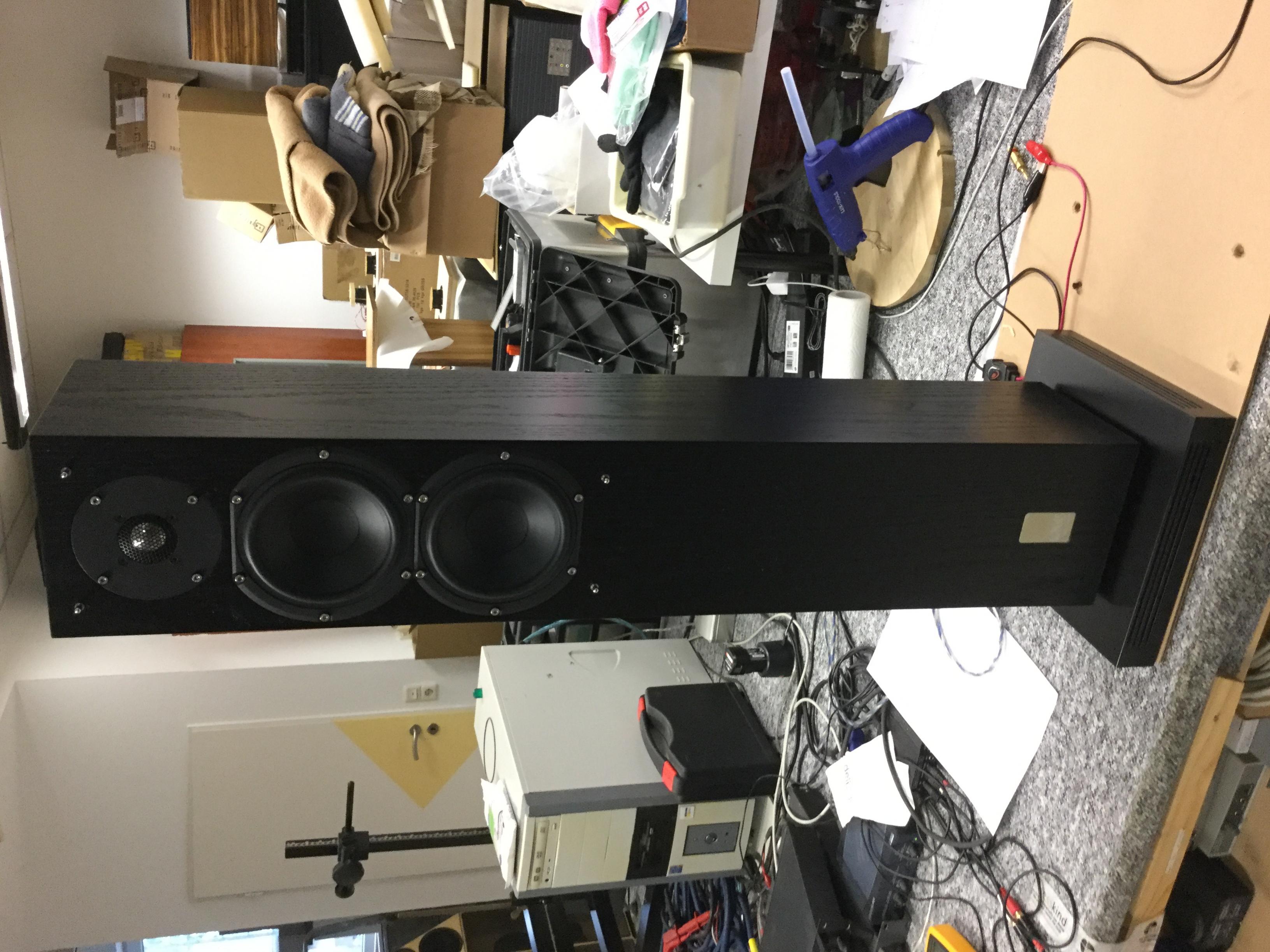

Even Joachim Gerhard likes this idea with the Sonics Oumnia 2.0, even if he can be a bit "off the wall" sometimes:
694322d1532943393t-sonics-joachim-gerhard-cabinets-kits-79dbd51f-a82b-4503-bce9-4881243cd5d5-jpg
But who we kidding, it's 3 way or no-way if cost is no object!

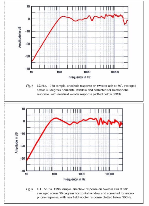

FWIW. Here are measured responses (listening window) of a 1978 Rogers LS3/5a and a 1996 KEF LS3/5a. Jeff Bagby used the Rogers’ response as a target FR when he designed his LS3/5a clone called the Continuum. The second is the Rogers response compared to the Continuum response.

Slopes are another philosophical idea; different from the dip idea.
PMC does seems to follow flat philosophy.
IMO the home is generally better damped than many studios, especially for HF.
There is evidence, (Toole) that peaks are far more intrusive than troughs, perhaps unsurprisingly.
The first graph is not too bad compared with many I have seen, but I don't see what you mean by "shouting".
The second is rather good.
