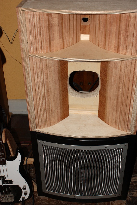

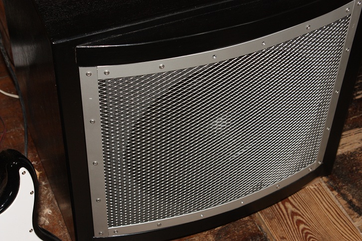

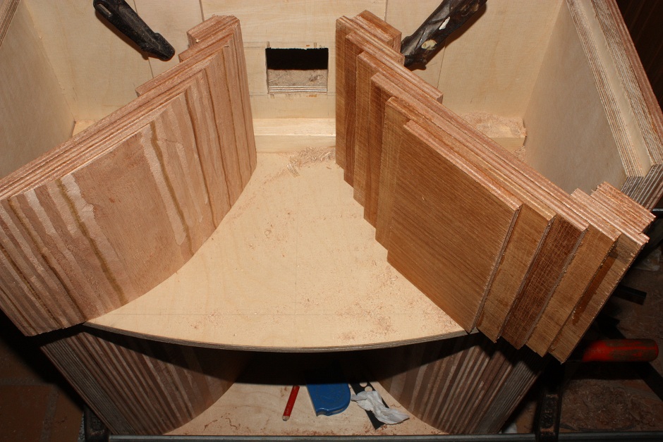

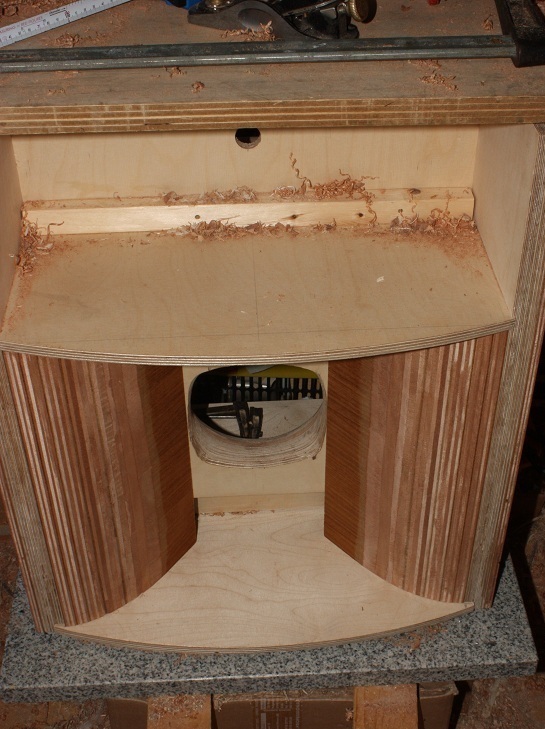

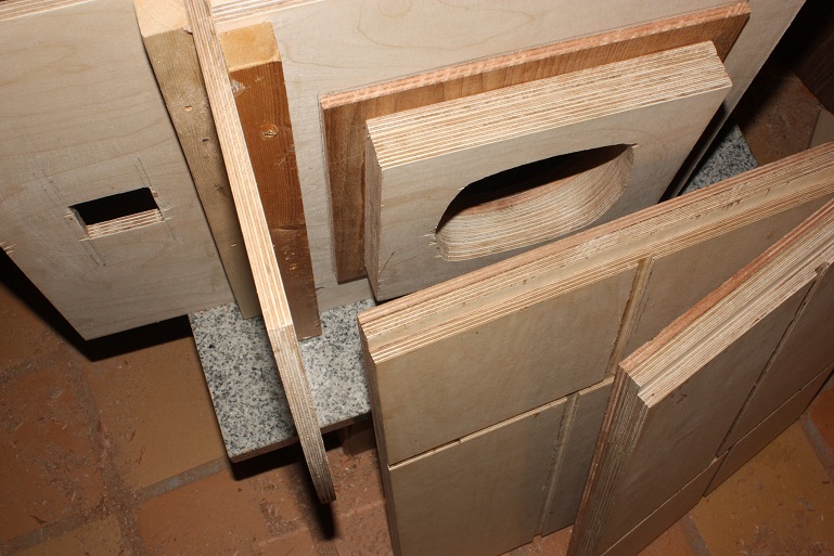

Will you add something that it will flare vertically as well ?
yes
and because of the curved front, it needs the same special care
my arms are getting tired :eek:

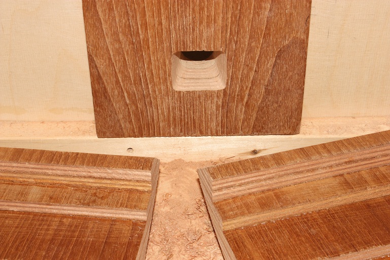

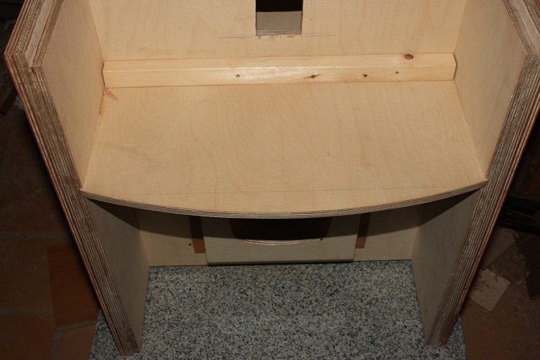

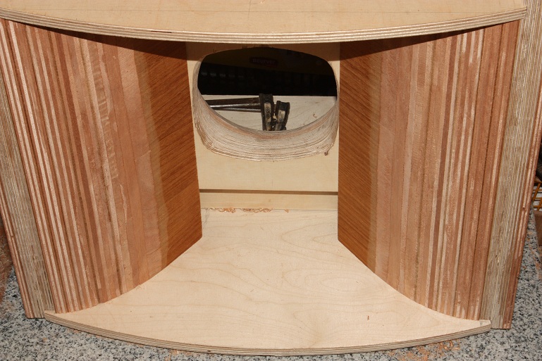

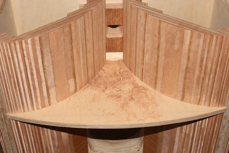

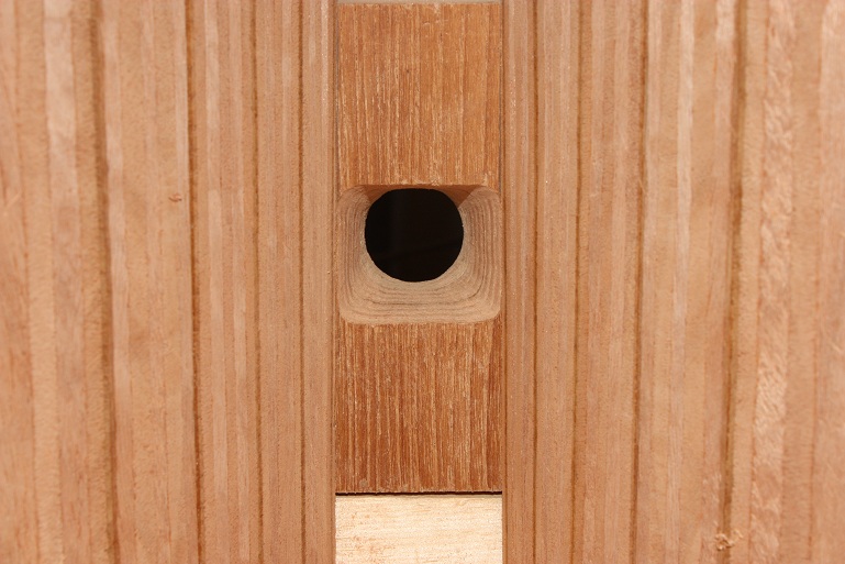

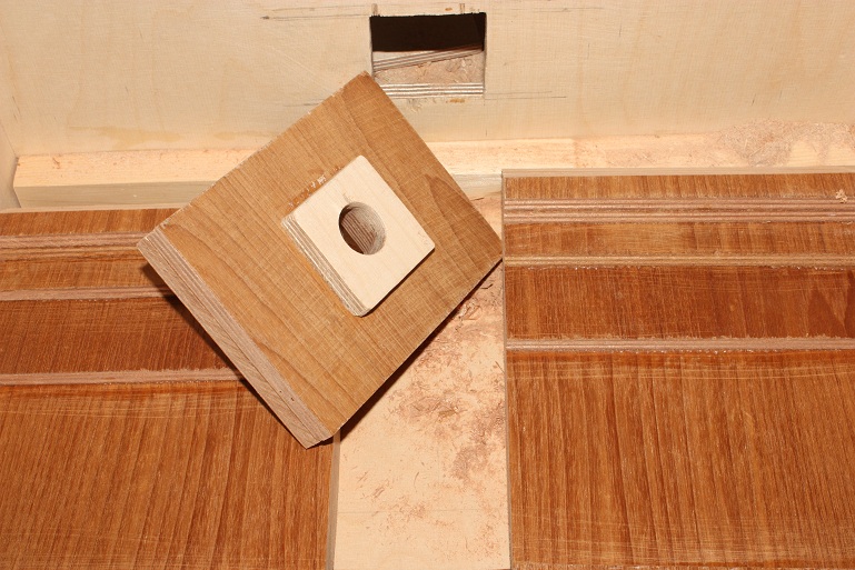

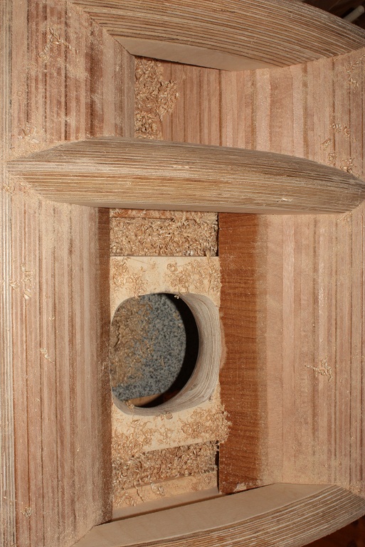

pics of the midrange round to angular conversion throat
seems I was lucky once again :D
thanks
cant wait to see it together with the woofer
well, maybe Im overdoing it
but I always wanted to do this
Anything worth doing is worth overdoing!
