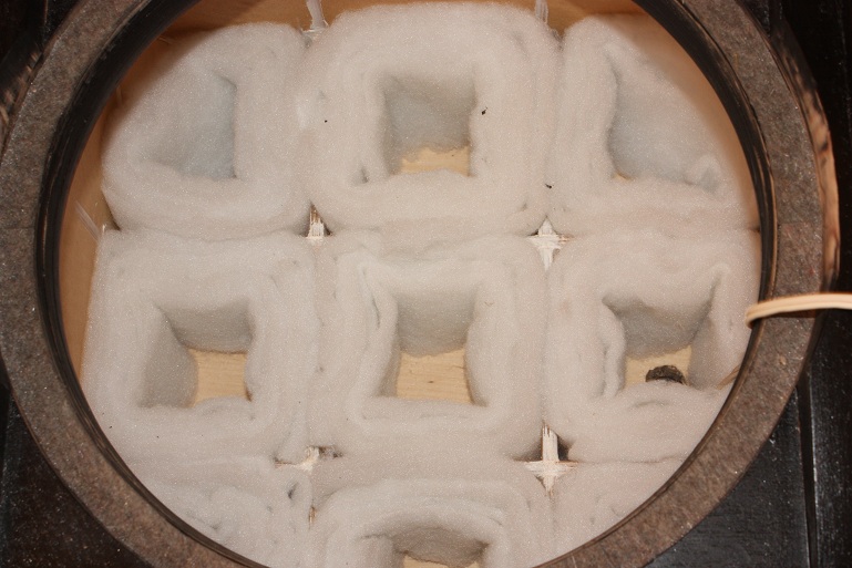

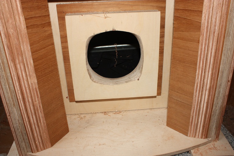

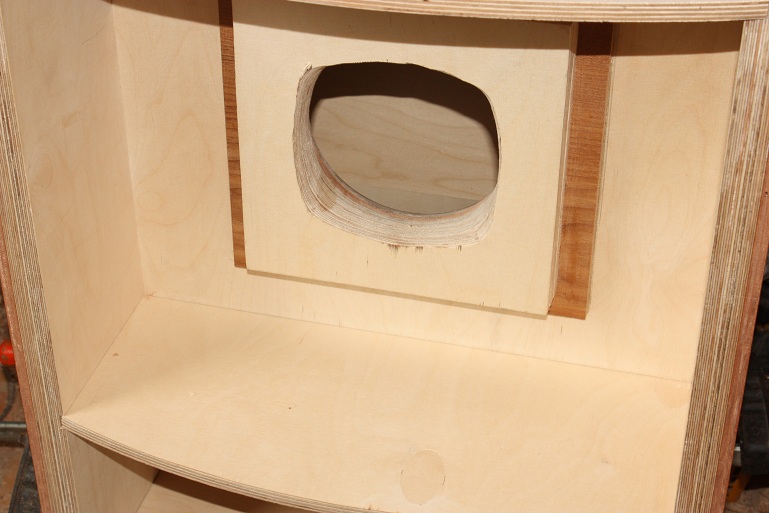

I know I have shown this photo before
but it still shows a very remarkable thing
notice the empty holes in the acoustic material
I did that to loosen it up
I said I lacked top end, but liked the low end, which was very smooth with nicely prolonges sustain
loosening it up gave me back some of the top end, but the low end became more 'spunky', and less smooth
now I have filled in the holes with very loose acoustic material, like the other used
I now have much better top end
and I got the tighter and smooth low end sustain back
its really remarkable how little it takes to make a difference

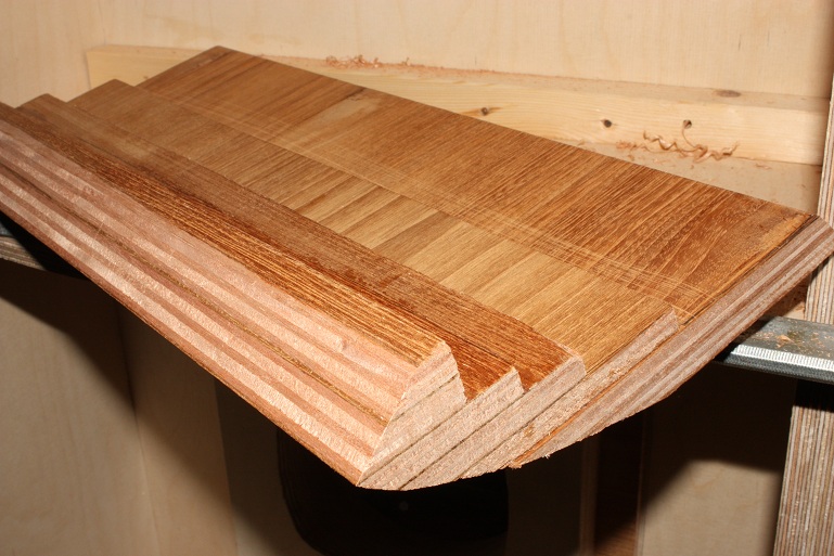

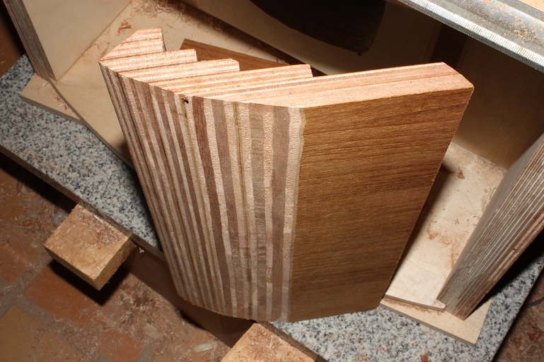

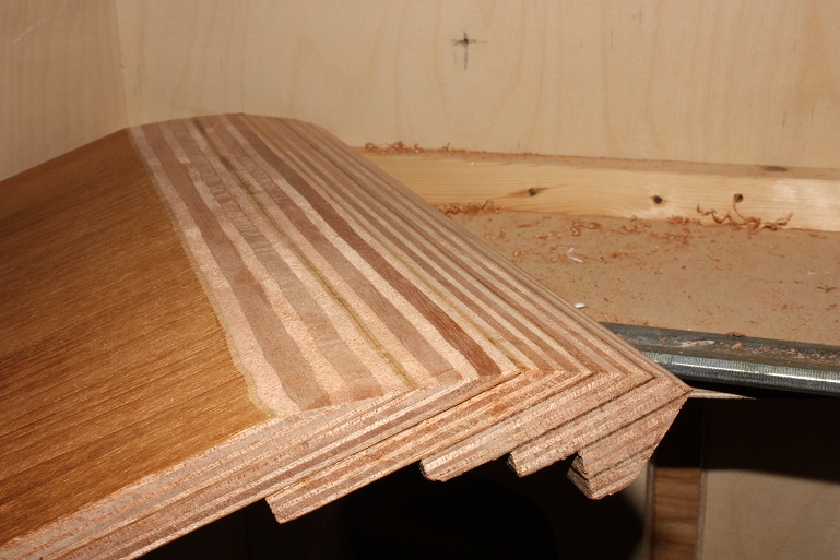

Looks good so far.
If you want a nice, smooth transition, here's an idea...
Fill the space with cardboard, layered up so it completely fills the front of the horn.
Take a sharp knife, and cut away until you have the correct horn profile, then cover it with wood (or other) filler. You know, the stuff that sets hard but you can still sand down to a nice matte finish.
Chris
Chris

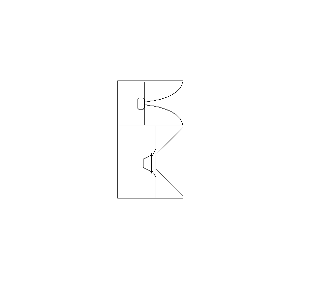

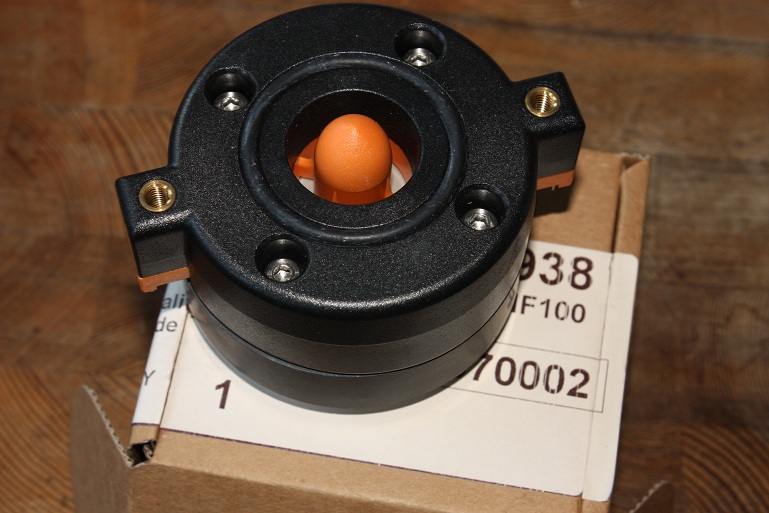

well, this cheap compression driver really makes the Palmer Pocket amp sing
some the special guitarist effect seettings now works much much better
and it sounds much better in tune
btw, I should mention that its an old model CD
but it was really cheap
actually half the cost was shipping
so yeah, I feel 100% confident that my design will sing
and I guess it won't hurt that it will be a fullfunctional PA or party speaker
with another top section you would have a full stereo with sub
but that will be another project, some other time
for now, I'm really glad that I only need to build one of each

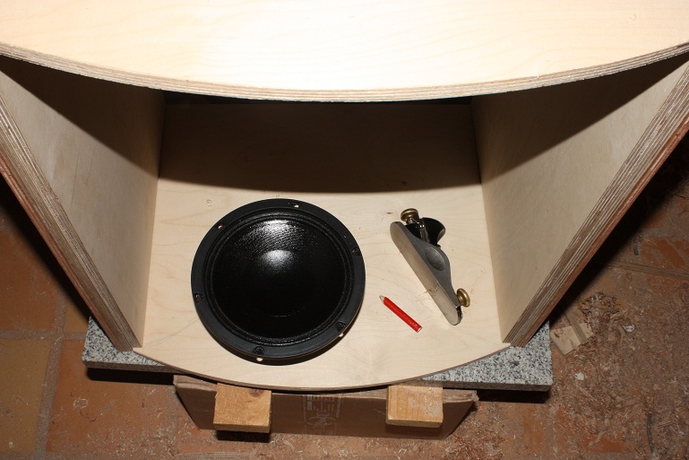

I am a bit excited to hear it with the 8" midwoofer
