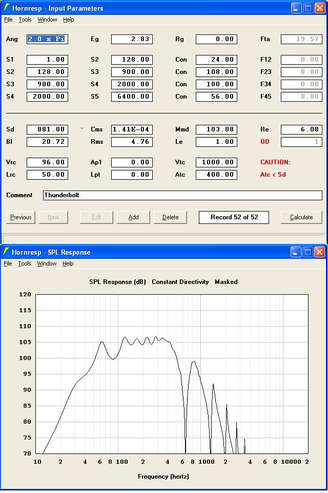

To answer your question requires a little reverse engineering of a 1975 horn. I did a 'VERY' rough guess at some of the hornresp parameters, and also guessed you are using the kappa 15LFA. (or is it the kappa 15a)
Regardless it looks like it is very well behaved up to the 500hz cutoff where it was crossed to a multicell compression driver. I would definitely put a crossover on it, as you'll get some stuff above 500hz that you really don't want. You'll also want to highpass this at 40hz.
Don't take the below 100hz too seriously, until there is some refinement to the hornresp parameters. (and actually have the correct driver info, if I guessed wrong)
This should be very interesting in your house... (guessing in house since you are not using plywood??? man that's gotta be heavy.) It's big, and for a 1975 design, I'm suitably impressed. Let's see pics when it's complete.

Thanks for the reply (ive not been checking back all day, i promise). I think ill have a bash at making my own x-over for this box. It is actually made out of chipboard, cheap and cheerful, i am getting a price on MDF/Ply tomorrow and im going to make a decision on what to use for the next one.
The box its self is very efficient (apparently i wouldnt know) How did you calculate all of that technical wizardy in the attached thumbnail might i ask? Is there such thing as a piece of software where you can enter the size/design of your box (cad style) and it will tell you how efficient/what frequencies you can expect from the box.

Hornresp
HORNRESP.... It will model anything you want, and it's free.
It's awesome, and I take my hat off to David. Thanks for such a great piece of software.
Once you get the horn parameters set to accurately reflect what you are building, you can substitute one driver for another, and see exactly what to expect.
Keep in mind everything is in metric. (cm or cm2)
Search for some of the great hornresp tutorials, or even use the very helpful F1 help feature.

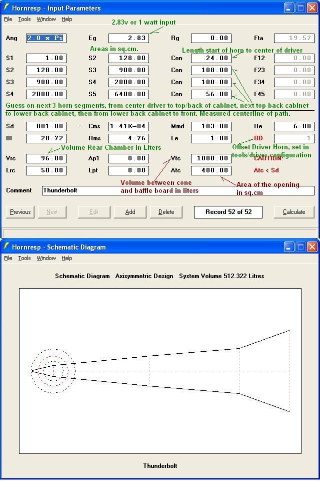

I thought I'd doctor up a hornresp input screen, to help make sense of things since the thunderbolt is an 'offset driver' front loaded horn. I did some guessing on lengths and areas that are 'not exactly' right, but close. It should be enough that you can fill in the actual lengths and areas and have a good model of this horn. (edit on image: vtc, 1000 = 1 liter, vrc 98 = 98 liters)
Once the model is right, you can change the input voltage, calculate spl, and always check the displacement, to find out when your driver runs out of gas and at what frequency.

Hi jbell,
Nice work on the Hornresp Input. There is one area you could refine: the Atc should be the area inside the mounting ring of the driver, and Ap1 should be set to equal S2, then Lpt becomes the thickness of the mounting board. Also, the flare rate should be set to Par. It should make little difference in the SPL output.
Okay so your Hornsrep looks different mine, if you look at my screenshot
Where you have entered all of the different Flar lengths (Con) i have different boxes? Can you shed any light on this please?
Also am i right in which i think are the different CON measurements
Please forgive my caveman style illustration :)
Black line = CON (1)
Blue line = CON (2)
Yellow line = CON (3)
Brown line = CON (4)
