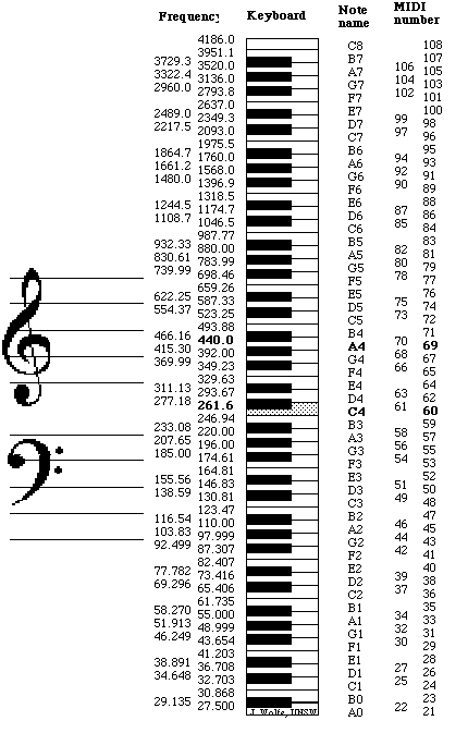

This is for standard guitar, the standard tunings...the picture might help too...
FREQ PIANO STRING/FRET
