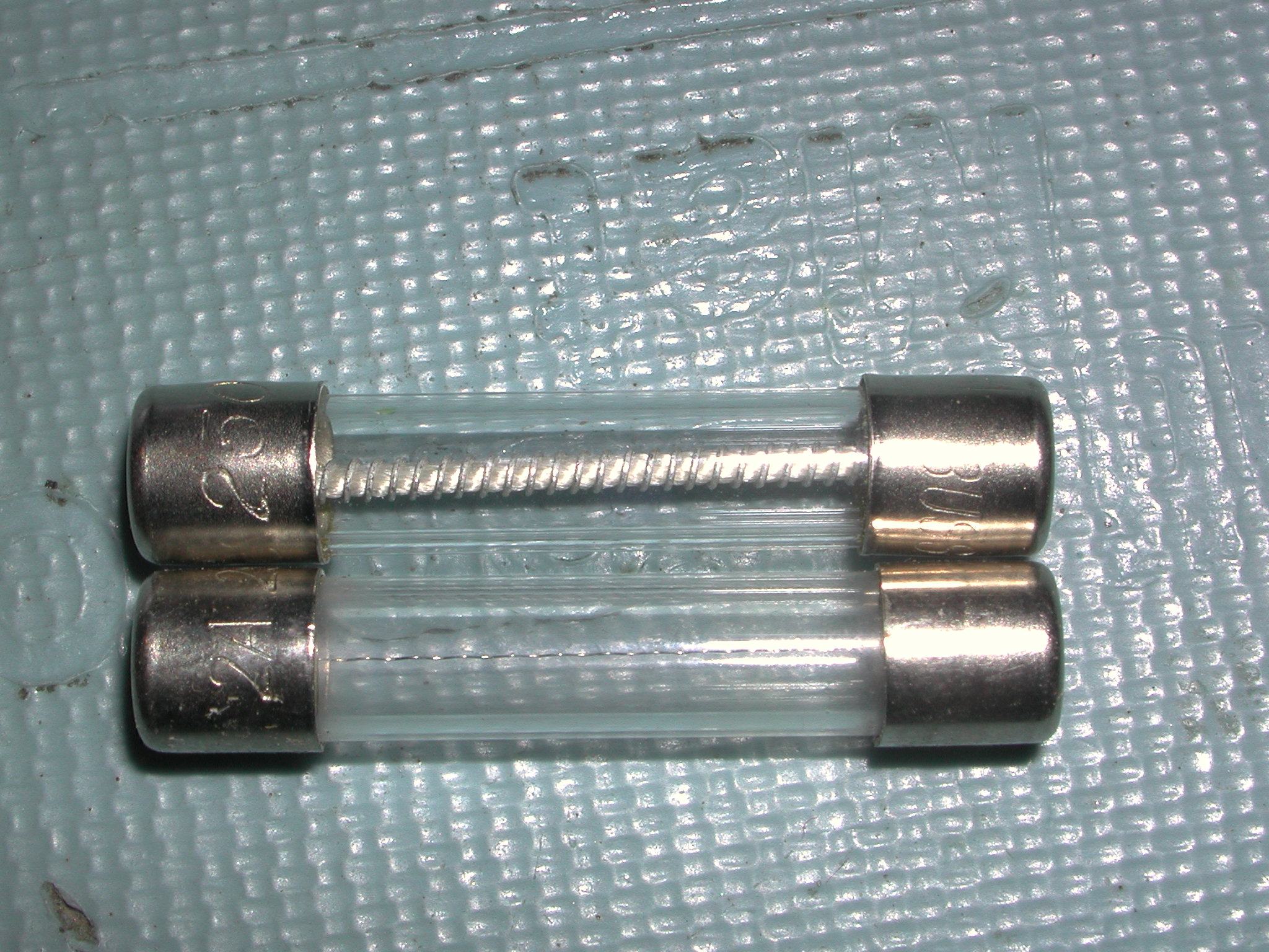

Please also let us know what you are using for a fuse, to eliminate other possibilities.
The fuse I used is 3.15A/250V . It was something I found in my house. It was written as T3.15A/250V so I dont know if its slow-bow or fast
IIRC, the recommended fuse is a slow blow 1A-1.5A or so.
That's a little big.......don't go any larger or you'll risk damaging components.
If it's a fast blow, it will just have a metal filament. Slow blows have the filament wire wrapped around some kind of insulator.
The fuse on the top is a slow blow; the one on the bottom is a fast blow.
Well, the safe thing to do is buy smaller slo-blo fuses...
What I have now are fast bo fuses. I am using 240V so I will buy lower amp fuses.

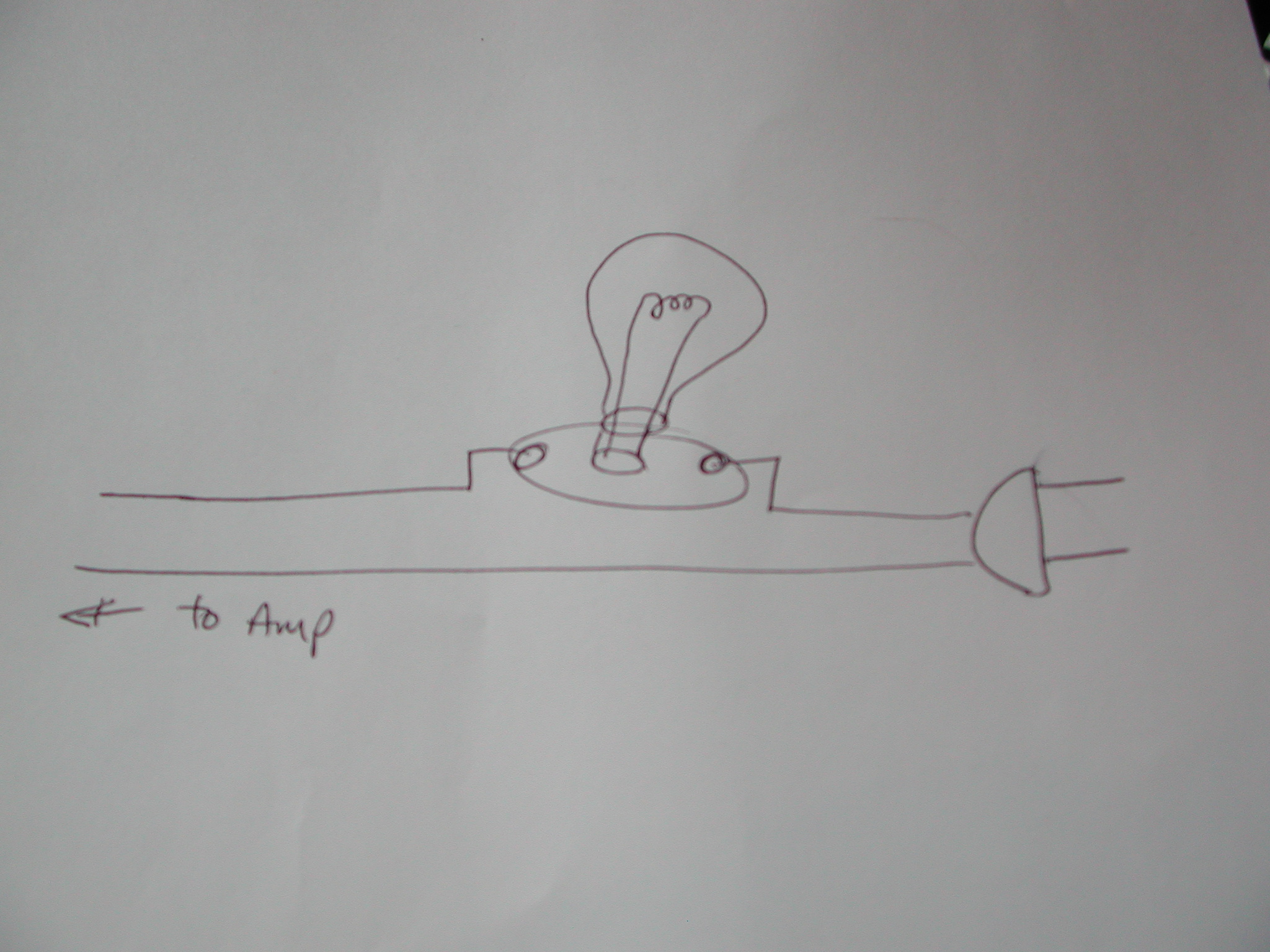

Are you familiar with the light bulb trick for getting an amp running? You take an old power cord, and wire plain old incandescent light bulb in series with one conductor of the cord, and use this cord to get the amp running. If your amp is working normally, the bulb will be very dim since the amp won't be pulling excessive current. If the amp has a short (as yours presently does) it will glow brightly. This does several good things; it's drops voltage during a short condition to help save things downstream like fuses and amp parts, and allows you to see instantly that you have a problem (if the bulb glows bright) and yank the plug.
At this point, I would disconnect all of the transformer secondary wires going to the board, tape them off and power up the transformer. If the fuse blows then, you either have a wiring problem going into the transformer on the mains side or a problem with the transformer.
