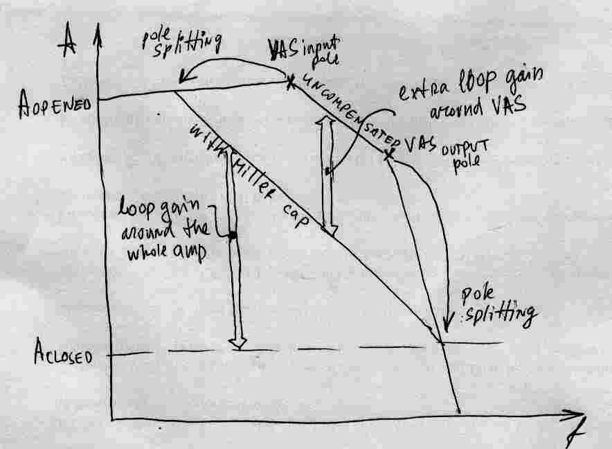

The output impedance of a VAS with miller capacitor is inversely proportional to the frequency due to C-B feedback. Even if you remove miller capacitor, the output impedance will be still inversely proportional to the frequency due to internal transistor miller capacitances and charge storage effects. Note that this output impedance may be very high for bass or midrange frequencies but it becomes low at RF (and this is desirable from my point of view).
Also, the input impedance of the output stage tends to be inversely proportional to the frequency due to miller capacitances, adding or not miller capacitors, and due to B-E capacitance and charge storage effects. At bass and midrange frequencies this input impedance tends to be just the speaker impedance multiplied by the beta of the output devices and drivers, but junction capacitances dominate at RF.

The VAS does not like a too capacitive load because it has local feedback and it has a phase margin to mantain at high frequencies. Capacitive load reduces phase margin of that local feedback loop. A too much capacitive load impedance may also make an emitter follower oscillate due to interaction with the internal behaviour of the bipolar transistor (charge storage phenomena and propagation times).
Concerning base stoppers and phase margin degradation, I forgot to mention that increasing the impedance seen by the bases of the input LTP also degrades global loop phase margin (in much the same way as base stoppers do), so driving the input stage from low value resistors is desirable, at least in the inverting input (ie: 9k1 and 1k instead of 91K and 10K).

There is a good post by Dimitri, about first pole and second pole.
http://www.diyaudio.com/forums/showthread.php?postid=128238#post128238
a=emitor degeneration in VAS
b=miller compensation C-B in VAS
c=resistor between C-B in VAS
Dear capslock,
first pole time constant is (VAS input resistance)*(Cbc VAS)*(VAS gain)
second pole time constant is (output stage input resistance)*(C associated with VAS output node)
in your cases a) and c) the second pole time constant will remain unchanged and you should make much higher first pole time constant to move second pole below unity loop gain. Only in case b) you will get the second pole time constant lower (then original one) due to NFB via Miller capacitor. With higher frequency second pole you can use not so low the dominant one.
another nonlinearity is associated with VAS output node - nonlinear input current of the output stage. To makes this nonlinearity lower you should keep VAS output resistance low - again by Miller compensation. Here the advantage over c) will be that the VAS output resistance will be lower with frequency, that helps to keep associated disto at low level (please keep in mind that the overall loop gain is lower with frequency)
so for the discussed topology LTP-VAS-output stage b) is superior
He said that second pole is
I calculate, with addition of Miller cap, the second pole time constant is bigger (ie=lower frequency), but why he wrote :
With miller cap around VAS, the "(C associated with VAS output node) is decreasing or increasing? What am I missing?
