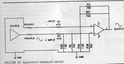

Re: Re: Re: HUmmm
Why wouldn't the ground conductor carry the same interference/noise as the signal conductor? If the ground conductor of the unbalanced interconnect is attached to the negative input of the amp, I think you are still in business when the signals are summed.

Re: Re: Re: Re: HUmmm
They're not summed, they're differentiated.
And unless each line has the same impedance with respect to ground, then the voltage across it will not be the same and when the two lines are differentiated, the difference of the voltages across each line will not be rejected but amplified.

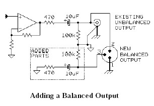

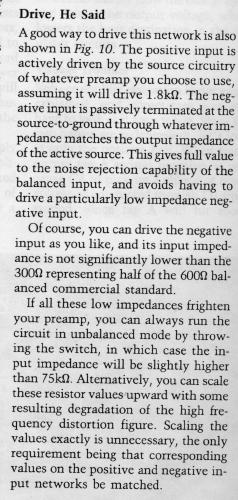

I'm soooo confused......
I just don't get it. I'll accept your statement that your passive implementation of your 'balanced' output circut will present a balaced impedence to a balanaced input circut, and externally imposed noise will indeed be common mode.... but your contention that one will have a balaced signal eludes me.
As I see it from my naive perspective, we have the positive signal, the output from the opamp passing through a voltage divider going to ground. We also have a mirror image of that voltage divider, originating at the ground leg of that op amp circut, going trough a series resistor (same value as the series resitor from the + opamp output), and shunted ( with the same value as its mirror shunt) to that 'signal' ground, i.e. we've got a voltage divider starting at ground and ending at ground.... so how the heck does a voltage divider starting at ground and ending at ground, have anything but ground at the midpoint of a 2 resistor voltage divider. I will admit its been 35+ years since I leaned Kirshoff's Law, but has it changed in the meantime? I'm not disputing that this termination does provide benefits in interfacing to a true balanced termination with regards to noise rejection (common mode rejection requiring equal impedences), but you previous contention that this will provide a balanced signal still eludes me.
Re: I'm soooo confused......
It eludes you because I didn't make such a contention.
As I said previously, "balanced" only refers to the impedances of the two lines with respect to ground. Whether the lines are balanced or unbalanced, the <b>signal</b> exits differentially between the two lines.
Now if you're referring to my having mentioned bipolar signals, i.e. +v and -v, that's easy enough to explain. You just seem to be looking at it from a different perspective than I am.
As far as I'm concerned, "signal" only matters at the receiving end, and that's the perspective I'm looking at it from. In other words, I'm looking at what the balanced, differential input at the receiving end "sees."
It perhaps wasn't quite so obvious from the last schematic I posted so let me simplify it it a bit on the receiving end:

Does that make it a bit more clear?

The following is from http://www.jensen-transformers.com/an/an003.pdf
I see a difference between this drawing and your drawing--the capacitors.
Do you think the capacitors are not important?

Nope....
I still don't get it.
.It eludes you because I didn't make such a contention.
Stuff and nonsense....
If you converted to a balanced output using the passive solution, you'd measure +0.5 volts on the + line and -0.5 volts on the - line.
You certainly did make such a contention. And if you wish to rationalize that comment by stating that it is only valid on the recieving end for a truly balanced input , I'll grant you that.
But please realize some folks might actually accept your statements without that obligatory grain of salt and backpedaling. Used as a phase inverter, with a dpdt switch, it will simply provide useless common mode noise to a single ended input as others, far more compentent the me, have pointed out.

jh6you said:The following is from http://www.jensen-transformers.com/an/an003.pdf
The capacitors are there simply because that's how Bill chose to represent a "typical unbalanced output." If the unbalanced output you're wanting to convert to balanced is DC coupled (i.e. uses no series output capacitors) then there's no reason to add any capacitors. If it's AC coupled, the example only serves to show that you need to mirror them on the other side of the circuit.
