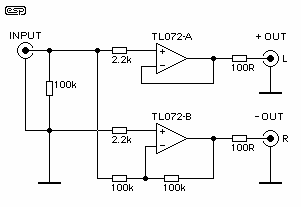

I've just built a BLD using DRV134s. (The only difference in my layout compared to digi01's is that I'm running them from +/-12V rather than +/-15V, and have included the optional 10uF NP caps).
My problem is that the +Vout and -Vout signals are in phase. Since the purpose is to drive power amps with differential balanced inputs, this isn't good - the result is silence, of course!
Does anyone here know of any circumstance that would cause the DRV134's outputs to be in phase? Or have I just misunderstood what this chip is supposed to do? (I have previously successfully built BLDs using AD SSM2142s, but they are now hard to source and the DRV134 is reputed to be better).
Thanks,
Clive

Sorry - my error
Please disregard my previous post.
I've done some more testing and the signals ARE out of phase, as should be expected. I am using a software 'scope, and was also using the PC as a signal generator. It seems that the 'scope must have been picking up the generated signal instead of the output of the line driver. Once I dragged in a second PC to act as signal generator, I discovered that the output is as it should be. My apologies to everyone. First post, too: how embarrassing

I noticed that this Design is exactly the same as the Applications information in the DRV134 datasheet...so this isn"t an original and new design but one that does work quite well...
The DRV134 is an OK Ballanced Line driver but the Chip costs allmost $5 and you can Make one that performs just as well out of a NE5532 or a TL072 (or allmost an Inverting Dual opamp)at 1/4 the cost and in Non-Inverting mode you can even make one with Variable gain as opposed to Unity gain in the DRV134....
I have several Designs for createing Ballanced Line drivers out of Low cost opamps or Transistors (NPN & PNP) and they are just as easy to use and build as the DRV134 ones and much cheaper.....
If anyone wants the schematics Let me know....
Cheers
Cheers
DRV134
Actually no you cant build one as good for under $5.00, not even close.
The DRV134 is a true ballanced cross feed back circuit, laser etched resistors for less then .1% to 1% tollerance.
To make one you will need 3 HQ ultra low distortion op amps a hand full of .1% resistors bypass caps ect....... OH yeh you will half to etch a very thought out PC board.
The DRV will drive a 600ohm high capacitive load with less then .0005%THD with a pretty flat curve from DC to 100Khz, oh and 15V/us in reality even a little better.
So if you can get the op amps etch the board get the proper layout the resistors and caps for under $5.00 good luck
