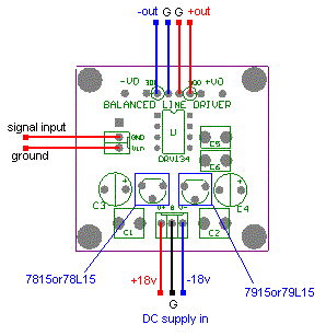

digi01 said:the BLD board part list:
DRV134/135 * 1
1uf50V * 4,(C1,C2,C5,C6)those caps that I have used is WIMA MKS2
47uf/35V * 2,(C3,C4)Elna RJH
LM7815,7915/78L15,79L15.the board can mounting to220 or to92L packaged regulator.
hook method below:
does imput voltage for the board have to be 18v or can it be higher or lower?
The regulators will need at least 18V to operate properly. You can go quite a bit higher, probably +/-30V. If you have less than +/- 18V you should probably build it without the regulators (bypass them instead).Evilsizer said:

cdoggy81 said:What is ment by the "hook method" ???
sorry for my poor english
it mean the method of signal connections and power connections.

By bypass them I mean don't use the regulators. Don't put them in, run a wire from their input to output. Keep the capacitors in, they won't hurt and may help with noise reduction.cdoggy81 said:What is ment by the "hook method" ???
paulb, what would be the best way to bypass them?
IIRC they don't need much current? Battery powered be an option????......????
Battery power is an option. Two 9V batteries might do the trick.
Cool Paulb, that's EXACTLY what I was thinking with 2 x 9V batteries in series
I have 2 sets on the way so I'll build 1 with & 1 without the LM338's. Wasn't too sure about the caps in without the regs but I will leave them in now, thanks. I might "anty" up & try some BG caps for those but they are little $$. C1,2,5,6 won't be that bad since they are 1uF though. Do C3,4 have to be 47uF? Are C3,4 still needed?
Thanks!
-CHRiS
