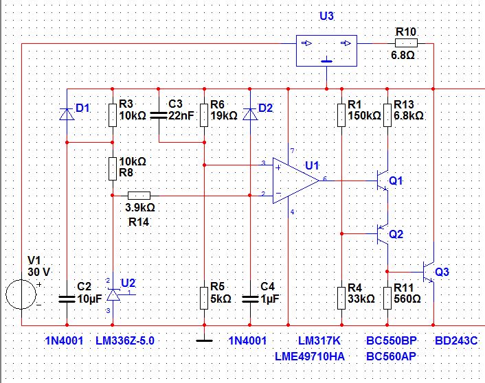

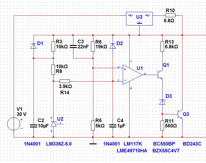

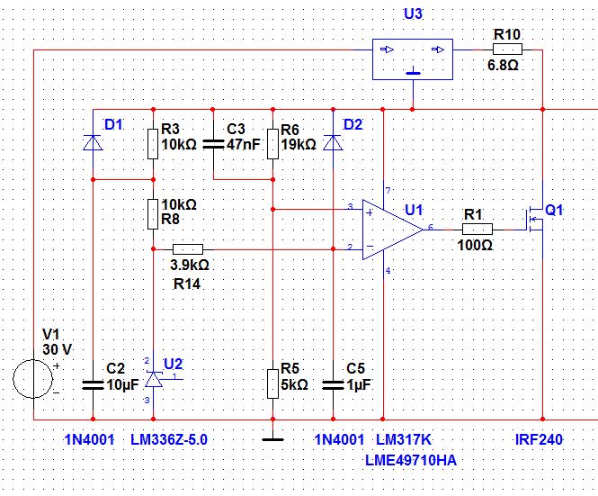

As said before, I was going have a look at shunt regulators. After having a look at many designs, I came up with what I think is a good solution. All 3 schema’s added here give about the same simulation results, the most important being, RG less than 10uOhm and Vac (on top of the 24Vdc output) less than 1uV. The design here is created for about 75mA steady state and 125mA peak at 24Vdc out (30Vdc input).
The first, schema uses a zenerdiode as level shifter, this may be a problem due to zener noise, and thus the second schema uses a BC560 for the level shifting. The third design uses an IRF240 as shunt device and therefore does not need a level shifter.
Please note that some parts could be dropped from the design, first of all D2 (but I leave it in there because I like to empty what I fill). For the same reason D1 could be dropped (or left). Also C4 is not absolutely needed (but I like it). If C4 is dropped then you could consider dropping R14 (but I like to have the impedance to both opamp inputs equal). Maybe C3 can be dropped, the simulation shows no definite positive effects for it (but also no negative effects, the current value is about ¼ of the first value that starts having a negative effect (about 100nF)). Then next you could drop C2 (it’s mostly there because I like to have the 'extra' filter). And if you dropped C2 then remove D1 (now it has no purpose at all) and change the 2 10Kohm resistors, R3 and R8, into one 20Kohm, or there about, resistor. All in all you could remove 7 components and still the thing will work. And eh… the IRF240 is a bit of overkill .
One more change can be made, the LM317 and associated 6.8 ohm resistor, can be replaced by one 27 ohm resistor. The simulator shows no differences, but using the LM317 is less expensive than using a thick film TO220 mounted resistor (that I could find). It has to absorb about 2 watts and I do not like it very hot, so I think heat sink mounting is preferred.
Maybe it helps someone, I am still undecided about using the shunt designs (if I will use one, then I use number 2 [with the BC560 level shifter]). Absorbing about 2 watts of ‘extra’ energy and still going to the 3rd power supply stage of the preamplifier seems a bit much to me. So, by this I invite everyone to convince me of using a/the shunt regulator .

Frans,
There is only one thing that can convince you to use a shunt reg, and that's your ears - when you listen to a pre using them in comparison with series regs!
But I don't understand how you are using the LM317 in your circuits - for a shunt treg to really work and sound as they can, they MUST be fed via Constant Current Source (CCS), and while a 317 can be configured as a (poor) CCS, I see you wire it as a series voltage reg.

Hi Allen,
The LM317 is wired as an 185mA current source, see that the output is connected to the ground pin by a 6.8ohm resistor, and that gives 1.25V/6.8ohm = 183mA.
I will do the experiment, and build the shunt regulators, and then listen. Maybe it will surprise me (and next time when you are visiting Henk I will invite you for a listening session) .

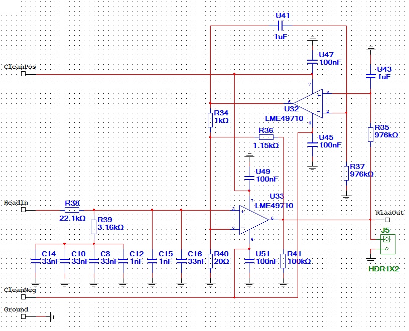

After building lots of prototypes, first unbalanced and later with balanced inputs, I settled at the configuration show in this post. The posted configuration was considered the best sounding one that I have build and presented to my listening panel (actually 4 people, all used to listen to life music and owning high end audio systems).
I’m sure that posting these schematics is not going to make me famous, and I am aware of the fact that critiques here may make me look a bit silly. But I need to know, what do you diy people here, whose messages I am reading for years on end, think about the thing I concocted .
Let me know what you think of it…

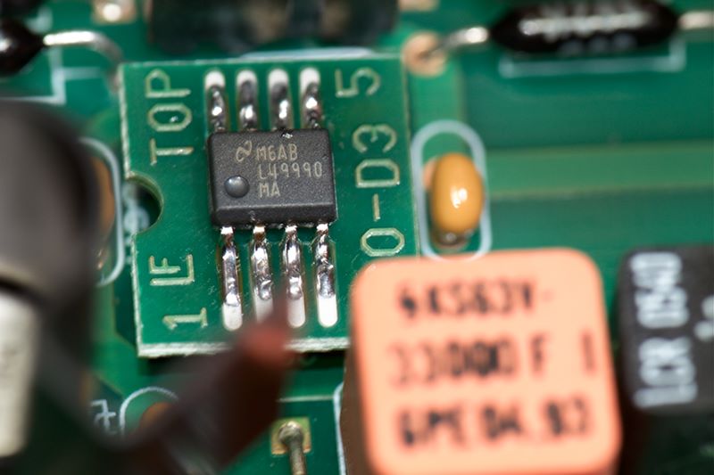

The first RIAA pre-amp upgrade is in place, the head-amps LME49710's are replaced with LME49990's, thanks to Joachim suggesting those. The total noise performance is way better (it is way more silent). To me it sounds about the same (1st impression ), maybe a bit more detailed, but it was already pretty good to start with. Next weekend I will call in the ‘big eared friends’ and we will sit, listen, talk and have a few beers after that. I will report on that later on.
