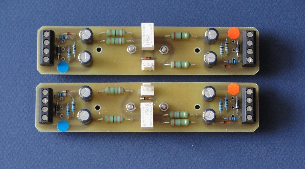

In order to make some progress on my own, I made up a few boards quick and dirty, soldered them yesterday, so that we have something to keep the waiting cloud excited.
The production boards are going to be just as good if not better.
Here is the first one -- the Auxiliary Power Supply. Nothing fancy, just 7812 / 7912.
Patrick
Patrick

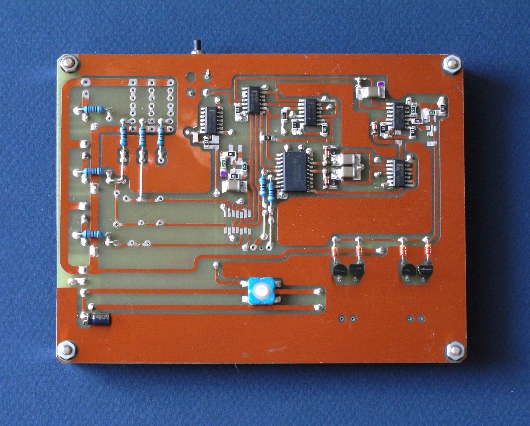

Last but not least, this is the control / protection board which is still work in progress (waiting for some components).
The dark orange part is not oxidised copper, but heat treated photo-resist which can be used as soldering mask.
A special feature of Bungard PCBs.
Patrick
Patrick

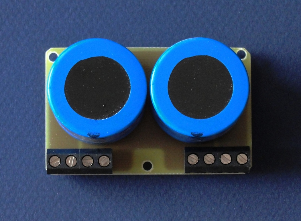

Someone asked about my choice of copper thickness.
Don't forget that the regulator and the capacitor boards are carrying the entire bias current (i.e. 4A).
I leave you to decide collectively how much copper cross section you want to have for 4A.
The track width is about 4mm on the regulator board, and 12mm on the cap board.
Patrick
Patrick
