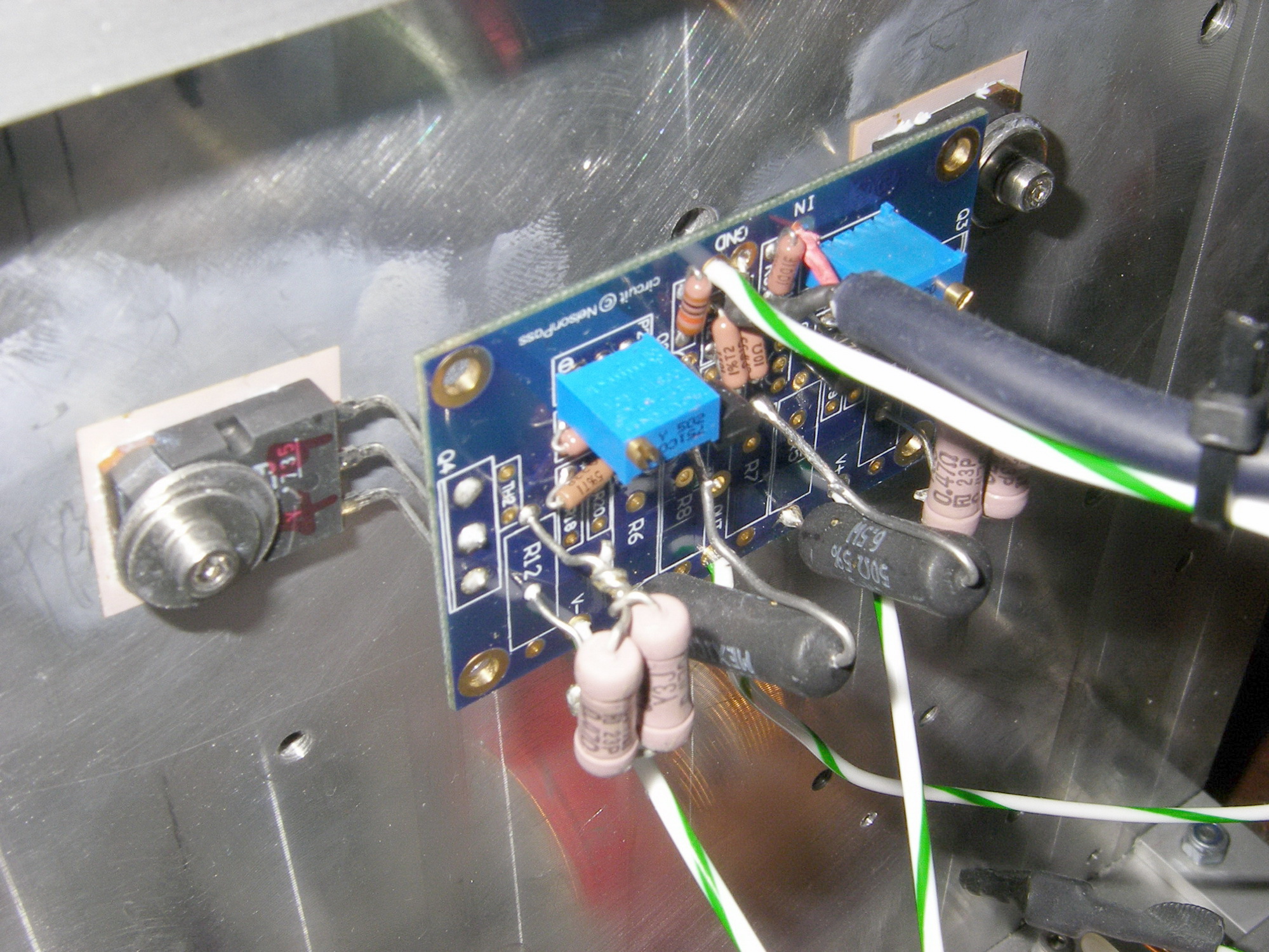

Here is a picture (not balanced F5)!
Almost a year, I am using 2SK1529/J200 without thermistor & current limiter, I like them better than Fairchild mosfets!
Biased at 1.75A and 8oC-10oC (kapton isolators) difference between heatsink and mosfets!

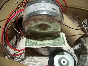

Pictures please
Only a true DIY'er can get excited about pictures of a transformer...
My transformers probably won't show up for a couple more days over here on the west coast, so yes pictures please...
Wow--you mean, you even got a stack of $1 bills, with your transformers? Nice.....
If you are in Western New York state, I'm guessing you'll have a LOT of time to build the amp, before you get your Spring Thaw!
Nice tranformer!
Nice tranformer!
Yeah! The dollar is so weak the Canadians use it for packing
