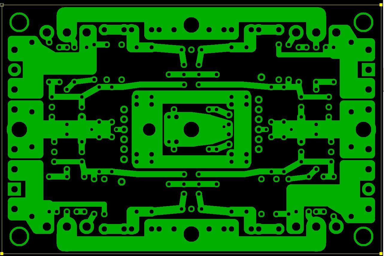

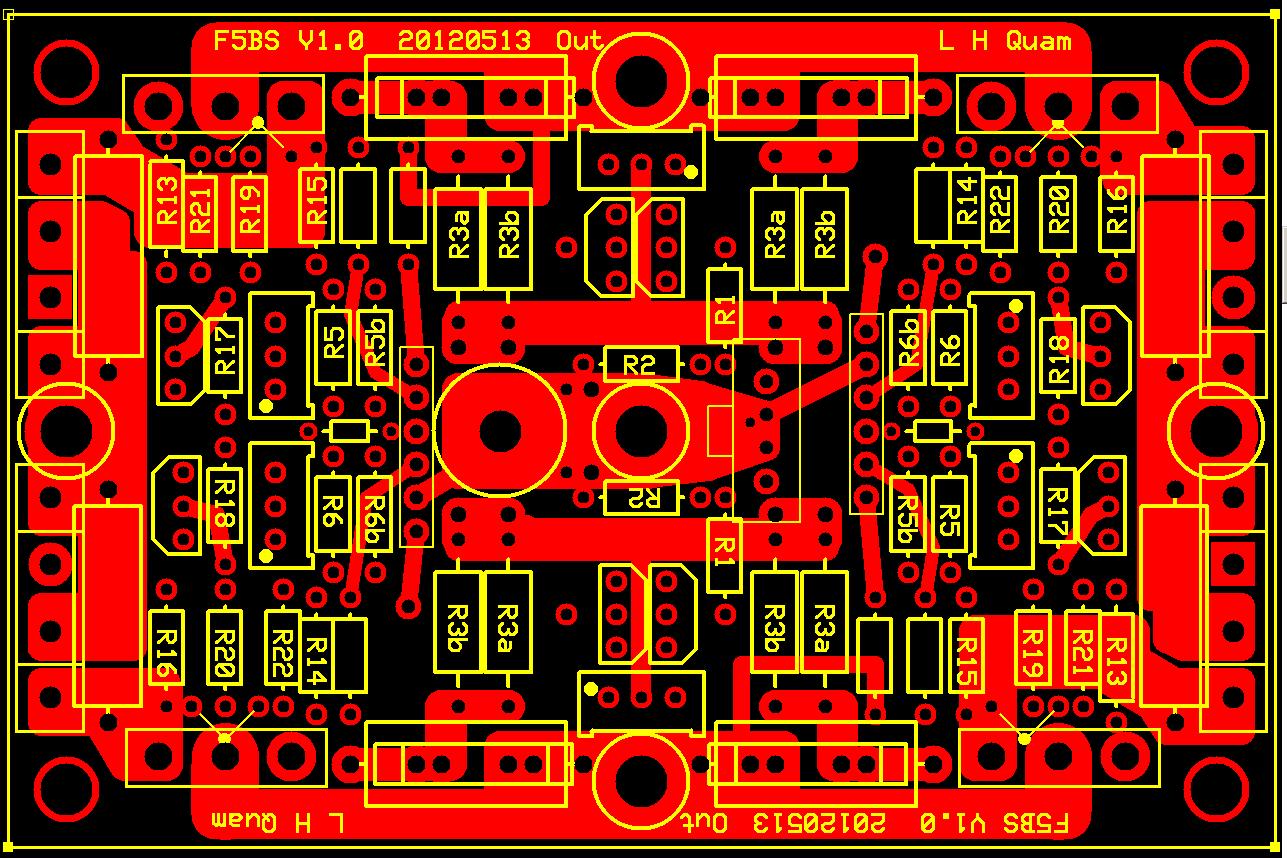

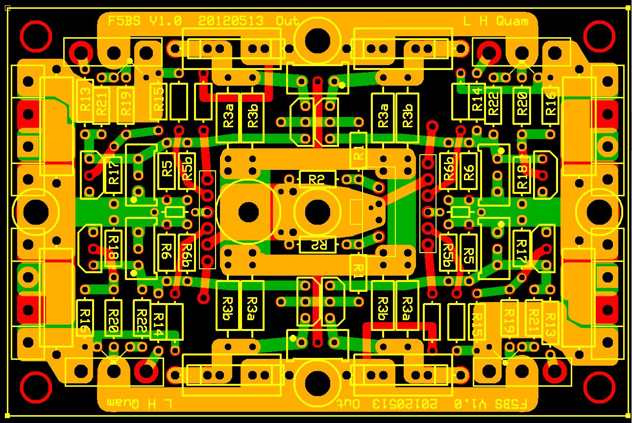

The same card is used for all different configurations. The difference is what components, rail voltages, bias currents, and packaging options are used.
For example, an F5-Turbo-V1 is created by only populating the MOSFET and its gate and source resistors on one of the amplifiers of the board, and (externally) connecting the 2 output standoffs together. Two wire jumpers are needed to connect the gate resistors to the JFET drain node of the other amplifier.
Similarly, the F5-Turbo-V2 is created by implementing the V1 configuration and adding the MUR3020WT diodes.

V1.1 of the board will support the Turbo diodes.

The availability of the board will depend on demand. There is still a lot or work to be done putting together the documentation for all of the different options that board will support and the BOM for those options. I would be happy if there was enough interest for the DUIAudio Store to accept it.
