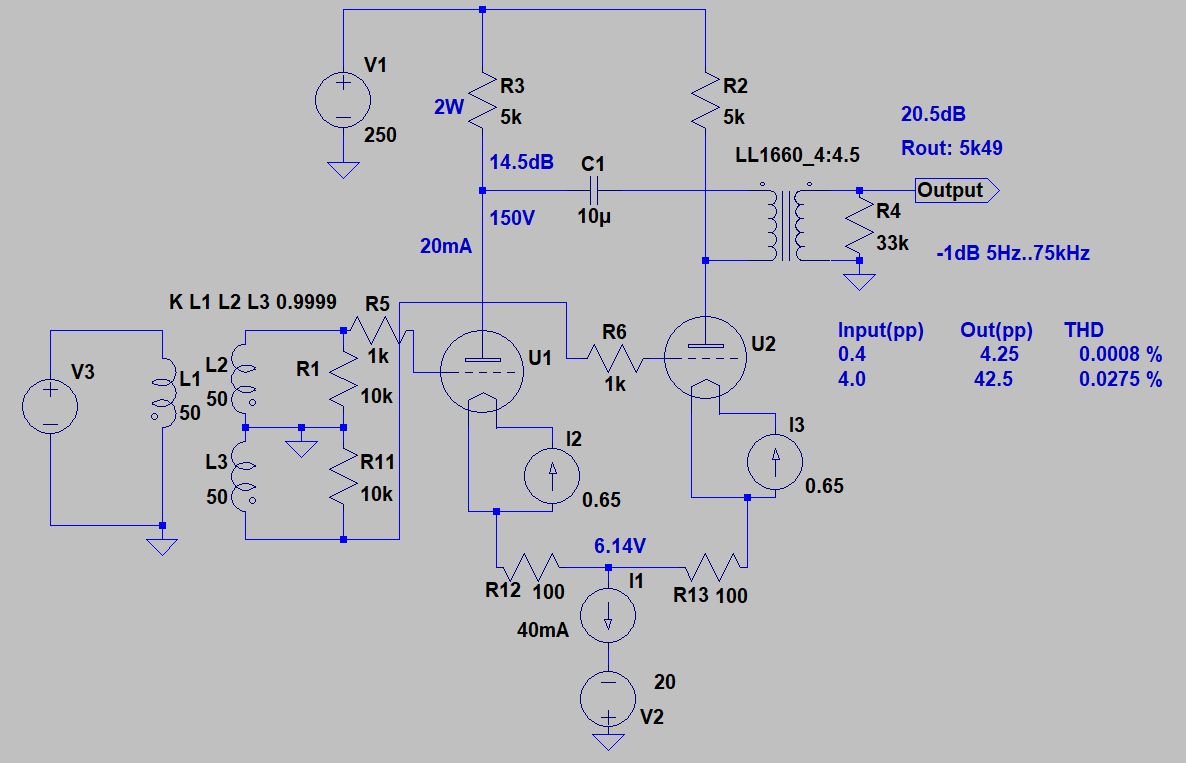

Here the pre with LM317 CCS.
I plan to use a pair of DHTs, perhaps 26s. It may not work well, but I'd like to try it.
Firstly, I've never used a CCS before (or any solid state) - is there a primer on how to calculate the resistor network required to provide 12mA through the CCS (each 26 approx 6mA) ?
Secondly, I've never used a valve model in LTSpice. If I PM you would you be happy to mail me that model to give me a start point ?
This is mich simpler: You built the ccs with a variable potentiometer, just order from kandkaudio the kits which are really inexpensive. Than connect plus and minus to a voltage source of 12V, can be any lab psu or battery or whatever you have. Dial the ccs with the poti to the current you want. Done.
Put it into your amp and it will maintain this current. Measure the voltage across plus and minus and be sure that it has enough headroom to operate (9-12V at least plus some swing for the signal) and that voltage is not too high for the potential heatsink you use.
What is really nice: You can plig and play with the bias point, eveluate the sound of more and less current, put other tubes in the circuit and bias will be automaticaly correct set.

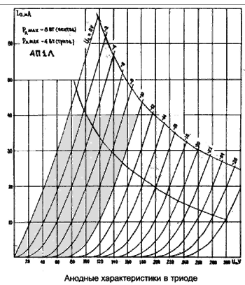

If you want to have some real fun, grab some 4P1L (4П1Л) direct heated pentodes and triode strap them. They will have a mu of ~11 or so, but are an absolutely amazing valve, and still can be had for a decent cost. Only potential downside is the loctal basing, but they are such a physically and electrically handsome valve that it's definitely worth the fuss. They are often used in parallel SE for a wonderful little flea power rig, but make great signal tubes as well.
Just look at those triode curves!
Tube Tester Files - 4P1L
4П1Л/4P1L triode curves – Bartola(R) Valves

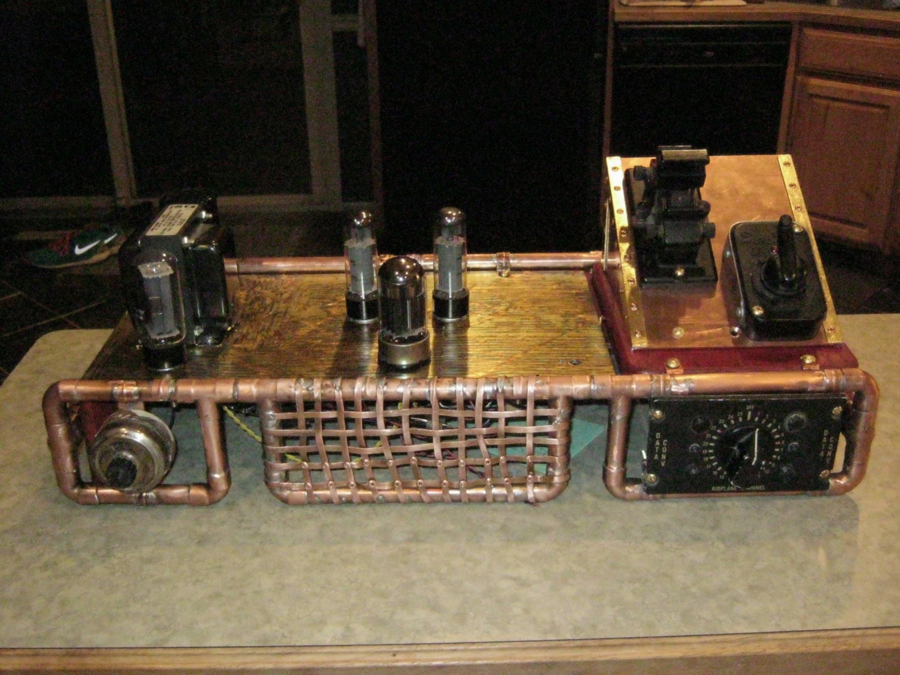

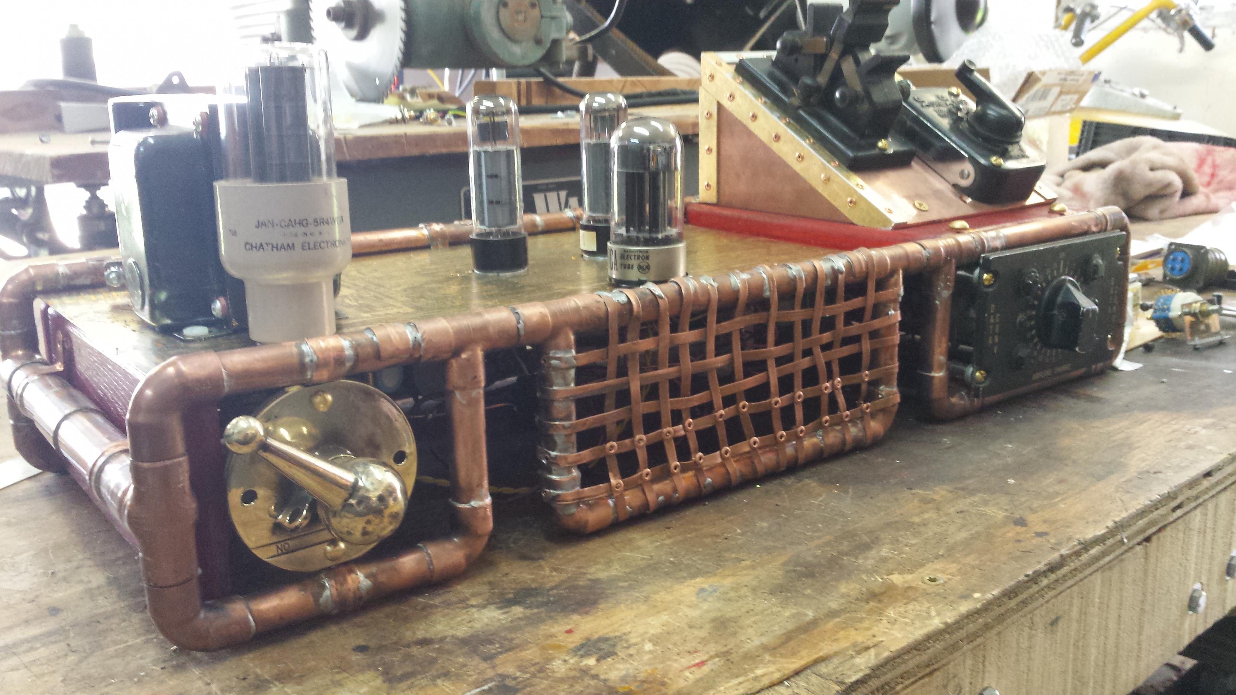

I built Pete Milletts low mu preamp and i love it. You can change tubes to increase the output level. Here is a link to his page and a pic of mine.
Low-mu preamp
Low-mu preamp
