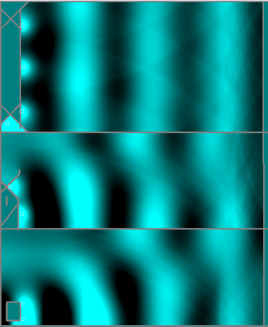

If I may, those comments remind me of this. The middle diagram, a side view using two sources. There is a discontinuity running downward and to the right, it is connected with the ceiling just above the speaker. It goes over the listening position, but how it gets that direction is not so intuitive.
