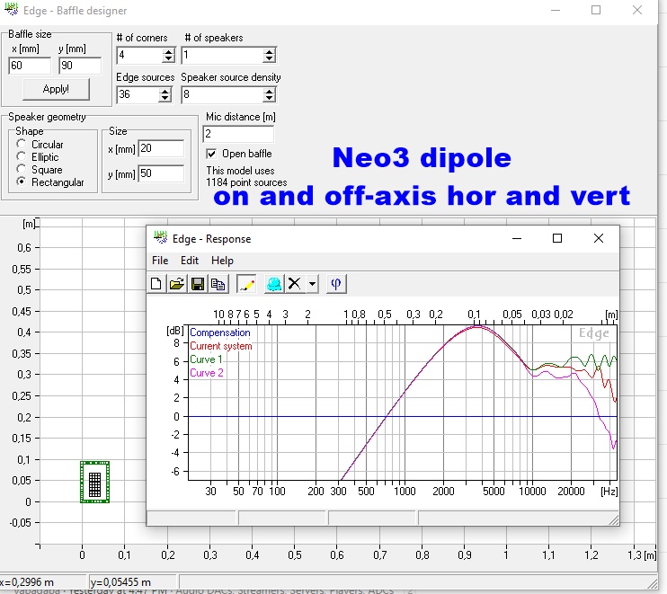

A sim

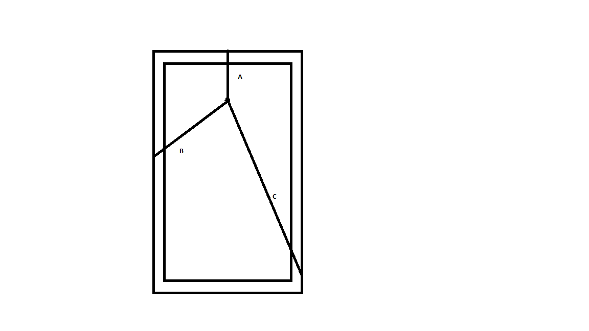

Diffraction is audible and important to manage if you're looking for the very best- and that's what we try to do in our hobbies. It's relatively easy to use smooth-edged design elements if you're taking the care. My next roundovers will be 6" radius as I have some 12" half-round plywood that's just begging to be built up.
Using a good radius or even bevel will do add more "spreading" to even a complex driver/baffle model. Note line segments A, B, C- this simple 2d model shows the spread- the variance between these paths on the "roundover" area (Between rectangles) is relatively broad, and would be more pronounced in 3 dimensions.
