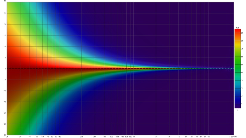

Hi all, a graph from this thread haunts me.....
I think it's all wrong...
I think for any waveform origination, phase alignment is when initial rise times are in sync....not peak energies.
And if that understanding is true, and IF our hearing is in sync with true waveform origination, graph must be back-asswards....????
Please straighten my thinking....

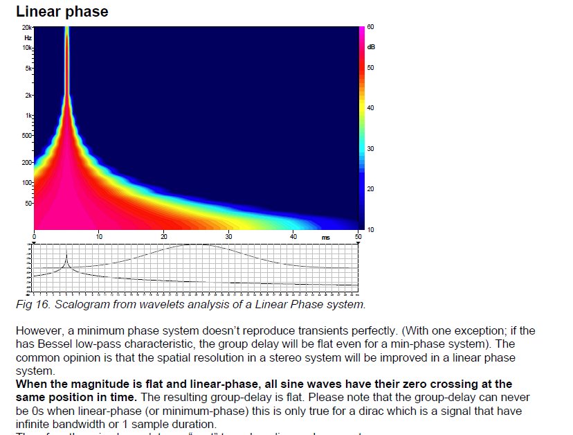

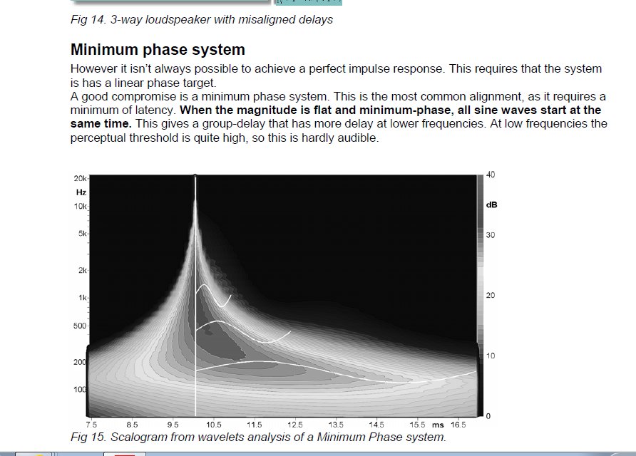

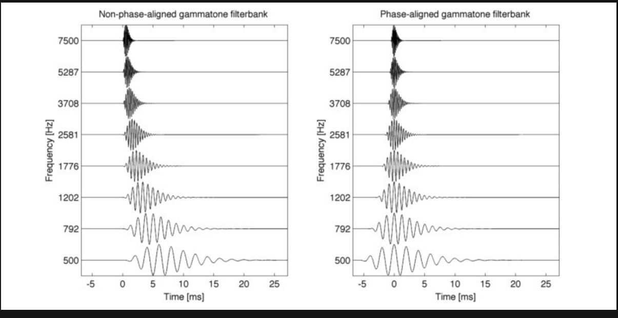

I think you're talking about the difference between a minimum phase system and a linear phase system ?
I took these grabs from 'delay alignment a survey' pdf I found online.

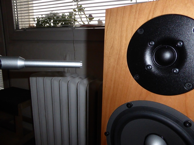

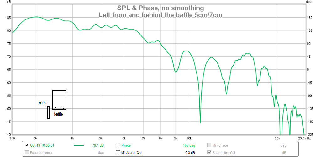

Would it be possible to investigate these virtual image sources by a microphone placed near to baffle edge line as shown in the attached photo? If yes, what is the interpretation of the plot shown, measured this way. Thank you.

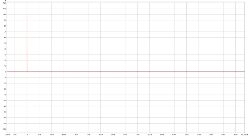

Hey Mark,
Create a Dirac pulse in RePhase and import it in REW, on the IR tab it will look like a single peak.
attachment.php
Next go to the filtered IR tab and choose some different filters, like 63 Hz, at 1/3th. Switch back each time to the IR tab to see the wave shape at that point, it will show the initial rise times are in sync.
Example from a filtered 63 Hz signal:
attachment.php

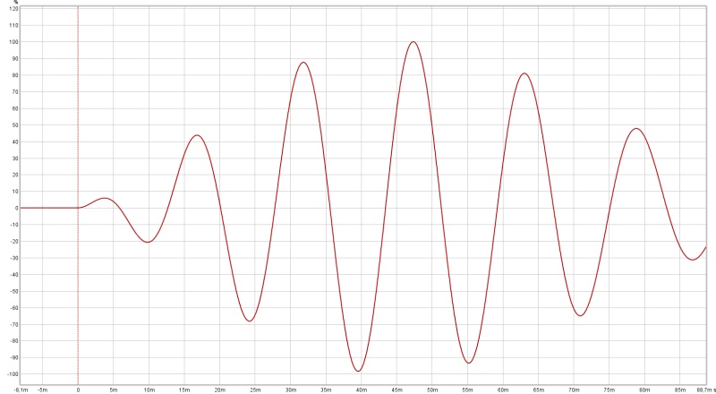

Turn off all filters and create a wavelet and it will show this:
attachment.php
I think that in principle it should work, but in practice it is going to be difficult. The reason is that what you are measuring is a composite of everything, some of which is the diffraction, but the diffraction is fairly low in level compared to the direct sound, and some are near field pressures which do not propagate. So sorting it out may be problematic.
This kind of reminds me of my attempts to measure sound radiated from the enclosure itself. Never could sort out anything of value.
There are techniques which fall under the general classification of Acoustic Holography, which again, can in principle do this problem. But they are know to be notoriously difficult at resolving secondary source locations better than 1/2 wavelength.
There are simple cases which are easy. Consider a circular piston centered in the end of a long circular tube. The difference in the radiation pattern from this configuration and that of a simple circular source in an infinite baffle is due to the edge diffraction. From this difference pattern we could work back to the source and find precisely what was being diffracted from the edge. But the general case is far more complicated.
Thank you, this makes sense, of course. Would it be more revealing to measure aside and behind the baffle, so that bending of waves around the corner and diffraction should be more emphasized?
