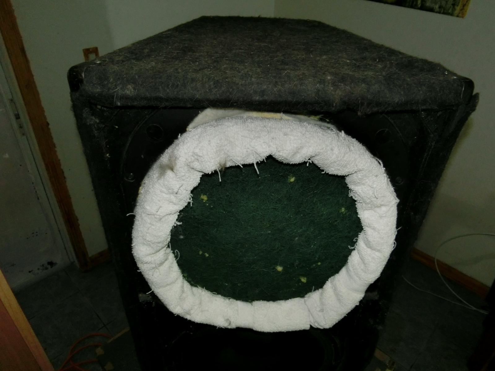

If one can suspend judgment on the dubious design and decor consequences of this idea, might a lot of edge diffraction be reduced if, instead of the apparently little effect a felt ring has, instead do a variation on the "towel trick" used with success on horns (but to reduce the cavity resonance), as follows: fabricate what I'd call a hood (cowl?) around the driver(s), sort of a partial funnel or torus around it. This would, I would think, greatly reduce any waves to the side and to nearby diffraction-prone edges.

This is what I've used for two years...
For two years I've been happy with a pair of "parts or repair" Yorkville Unity U15 that I run active. Among other easy mods, I stuffed the horns with polyfill, green thing is air filter to hold it in. Towl cowl is a horn trick. I have limited measurement ability, so can't claim "better or worse." I have bought some 30 PPI foam to make a proper plug a la Geddes.
Appearance is clearly not a priority. I have four cats and the "rat fur" serves as a good scratching post. Be appalled if you like, but these replaced some Bose 901, so surely this is an upgrade! :D
