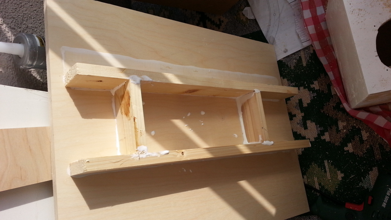

Bad enclosure design or crappy driver?
Here photos
Is it very important that braces to be glued to both sides because it is not tight when placing the sheet to subwoofer ? There is a space between pieces and side of sub

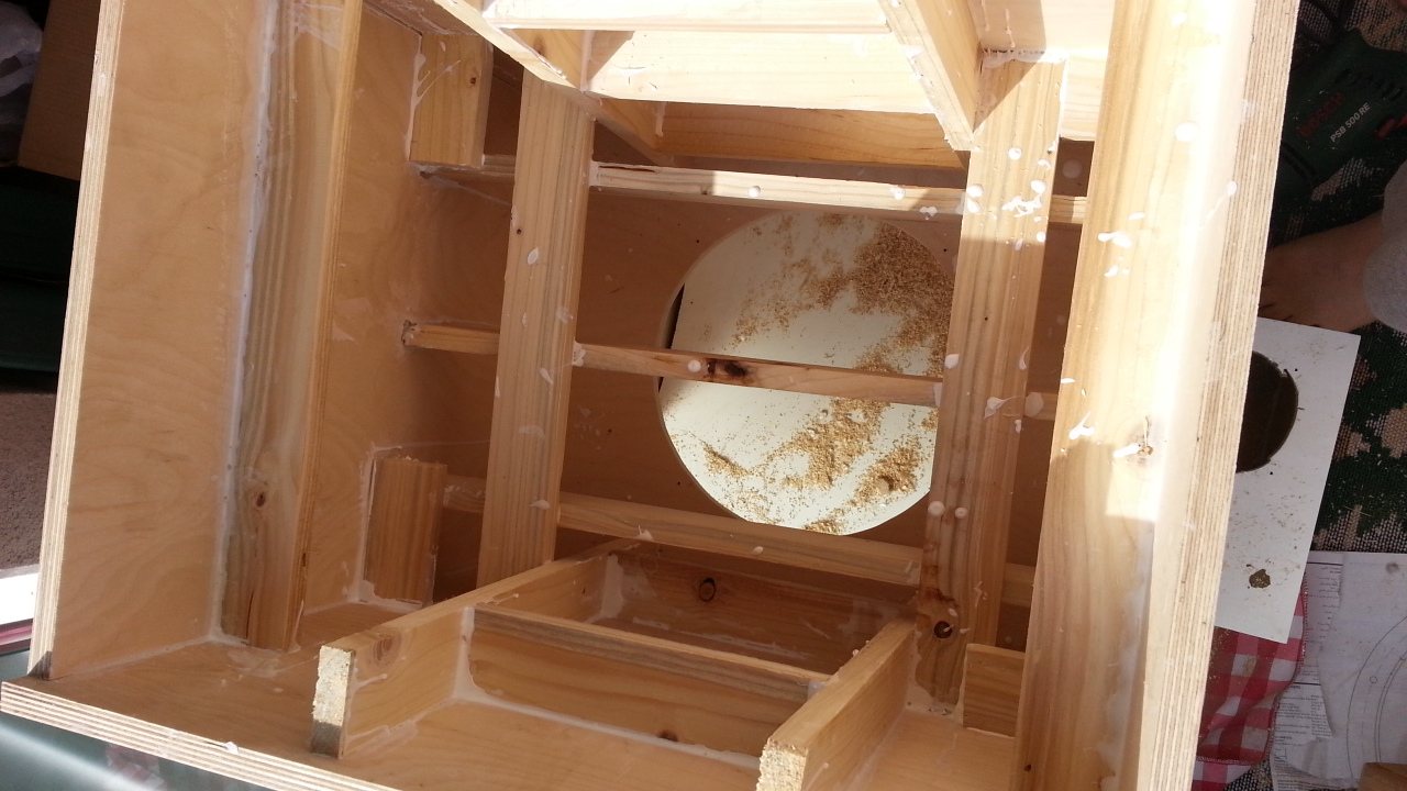

Sorry for my bad English. I meant braces are glued on one panel but sometimes they do not contact well to other sides left and right.There is one or two mm blanks somewhere..Is it very critical for vibrations and sound.I am talking about 2. Picture.
And i will first build the schleton after that will glue outside panels in future
Glue alone when using a small interface surface area will not carry sufficient tension.
Either the glued joint will fail or the ply to ply bond will fail in tension.
You must find a way to secure the bracing to the panels, such that the junction can carry both compression AND tension.
