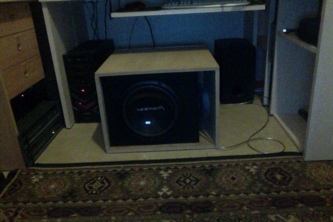

I think i attatched a picture of the 10 inch sub, according to my meter it hit 120 peak and 110 continuous

I suspect your port is very wrong and badly screwing things
up. 43 ins squared is simply very wrong in a 2.15 cuft box.
A 33" long port ? How did you manage that ? It takes
up 0.83 cuft of the cabinet on its own, its not right.
rgds, sreten.

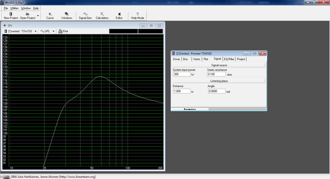

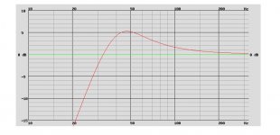

The link you provided has the T/S parameters.......but just a few...most are missing.
WINisd accepted the few specifications (I thought it wouldn't) & created some very different results.
This being what we have to work with, very little but "telling"
4 Ohm, 95 Db, Qts 1.16, Fs 41 Hz, Vas 1.13 cubic foot, Xmax, 11 mm
All the available parameters tells us this driver is poorly damped at 1.16, has a rather high resonant frequency at 41........
What sim I did get was a low EBP making for a sealed system, not a ported set-up. Sealed it behaves erratically a big response hump -3.1Db@32.23Hz up to +2.96Db@54.27Hz.....177.9 Liters, not surprisingly a Qtc of 1.26.
The sim switched over to ported gets an enclosure over 1000 Liters..

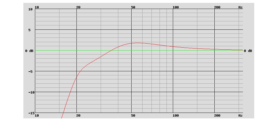

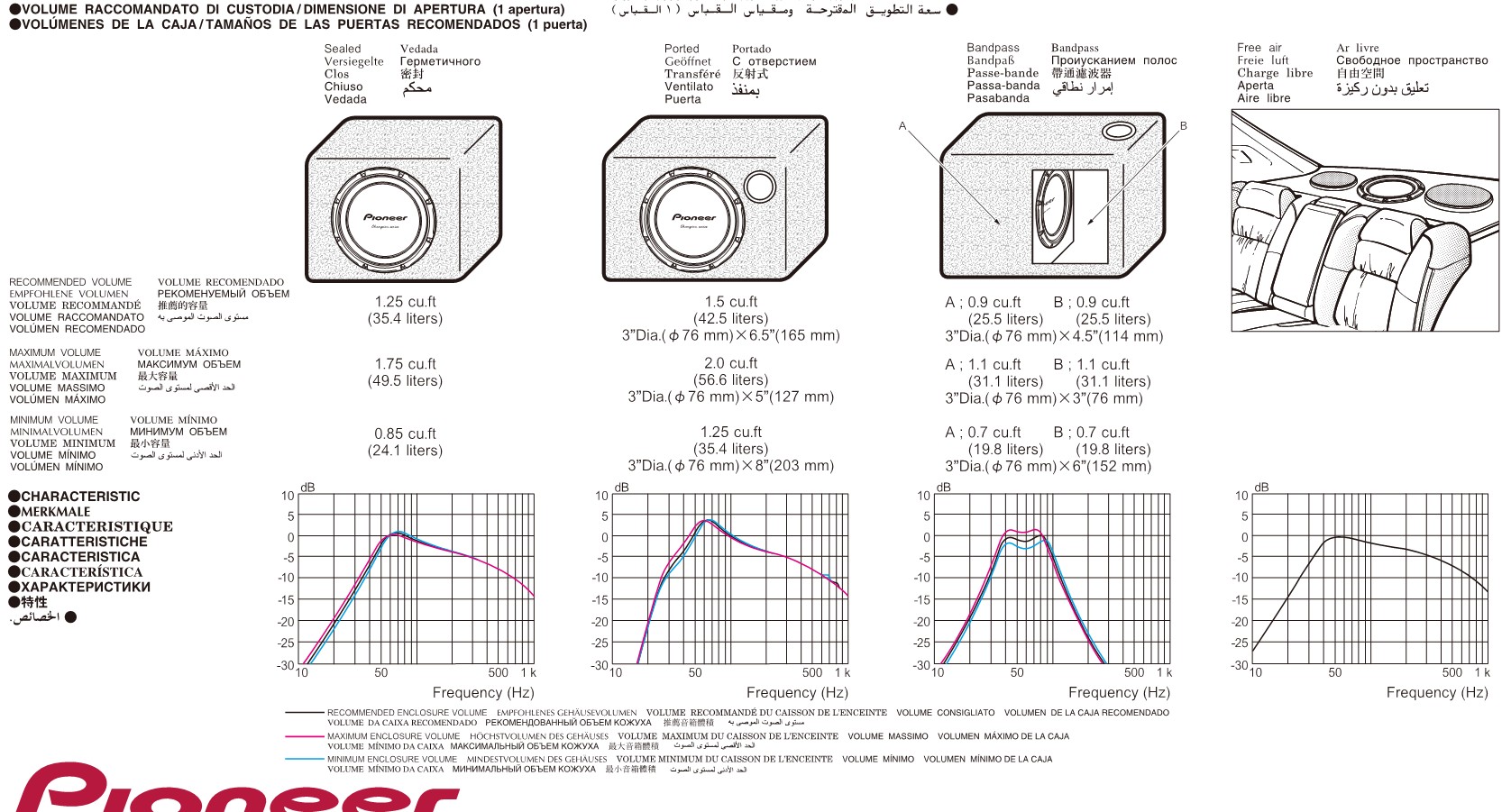

Yeah the rest of the parameters came in the manual once i bought it, but there is a spec sheet online
Pioneer user manual
you have to zoom in quite a bit, but almost everything you need is posted there.

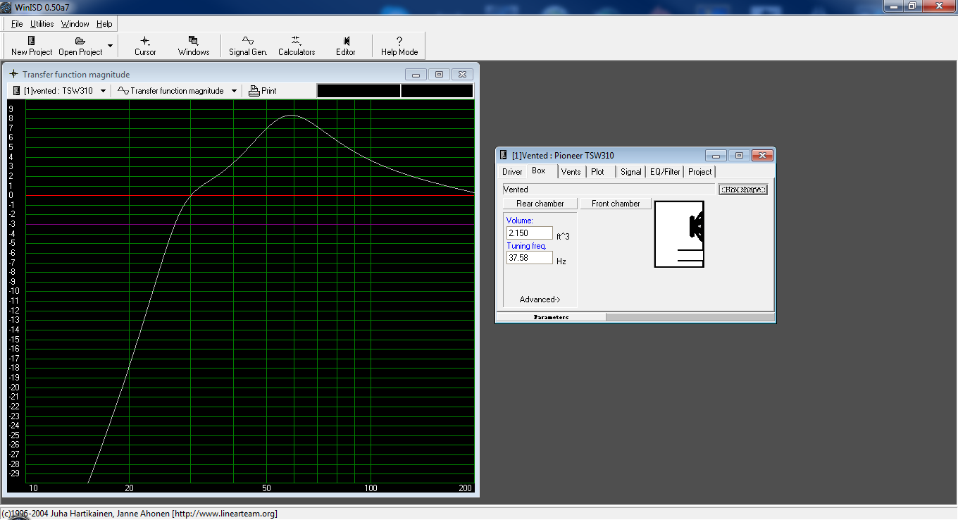

I've uploaded what I got in WinISD and what the actual built box is currently designed to

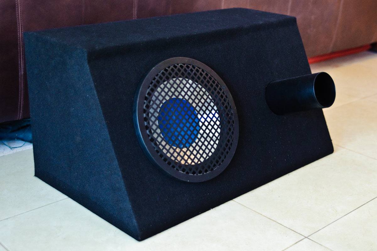

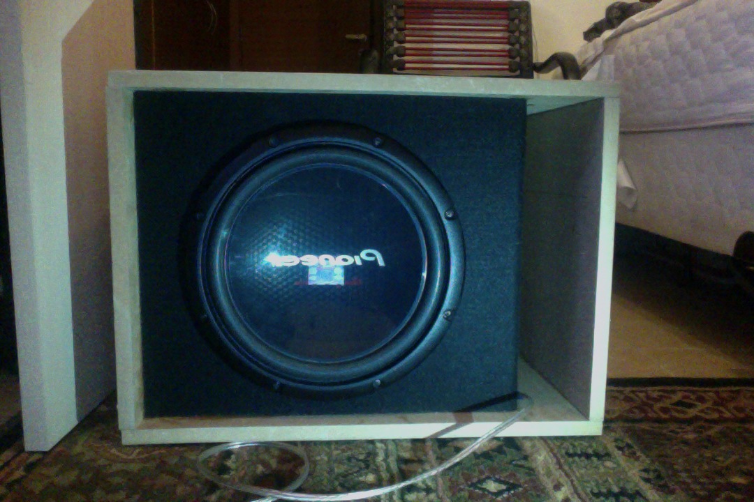

Is this picture the actual sub you built? A 33 inch port will display some resonance i think.
The one with the blue cone is the 10 inch subwoofer (1.5 cu with 30hz tuning)
Below is the subwoofer i'm asking about (12 inch, 2.15cu with 37hz tuning)

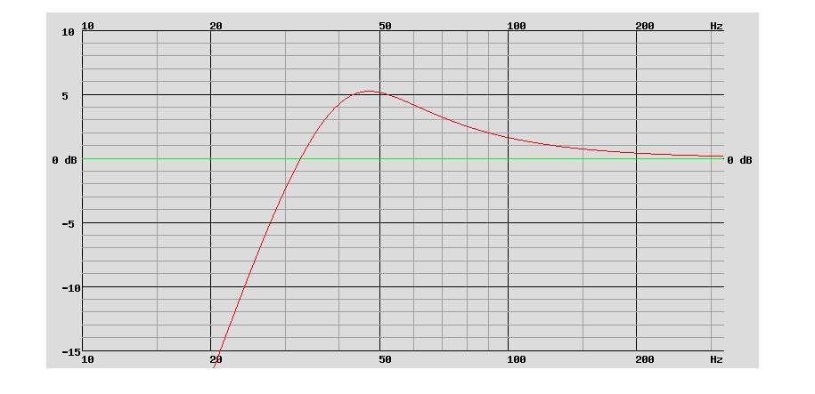

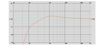

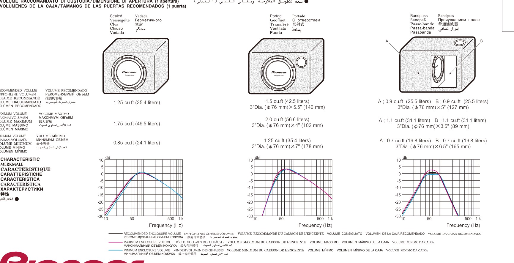

Pioneer TS-W310S4
DariusMyszka,
The S4 (not the D4), in the link you provided.
TS-W310S4 30 cm 4? Enclosure-Type Single Voice Coil Subwoofer (1400W) - Pioneer Speakers, Subwoofers
Is it for home or car stereo.
If for car use the schematic (enclosure) provided by Pioneer.
If for home use a sealed 50L to 80L as big as you can speaker.
Doesn't mean you can't use BR or other is just the driver is made for that type in a home application. In this case we will have to look at the alignments.
Your reference: 2.15ft³ = 60.881L
Are you modeling a BR with this net volume?
Length of the port? or tuning?! It's a very long port, are you counting with the volume of it (ports + drivers)?
You can not do too much (or thinking) with out knowing what you have. This needs some control on excursion or be limited, if you go the BR enclosure way.
Let's say you have a 60L tuned to 25Hz.
It's sensitivity is ~89.6 dB/2.83V/m and SPL 1.00 m/116.1 dB (max. theoretical) 950W/4Ohms.

In your case, you say:
Your reference: Port 43.5in² = 280.64cm²
This will give for a speaker/sub with 60L@37Hz
a port length of: 93cm = 36 39⁄64in.
(I don't believe is your case...) :)
And you will need protection under 30Hz (max. excursion with 650W/4Ohms) not very reasonable for a sub. :eek:
If you re-read post # 3 you'll see the OP said he has the TS-W310 ..Not the TS-W310S4 nor the TS-W310D4 .All three of them are different, some are suitable for ported, some are not.
Since I refer to post 3, he notes the TS-W310 solely.
Given that this IS what he has, a ported alignment won't work.
With the following TS parameters, a large sealed enclosure(As big as possible or practical) is the only way to get this driver to work best.
If this indeed is the correct driver since the EBP is at 30.82 it is best as a sealed type.
300W, 4ohm, Re 3.0, Le 1.26, Fs 41, Qms 9.18, Qes 1.33, Qts 1.16, Vas 32.1L, BL 9.9 (Note, the sensitivity ratings are "rated" with the caveat "In car"")??
Maybe the OP used the "S4" or the "D4" variants for designing his enclosure?
This seems highly likely.
___________________________________________________Rick.........

You're right about it being the W310, not the S4 or D4. The EPB is very low but i thought even though it is such a bad number i could get the numbers posted on WinISD, but it gets nowhere close to 117 at 50hz.
Also could the very low EPB cause all the port noise or is it just bad port designing?
The very high Qts and low EBP don't mean anything in this application, yes for a speaker to sound good and have an even frequency response those parameters matter. But here the user does not care about a huge peak in response and poor sonic performance, all he cares about is getting a big SPL reading.
How thick is your baffle where the speaker is mounted? The noise could be turbulence from the rear of the speaker caused by thick baffle or strangled basket design which is being emitted from the port.
Did you take account of the volume the port uses up and make your box bigger by that amount? Tuning higher than you think would give exactly the symptoms you have got.

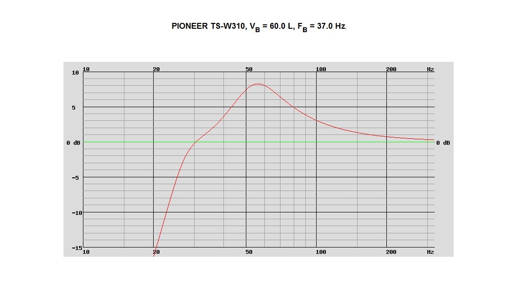

Rick, I don't know what's the point of the OP. Or he is not aware of it, or he wants something he is not expressing /explaining... (possible?!) It's obvious, not with the same enclosure he is being stubborn with. ;)
Many members just leave after the fact...
Another possibility that I did not test is the bandpass. It comes well represented for car audio. It has a 3dB atten. @37/38Hz to 93/100Hz.
The port OP is mentioning for 37Hz tun would be ~90cm... :rolleyes:
Maybe OP is in a competition insisting in SPL... I don't know.
In this case is 1.00 m/113.6 dB (max.) witout car gain, for ~800W@3.5 Ohms (theoretical).
