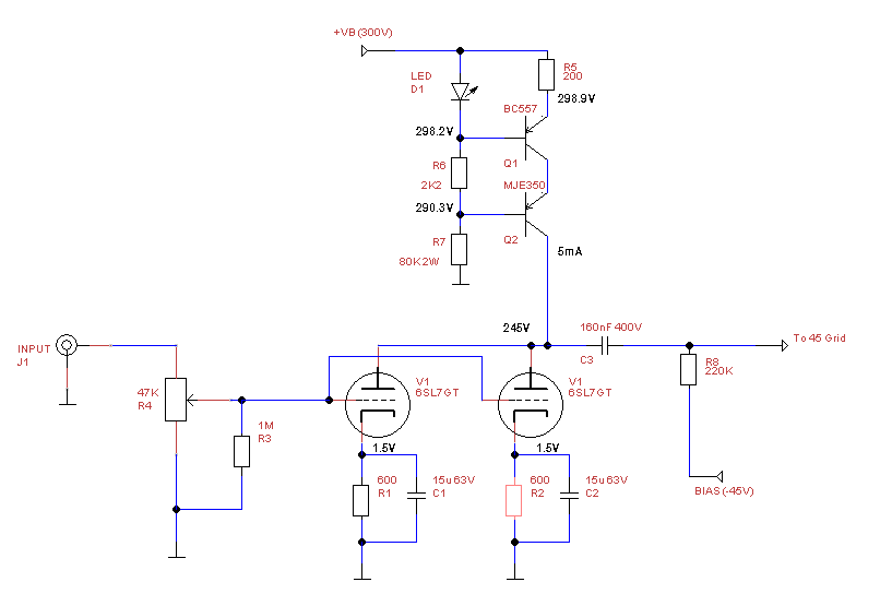

After some time I'm back on the 45SET project. I breadboarded the circuit with two paralleled 6SL7 driver using a resistor anode load and coupled to the 45 via a capacitor. Good results so far, so I spent most of my time building the chassis.
Now, after seeing the 4PL1 post from Wavebourn, I was encouraged to replace the anode resistor with a transistor CCS. Was keen to get into a mosfet gyrator, but I guess I needed to try a simple CCS to see the results.

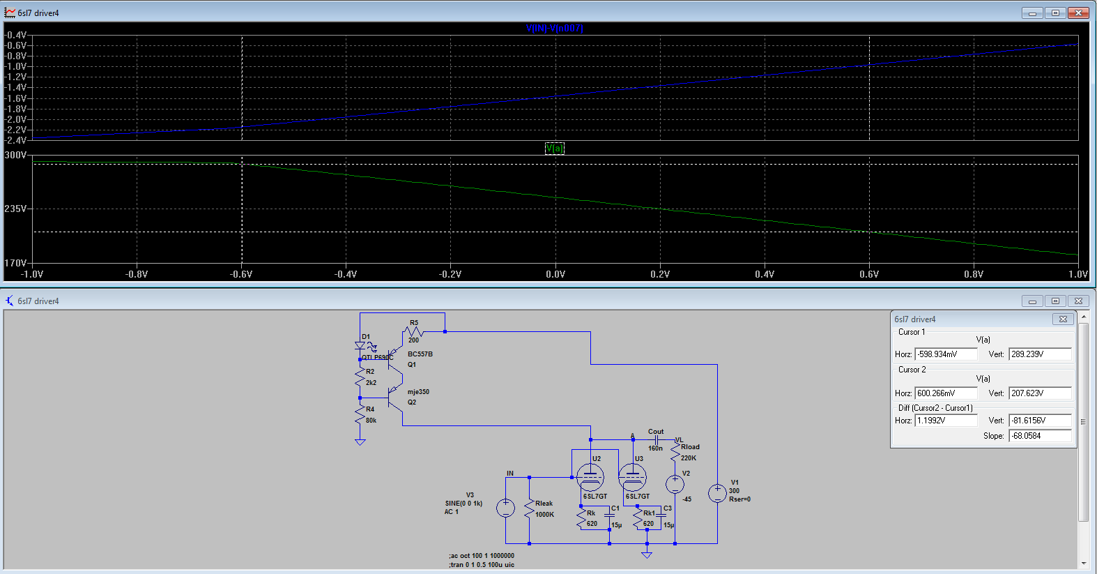

I did a first FFT simulation with LTspice and got around 1.6% THD with the resistor load. I only considered the second harmonic for simplicity. I then replaced the anode resistor with the CCS as in the attached diagram. I got around 0.1%THD if my calculations are ok.
Before moving forward and build the final circuit, does anyone have any recommendations to this setup? Will it be worth pursuing a mosfet gyrator instead of a CCS?

The way your driver stage is set up with just 500mV bias it not only has zero headroom, it is not even able to drive the 45 to full power. The driver stage will dominate the sound of the amp like this.
Also why the 1k series resistor to the 6SL7 grids? 6SL7s are not prone to oscillations. If you still want to apply grid stoppers, you should put one in series with each of the grid. But I'd skip it completely.
It would also be a good idea to put a resisto to ground after the wiper of the pot. If the pot looses contact the grids still have a reference to ground. Something like 1Meg would be ok.

Thanks Thomas,
Well spotted. When I split the cathode resistor in two as per suggestion above, I made the stupid mistake of halving the value (400 ohms) rather than doubling it!
Why not grid stoppers? Isn't it a general rule to add stoppers to all valves?
I previously had a 220K grid leak resistor after the pot which I removed due to suggestions from other members of the forum. Agree that doesn't have the effect of grid leak as there is a 47K pot as well, but understand your point so will add the 1M resistor....
So what is your op point now?
They are required for high transconductance tubes since these are prone to oscillation. Many people just blindly copy them so it appears as a general rule.
Many designs even use stupidly high value grid stoppers. And others again copy it. This way poor design practices get spread.
As you drew it, it wouödn't make sense anyways since grod stoppers need to be placed right at the grid pin. Usually 200-300 Ohms are enough. But I never saw oscilaltion problems with a 6SL7.

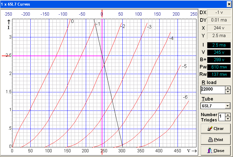

I changed the cathode resistor value to 600 ohms after running simulation with TubeCAD. I then run the simulation in LTspice which led to a 2.5mA anode current per valve and a anode voltage of 210V. Bias voltage is around 1.5V on each valve.
When I compare this result with the anode curves, I was expecting to match the 1.5V curve at 2.5mA and 245V, but it looks more closely to the 2V grid curve instead. The resistor load line is the equivalent since I cannot add a flat load line to represent the CCS.
What do you think about this operating point? I believe that gives sufficient headroom for a 2Vpp signal, doesn't it?
Better, but for my taste still not really good. Grid current effects and associated non linearities will start to kick in at bias voltages below -1V. I try to stay clear of this region in my designs. Simulation will not show you this.
Also you have more headroom at the 6SL7 input now. But with the B+ at 300V and plate voltage at 245V, not much headroom for the plate going positive.
I think I mentioned before that I don't think the 6SL7 is well suited for a driver tube.

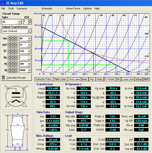

My 45 SET need 35Vpp on full power. So yet have a bit of headroom, agree that is not too much, but suits the requirements. What bias point would you recommend?

35Vpp ? That would be quite low. Your bias voltage is indicated as 45V which would require 90Vpp normally. My own 45 even needs more than 100Vpp
Thomas
Hi Thomas.
You are quite right. I quoted 35vpp which was the calculated value for headphones output power. I need about 80vpp to get more than 1W
with the current bias point of 2.5mA per valve and anode voltage of around 245V set by CCS then I can get around 80Vpp with an input of 1.6vpp thus an output power of about 1.1W which is not bad....
45 bias point is Ia=32ma and Va=246V

Ia= 5mA and Vg=-1.2V bias point for 6SL7 driver
Hi!
Thomas
Hi Thomas,
I guess I found a compromise bias point at -1.6V. This will give me 80Vpp output with a 1.2Vpp @5mA anode quiescent point. Also the grid voltage stays above below -1V as per you recommendation.

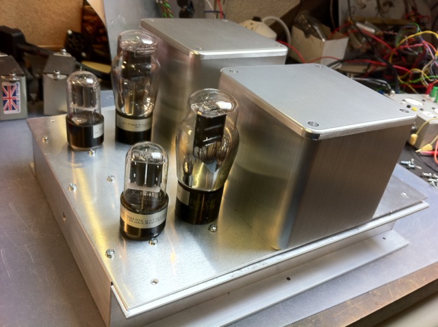

Also, here is a picture of my work in progress 45SET amp... :)

After spending a bit of time simulating CCS options with ltspice, decided to etch a pcb for a mosfet CCS based on suggested designs in the forum. Since I had lots of IRF840, I used this mosfet for my CCS, although the quiescent current is only 4mA.
My first test was on Ia=5mA and Va=258V, which gave terrible results: Sensitivity only of 0.7vpp and Vo=46Vpp. Not enough driving voltage for the 45 valves. I know Vinylsavor predicted this, but didn't want to give up so easily and sought for a different operating point.
Second attempt on Ia=4mA and Va=236V. This was done after tweaking my zener network and bias current since 5mA was too much and reduced it to enable the zeners to regulate at 241V. So now the sensitivity increased to Vi=1.4Vpp and Vo=91.2Vpp before any second harmonic can be detected in my oscilloscope FFT. This looks good now! In my design I need 80Vpp to achieve 2W of output power, so I'm ok with this. I know this can be better achieved with greater supply voltage, but I'm limited to 300V at the moment.
A slight reduction in gain was the price to pay, buy I'm fine with Av=65.
Also did a quick frequency response test and got a flat response to 78kHz (-3dB) point.
What I noticed is that I couldn't change too much the current bias point of the 6SL7 pair by changing R4 - is a 100 ohm resistor with a 5K trimpot in series in my pcb.
Any view as to why this can be?
Any other recommendations before moving forward to the next stage?
That's because R4 is small compared to the internal resistance of the SL7. And the gate is DC referenced to the plate voltage. So changing it won't much change the voltage at the source.
