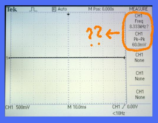

Did you happen to measure the regulated voltage ripple? The maximum vertical
resolution of my scope is 10mV/Div (not very sensitive). With it, I could measure
no ripple on my regulated rails. Yet, I could still see a very small amount of 60Hz
hum at my outputs (I don't remember the magnitude of the 60Hz signal - it was
small, but measurable). How about for you?
Congratulations again!
Robert

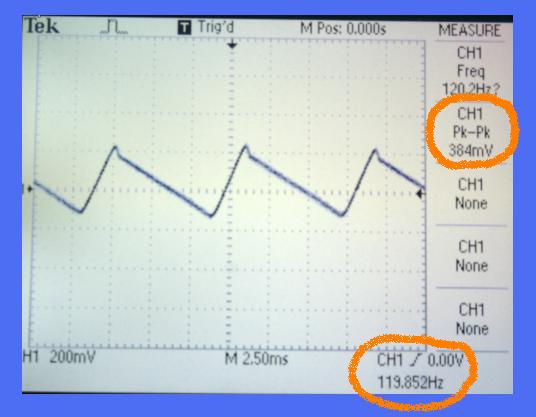

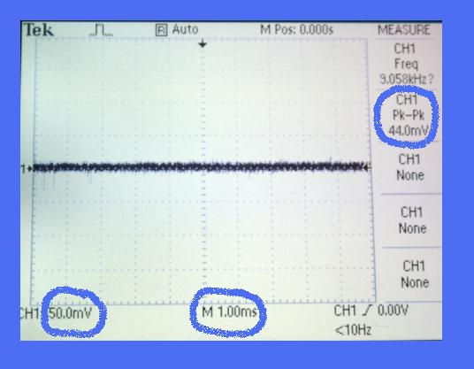

Babowana said:Then, I have also measured at the ouput of the series regulator, and found the pk-pk of about 40mV-60mV. But, I have read frequency . . . strange values only ???
I don't have a Tektronics scope, so I could be misreading the instrument. Is the last
screen shot saying that the vertical sensitivity is set to 500mV/division? If so, you
might want to set that to something like 10mV/div or 1mV/div (something more
sensitive) and see if the signal is still flat. In this case, flat is a good thing! The
non-flat part is your ripple and noise.
The ripple may be less than the resolution of your scope, and the frequency counter
in the scope might not be fed a strong enough signal to give an accurate reading.
If the vertical sensitivity is not enough to show us anything, then you can stop here.
If you can measure some ripple, then you might scan through the sweep rates to
see if you can detect 1 or more frequencies of ripple. If your scope has an FFT
capability, that might help identify the frequencies and magnitudes.
Or have I completely misunderstood your question?
Let me know how I can help,
Robert

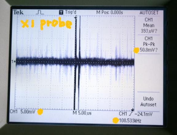

I have tried adjusting both V/div (down to 20mV/div) and Sec/div, but could not get any other curve than the flat shown . . .
Could be that my scope has not good enough resolution . . .
I have no idea what to do further . . .

Babowana said:I have tried adjusting both V/div (down to 20mV/div) and Sec/div, but could not get any other curve than the flat shown . . .
It may be the case that the voltage ripple is below the noise floor of your regulator. The scope is likely doing an FFT on the signal and finding no dominant frequency, so the fluctuations in pk-pk and frequency could be just noise.
Have you tried a small value film cap across the output?
In the rainy dark night, 4AM . . . I can't sleep well . . . . . .
I'm guessing that Sec/div means 1Sec/div. If I'm right, this would be way too
slow. You want a sweep time in the range of the frequency you are trying to
find. If your AC mains are at 60Hz, then you're probably interested in seeing
120Hz. 1/Freq will tell you the time of 1 cycle. 1/120 = .008333s or about 10ms.
If there is 120Hz signal, setting your horizontal sweep time to around 10ms/div
should show you about 1 cycle/div.
You may want to see fewer cycles to be able to focus or see more detail of
1 or a few cycles. You could increase your sweep rate to see higher frequencies
and fewer of the 120Hz cycles. Likewise, you could slow the sweep to see
lower frequencies.
Is this the kind of info you are wanting, or is this stuff you already know?
(I'm trying to learn how to help you.)
Following what Nelson said, you may have probes on your scope that have
a 1X/10X switch, and you are set at 10X. Or maybe you have a 10X probe,
and can buy a 1X probe. You may have a 1X/10X button on the scope too,
to set the right scale. In other words, you may be able to switch to 1X, and
be able to select a vertical sensitivity of 2mV/div (instead of 20mV/div).
Or Diomedian may be right, and you have reached the limit of what your
scope can do. Maybe you could call your Tektronics rep and see what
options are available to you?
I hope that helps,
Robert
Papa, yes, X1 probe get me down to 5mV/div.
Diomedian, yes, I put 1uF film cap across the output.
Robert, yes, it seems that it has reached the limit of what my
scope can do . . .
Thank you, for all . . .

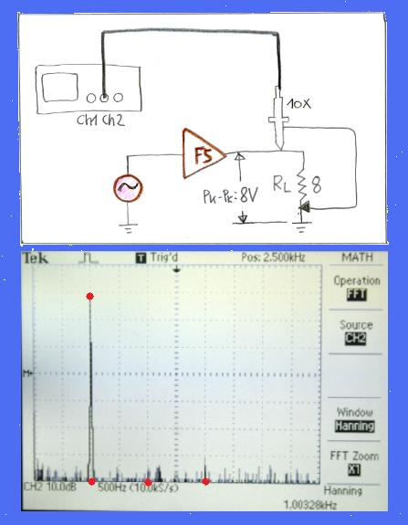

Babowana said:Before I have turned off my oscilloscope . . .
I have tried to measure the Math FFT mode at 1kHz of the amp's ouptput in thr first watt area.
I see neither 2nd harmonics nor 3rd harmonics clearly . . .

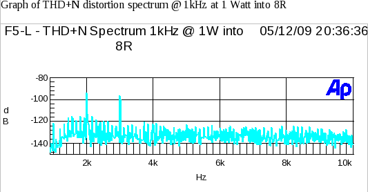

HI Babo,
You may need to notch filter the 1kHz input signal from the output before
measuring, to be able to more clearly see the harmonics. Here is a
graph of my F5 at 1kHz at 1W into 8 ohms. Like you, my F5 is not quite
what Nelson designed (because of what I had, not because I think I can
do a better than Nelson). Note the 1kHz input signal is filtered. Also, I'm
not sure what your vertical scale is, but you should be able to sum the
magnitudes of the harmonics (and other noise) to give the THD+N of your
amp.
Also, you might want to remove your input signal, short your input to ground,
and do your FFT at the output again, to see what is there with no input.
I posted a graph of this for my F5 and 400A in the 400A thread.

Hi Robert,
The set of your advice and info is clear and is of great help.
The vertical scale is 10dB/div. Again, my scope seems to be not good enough to cover some of my interests. I will try to remeasure the harmonics using the notch filter as you say. At present, however, I need to save available time and energy . . . So, it might take certain time . . .
