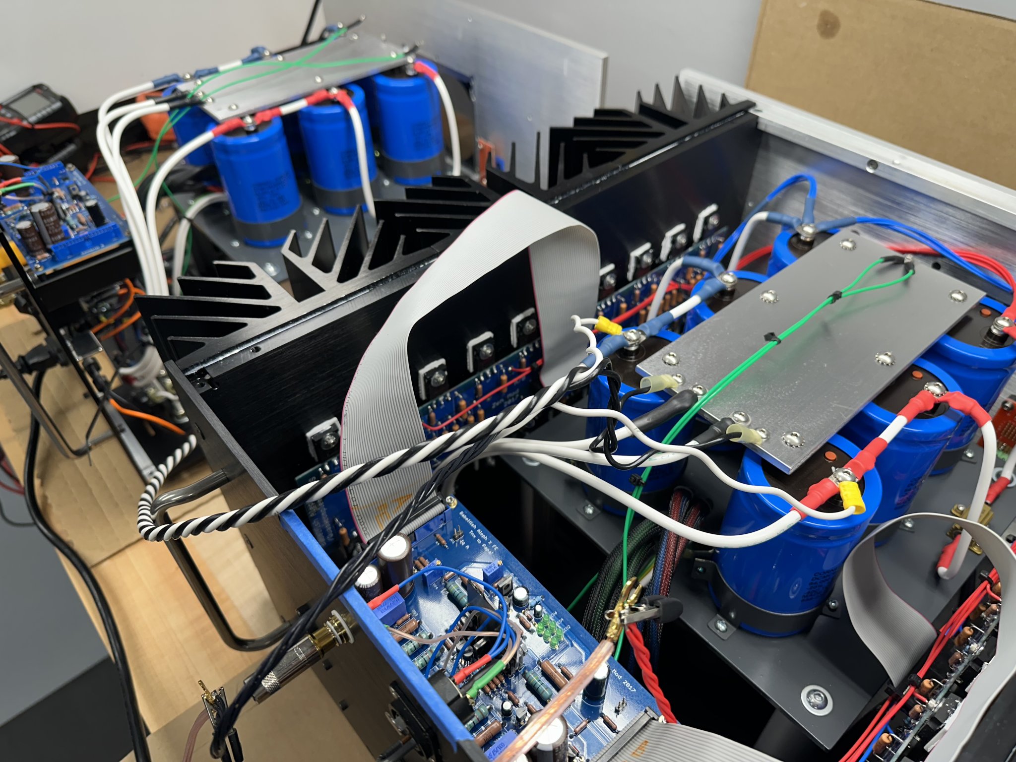

Test 1 - L AMP - Bolted everything up and rolled it over to the other side of the house and hooked it up to the theater/SLOB system, unfortunately no luck, still hums (xfmr and spkr) as before. Made sure no lights, etc. were on throughout house, unfortunately made no difference.
Test 2 - R AMP - Put the Saligny bridges back in and measured for a snubber while things were apart. Hooked up the R AMP bridge output in parallel with the L AMP Cap Bank (R AMP Cap Bank disconnected). Fired up R AMP and speaker/transformer hummed as before. Fired up L AMP and the speaker hum doubled in volume. Transformer hum essentially went away.

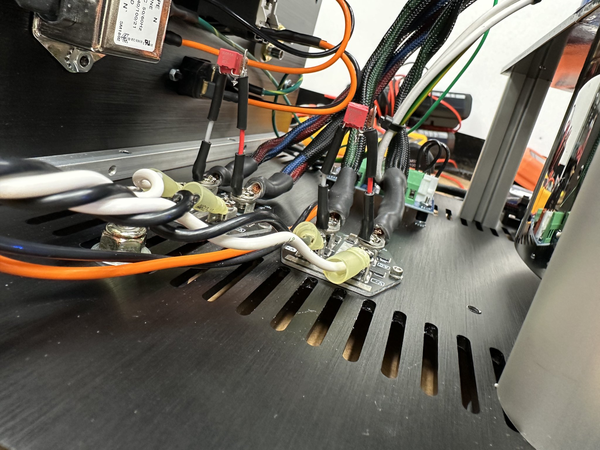

Observation, not sure if it makes sense, but when the FE is connected through the ground wire to the ground plate the Neg Rail of the power supply shows continuity with ground.
it does not make sense, at all!!
disconnect said wire from GND, check gnd pad/trace on FE pcb for continuity against neg rail on same pcb

hope you have all elements of chassis, even if dismantled, in some way connected all to safety gnd - if nothing else - with pieces of wire bolted temporarily to each plate/heatsink/bottom

3 - Yes this is all on the amp that is all bolted up with all sides on at this point, only missing top cover.

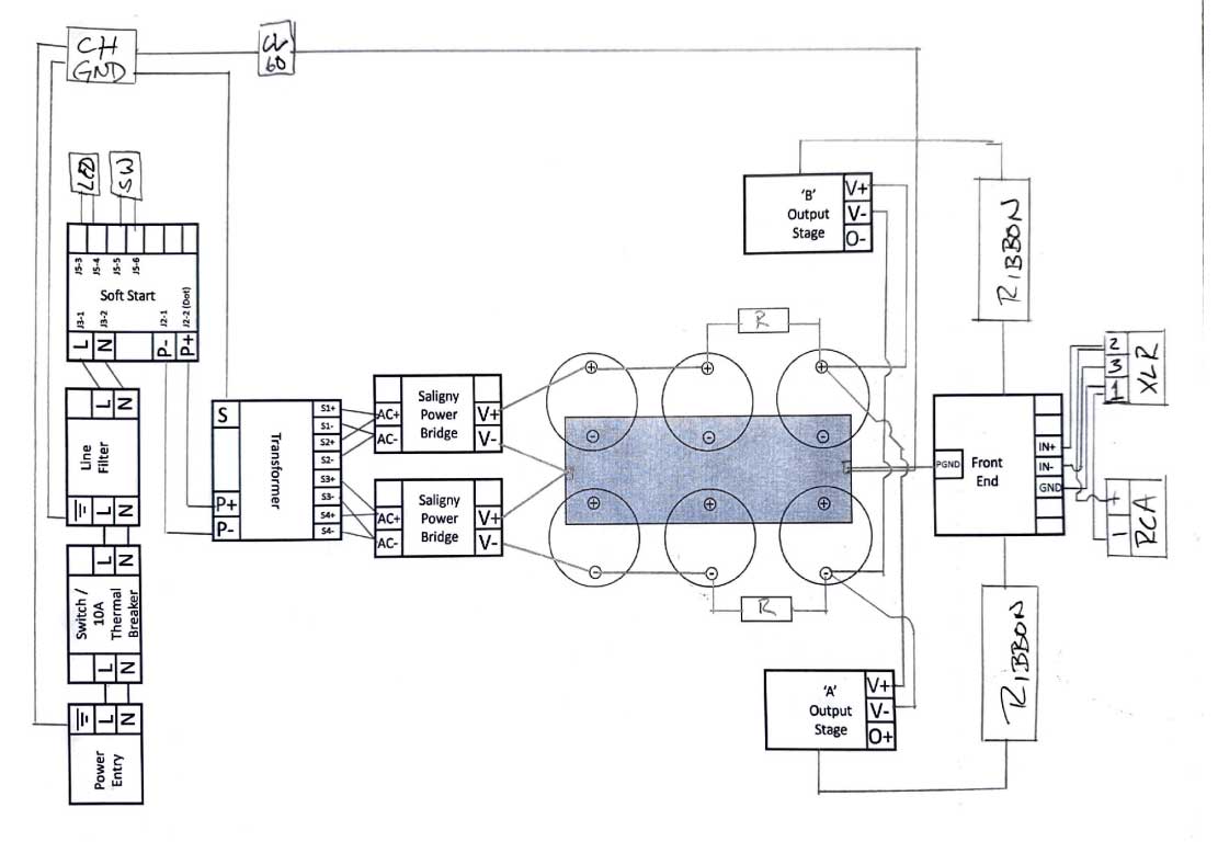

I'm newbie here and follow this post as I built something remotely similar in the past.
Might be i missed something, did you post complete wiring diagram somewhere?
Another question; is it typical mains introduced buzz(50-60hz - 100-120hz buzzzzzz) or electronic noise (hummmmmm) here is written about both, not sure what's problem?
Normally fully balanced things shouldn't suffer hardly from ground buzzz. However in original circuit I see few things in DC servo connected to "ground", where that "ground" goes?

Took a breather for a while and set this aside. Plugged them back in today and no miracles have transpired in the past couple weeks. We are still buzzing. Drazen - Took your advice and drew out the wiring, attached. Nothing jumped out at me, but open to critiques and recommendations as always.
- Babelfish XJ , or JX …….. or whatever (Aleph X servo for Greedy Boyz)
