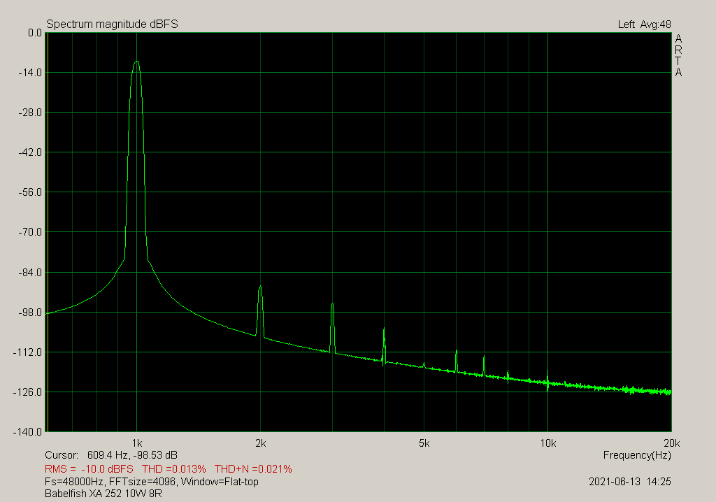

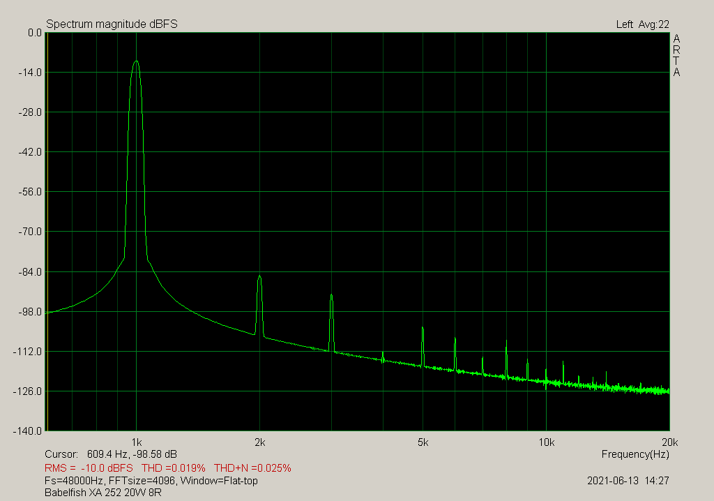

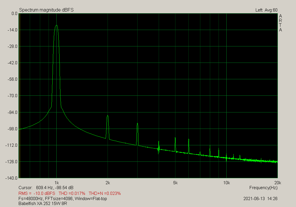

Babelfish XA252 SIT - graphs , 8R load, BFR=22R

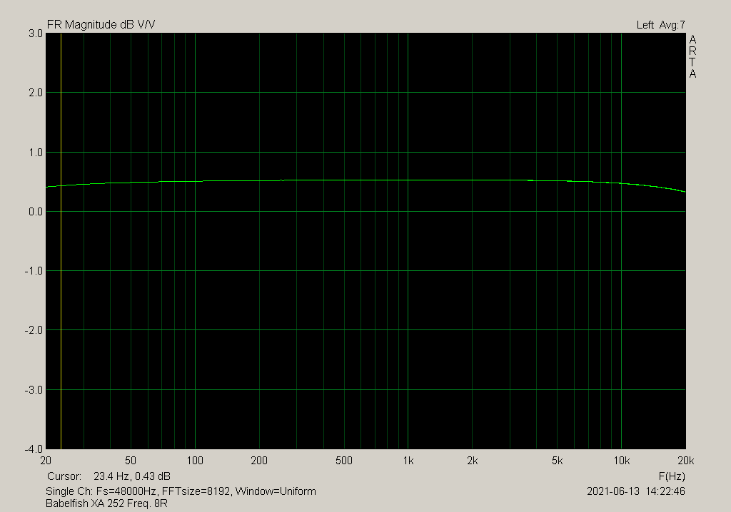

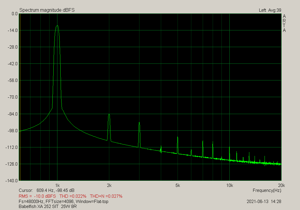

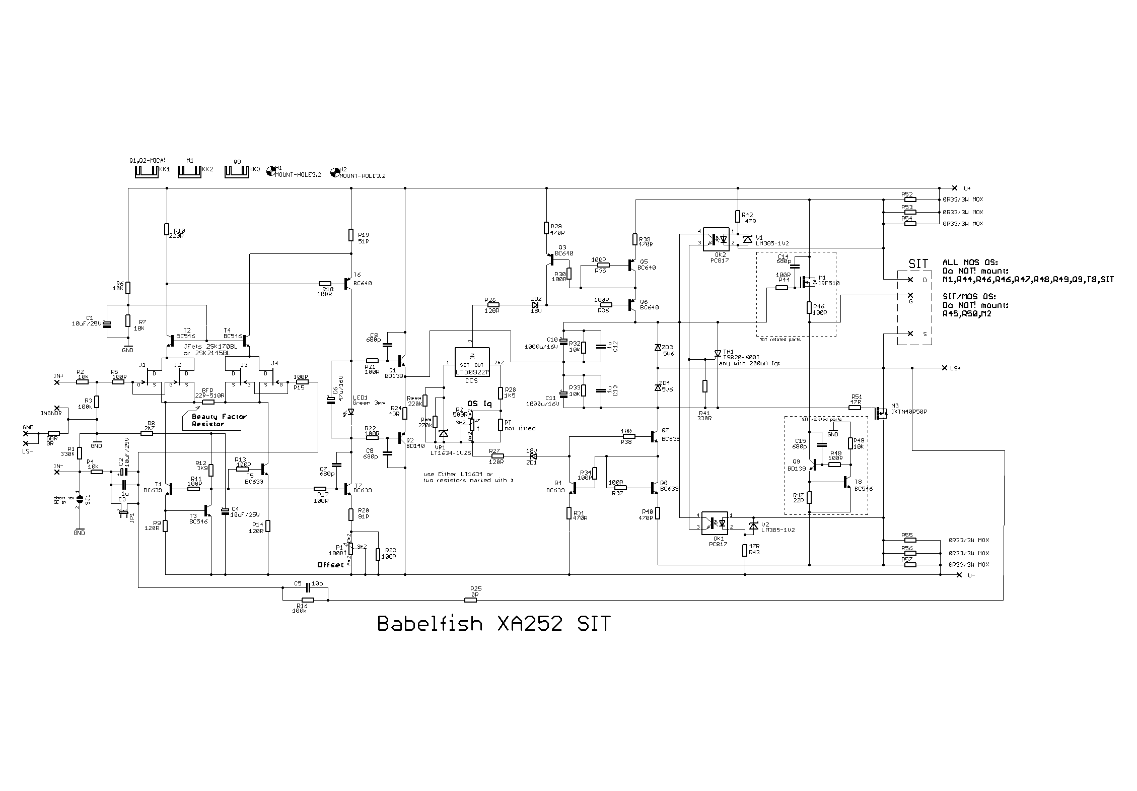

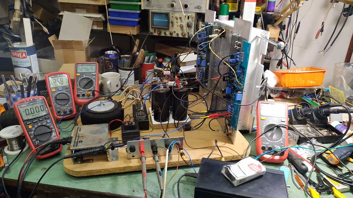

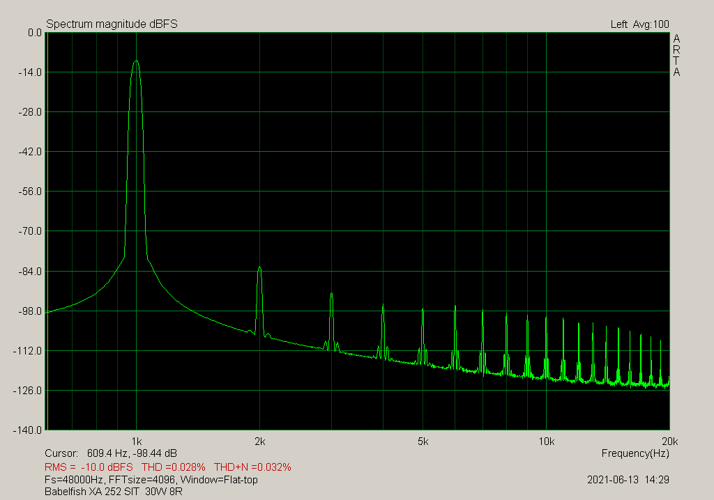

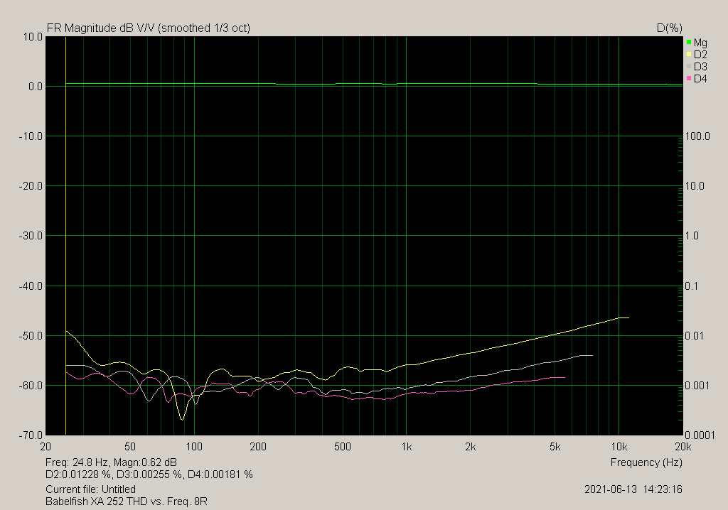

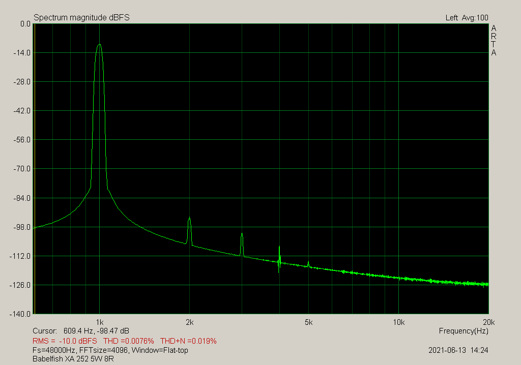

Today I had time just for first battery of tests, with BFR value of 22R
Happy Camper, will be even more campier tomorrow, after all tests and some mooooosic time
everything as before (rails 30Vdc, Iq 1A7), I've just mount necessary parts for SIT iteration and changed upper mosfet for THF51
as of recently - Ugs value of SIT is irrelevant, it's just niiiiiice to have them so-so matched by Ugs
graphs going up to 30W, at greater levels than 30W - Opto+Thyristor current limiter kicked in and entire OS gone Dodo ; obviously DEF specific current distribution of parts is putting heavy burden on Mosfet and I need to investigate how much I can increase protection treshold, without risk
I will also think of ways - maaaaaybe - how to slighlty increase power output ........ I don't want to change even a iota of natural DEF behavior, so I need to see how much exactly juice is going through Mosfet dynamically, and to accordingly declare new Iq point for that
rails are OK, 30 as is, 35 if one want to squeeze as much watts is sane from this amp
more to come these days about that

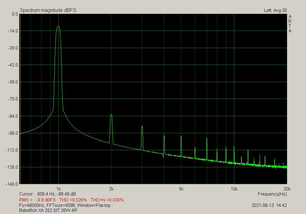

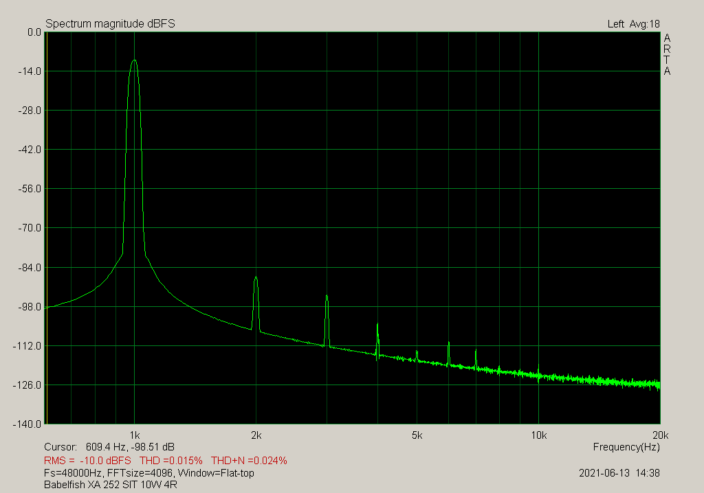

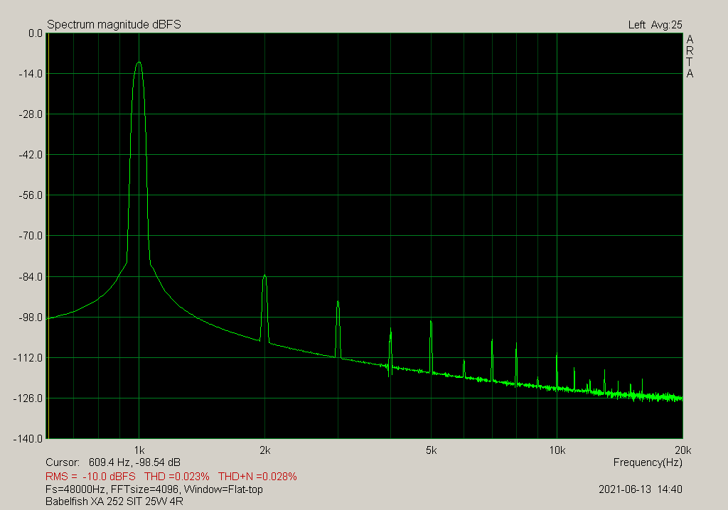

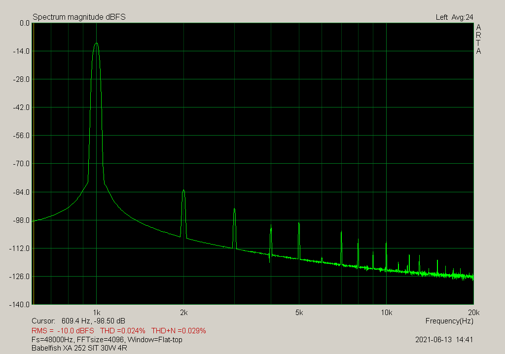

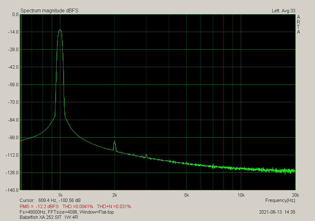

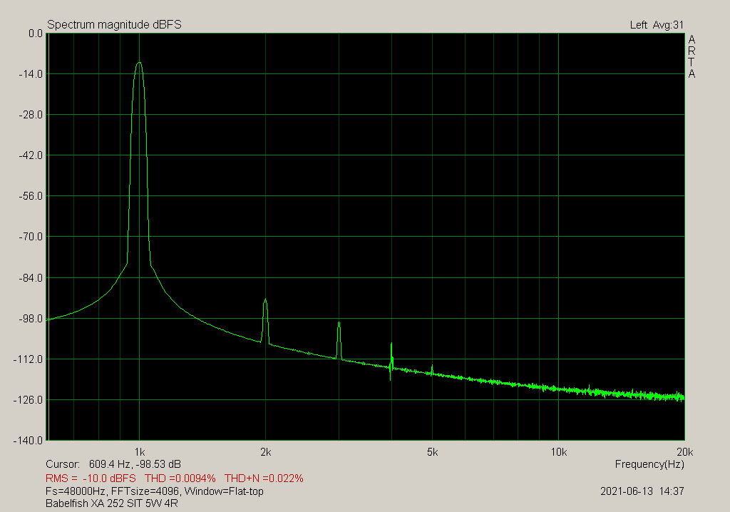

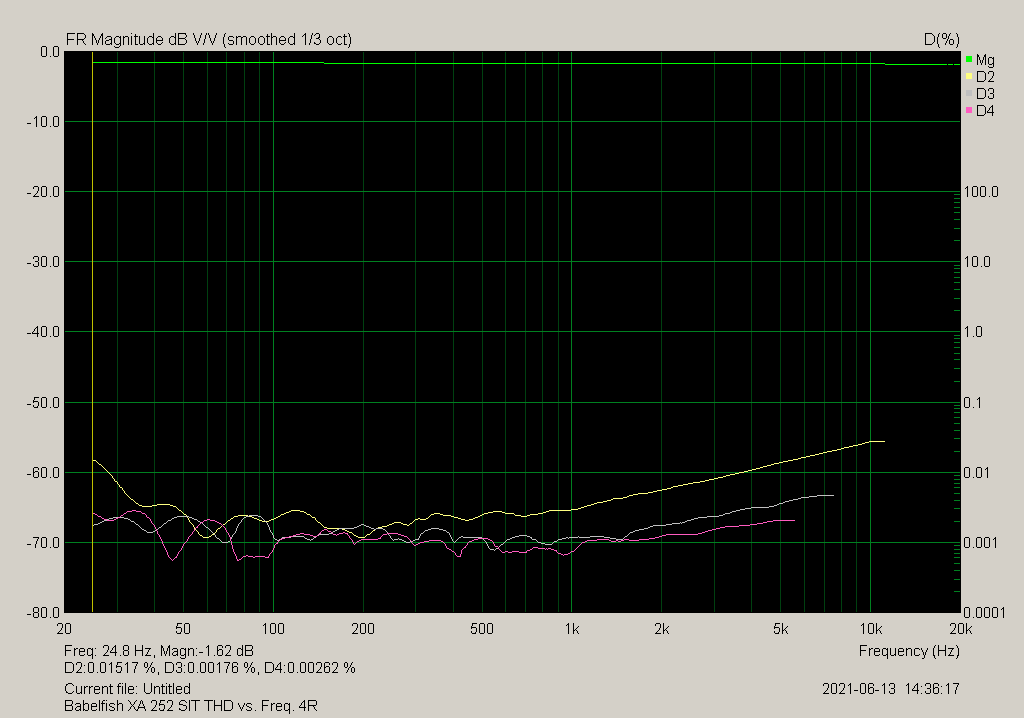

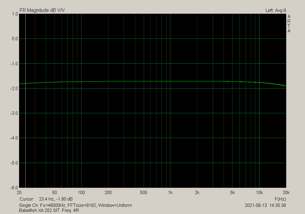

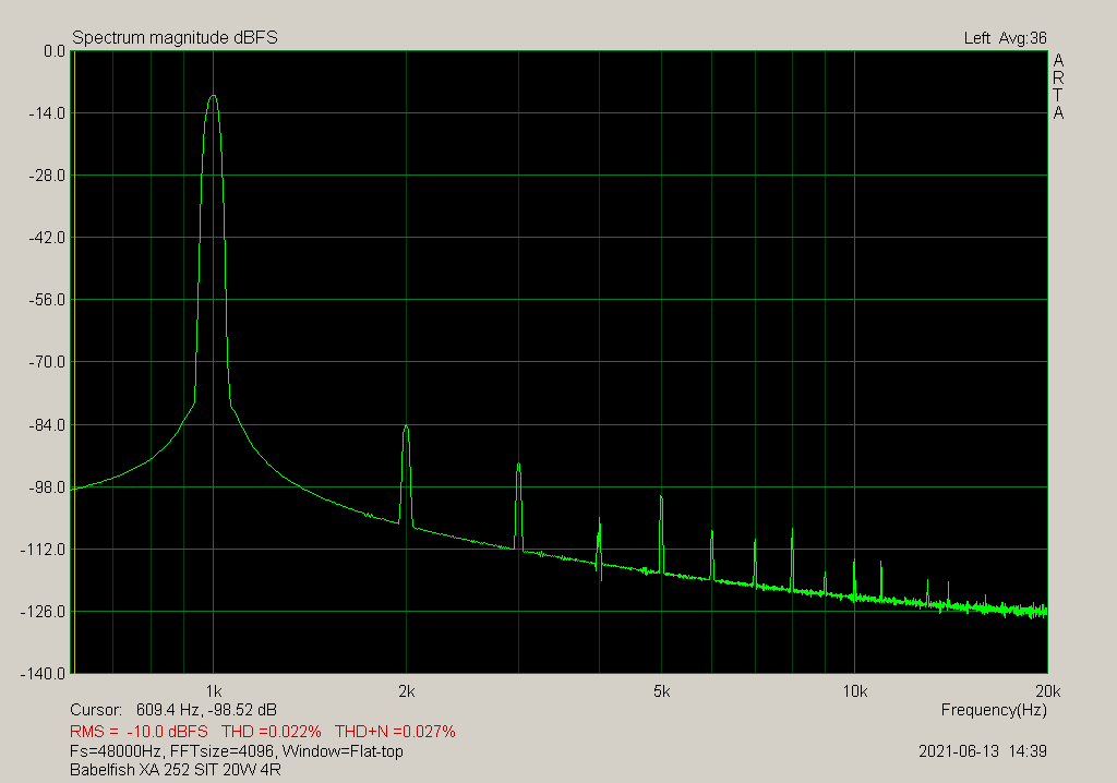

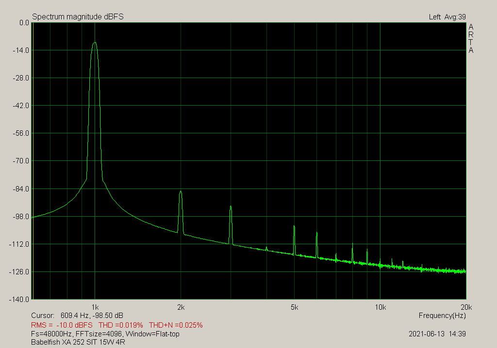

Babelfish XA252 SIT - graphs , 4R load, BFR=22R
everything same, load changed to 4R
half of graphs in this post

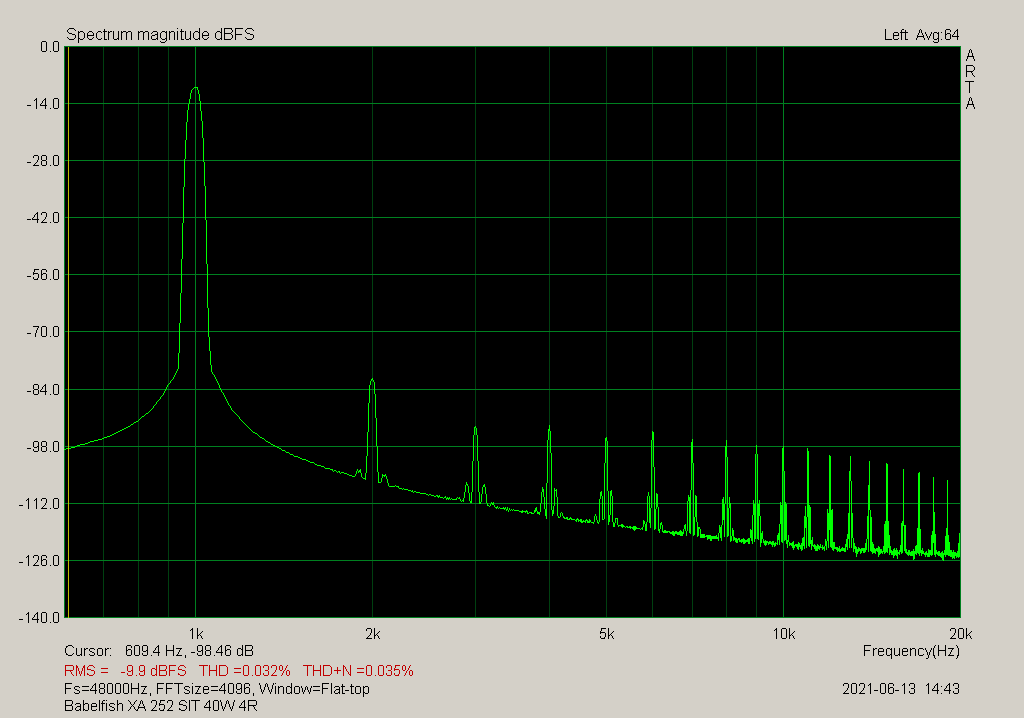

second half of graphs
have a nice Sunday .......... I'm certainly having
Will there be an autoformer version? EDIT I now see that there is. EDIT again - I too quickly read sit for SET.

graphs going up to 30W, at greater levels than 30W - Opto+Thyristor current limiter kicked in and entire OS gone Dodo.....
did I said (yes, I did!) - Opto+Thyristor limiting/protection circuit is blatantly stolen from Pa

Thank you. How could I have missed these? I guess I blinked. The SIT adds character (more 2d harmonic).
Zen Mod, please do you expect a big difference in distortion at higher frequencies between the two devices? I saw your frequency sweep but am wondering if the SIT geometry offers any advantage up there when pushed. (Probably not given they are both large devices but who knows...)
