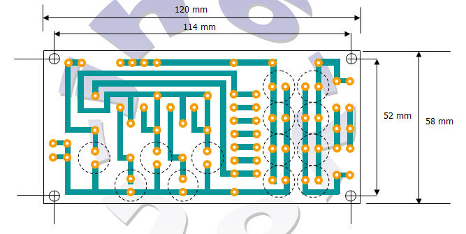

Nice boards, Choky. Looking forward to hear about how they sound.last blur

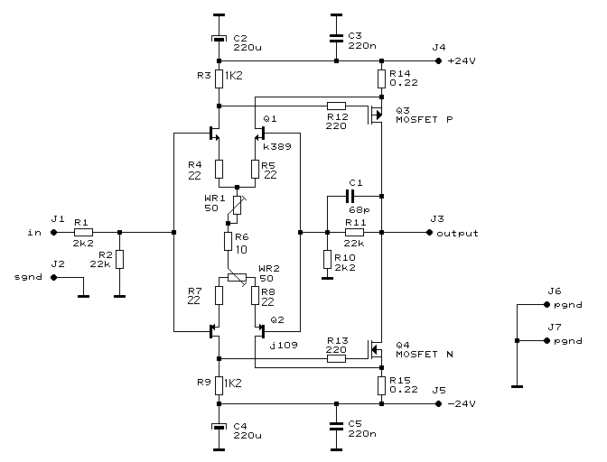

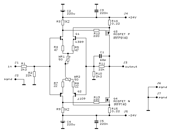

there it is -schematic -working version ;
pretty stable,without any pop or plop during powering up or shutting down;
DC offset -typical for so simple schematics -starting from cold with less than 200 mVdc,and then decreasing to o Volts ,and staying there;
didn't checked anything with CRO,but-who cares
PS is twice 25V ,Iq 2A (~4V4 on gates of output mosfets)
sound : very nice!
I have not opportunity in this moment to compare it with Babelfish Aleph J,but -from memory -Babelfish is somewhat more authoritative ;
I expect some logical differences when I make both of them in final boxes etc - Oly's Mini is strictly symmetric and Babelfish J is (still ,hehe) SE........ya know all that stuff about even and odd harmonics........
anyway- who cares-it sings!
Oly is magician with PCBs ,and I must admit - he study very well work of his favorite Audio Grand Pa Borbely
ps. this little amp is somewhat leaned on some Frenchy amps ,but i think that must be more stable than ,say,Profet or similar one

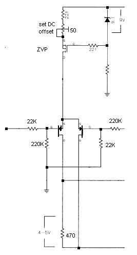

Hello all,
After converting my Aleph 3 to the babelfish version, I am frustrated. Maybe I have some trouble shooting you could help with.
I converted my Aleph 3 to this babelfish version using the j176 jfets.
Does anyone know are the j176 better or worse than the 2sj109's?
I noticed the data sheets show the j176 has lower capacitance, so in theory should be better for high frequency?
The j176 sounded nice, but I noticed my previous zvp3310a Aleph 3 version with the standard zener regulator, seemed to sound like the upper frequencies were better than this j176. I checked the AC current gain and made sure the DC offset with the j176 was below 100mV. Could I change the 33.1K ohm value to say 25 or 26K ohm? Would that help for the current source?
It seemed like my zvp3310a directly substituted in place of the irf9610 sounded better or more sweeter compared to my j176.
Why would this be? I went with this j176 hoping I could bias it close to 20 mA for the current source and not need to parallel any jfets. This did work fine. It handled the power, but still did not sound as musical as my zvp3310a. I am running the output mosfet very hard, because the bias resister to the outputs was removed biasing the mpsa18s as hard as they will drive.
Has anyone else tried any other jfets other than the 2sj109?
Why would the zvp3310a with 50 pF sound better in the upper frequencies than this j176 with 8 or 30 pF?
I thought zeners were supposed to be noisy and thought the resister current source should be cleaner sounding than a zener. Maybe because the resister current source does not regulate as well as a Zener could be the problem?
Other observations:
I have also noticed the Zener regulator stabilizes much faster in a couple of seconds, compared to this resister current source, which takes up to a minute or longer to go below 100mV. Sometimes when it was first running it took 5 to 6 minutes to stabilize below 100 mV.
Also the jfets are very sensitive to air currents. I ended up using a heatsink for the j176 to keep the current source jfet from drifting too much. The differential LTP were not as sensitive to drift compared to the j176 current jfet.
It took about 5 or 6 hours of adjusting the circuit and moving fans away from the jfet to solve the dc offset drifting problem.
I used a 1Kohm pot instead of the 47 ohm resister with 47 ohm pot. Could that be the problem if this 1Kohm pot was in place of the 47 ohm and 47 ohm pot?
Do I still need a 1Kohm resister after the j176 current source between the LTP as in the choky schematic? Could that be the problem or is simply the j176 not as musical as my zvp3310a?
Regards, Bill

BillWW:
First thing-you must post drawing of your input stage to make clear to me what you wrote;
I understand that you use 2 x 2SJ176 in LTP
but-I do not understand how you make CCS for LTP - as in mine Babelfish or as in Aleph ,but with 2SJ176 instead of IRF ?
in any case,you mentioned 33K,so I still resume that you made CCS with two bjts....
in that case-changing 33K to lower may help but just a little,because temperature drift,at least for my knowledge ,is not problem here for CCS but for LTP himself.
CCS have pretty good tempco,if you couple these two bjts thermally (face to face with some white goo
also-because you use two solo Jfets in LTP,they also must be coupled.
difference in highs between zvp and jfet version must be from LTP drive (un)capability of output mosfet's capacity;
like you can see-NP uses in Aleph J two pairs of output mosfets,same as in A3
I use just one pair of IRFP150N,strictly from input capacitance issues
just one thing-from top of my head-J176 isn't intended for audio applications? choppers etc is primary use for it....
anyway-why you don't use same CCS for LTP as in your zvp version and just set needed current through LTP ? in that case you'll hear exact difference in LTPs,not CCSs....
1K2 on top of LTP is just to decrease power dissipation in CCS,nothing else-you can try without it
also-using 1K pot instead 47 will give you more drift in resistance during warming up
just one addendum-I didn't make any "usual" or "common" Aleph before,neither I have opportunity to hear one,so I can make my conclusions just from my Babelfish
I also have no clue how far is from NP's Aleph J
intentionally I didn't say "close"
I still see some drawbacks in Babelfish,but .....

if you look closely on Babelfish schematic,you can see that I use two BJTs in CCS; you can't put there zvp or J176 ;
what you can is just on little schmtc attached to this post; it's easiest and fastest way to try J176 Jfets in any Aleph iteration.
besides-game with zvp ....you don't need to change anything in CCS ,just leave old good IRF;CCS is CCS,and few needed qualities are stability and lack of noise ; I have doubts that zvp works better than IRF there,and especially J176-even with proper CCS adjusting
you must alter 390 Ohms resistor in leg of first LTP fet to some 470 ohms,just to decrease dissipation in that little JFet critter....
try it like these,and then write what you hear
besides-as you can see in attachements in next few posts (one attach/post) is that J176 and 2SJ176 are entirely different animals...
try this ,then come again with questions
