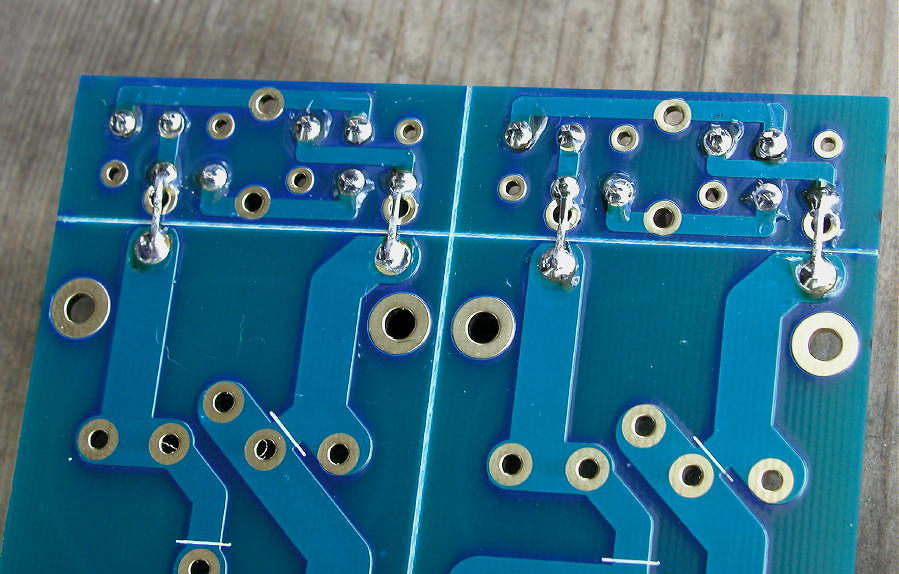

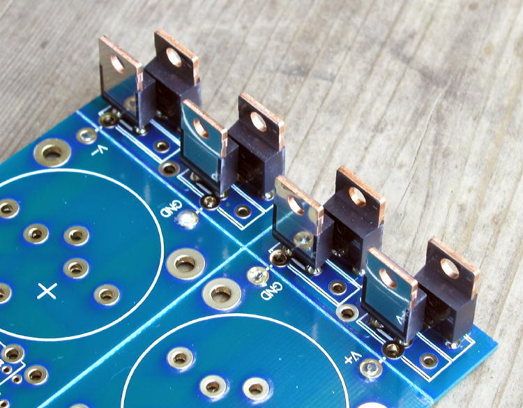

I have some 1n400x diodes.
Used screen-shots of the board from PS thread. I've built with these boards and diodes before. Just made another board for a XO.
Only difference is the Linear Technologies regs.
I wonder if I messed up the bridging between the to-220 diodes...?
They require jumpers.

Yeah, I think I messed up the placement.
Did you see the larger diodes have a jumper across?

Wait, doesn't apply because the to-220 plug in differently. The pins are closer, so the go into the board differently.

The Linear Technologies based power supply is good. I must have wired the transformer wrong somehow.

OK, I wired the toroid secondaries wrong. They are in pairs of green/blue. I picked the wrong pairs.
A simple measurement of the windings would have revealed the pair I picked had infininate resistance.
The correct pair had 1.5 ohm resistance.

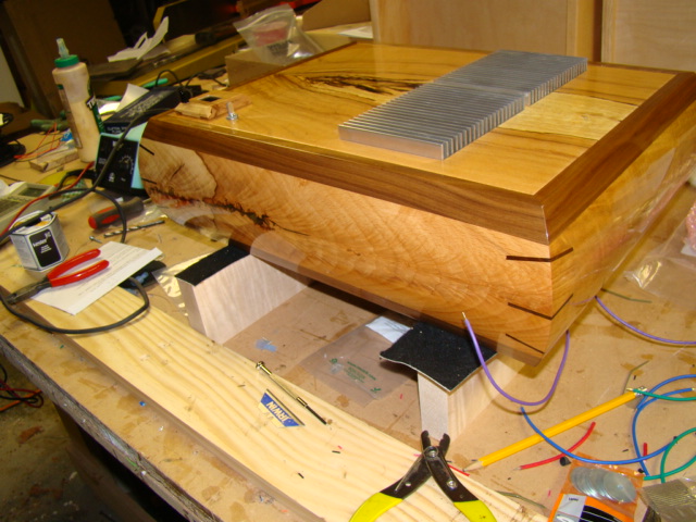

In a quest to tidy up my system and make it more user friendly I have decided to put my balanced ba3 front ends into their own enclosure. I enclosed a pic of the case.
My question is if I run the front end at 30vdc do I need to upgrade the ecaps that are part of the bias board from 25v rated parts. The output stage will still run at 20vdc. I would guess that I do, but hate unsoldering resoldering if I don't have to.

Thanks Zen Mod. For better or worse I know more about woodworking then electronics.
What do you think about the electrolytic caps in the bias boards...do they need to be rated for the voltage of the front end, or is it ok to rate them for the amp? 25 volt caps. amp runs on 20vdc and the front end will be about 30 volts when it goes into the new chassis.
Thanks, Evan
