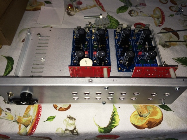

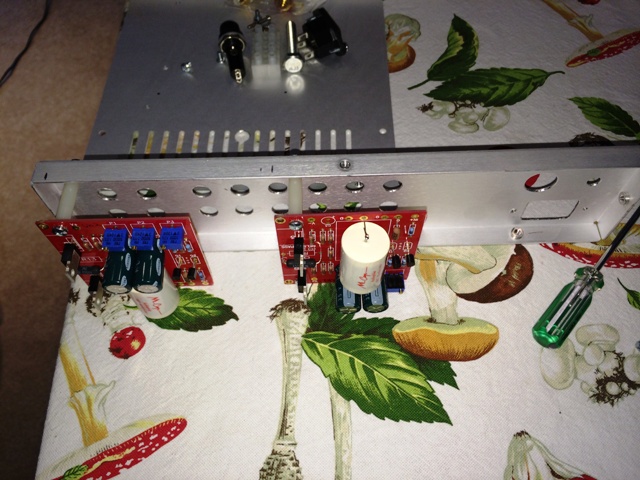

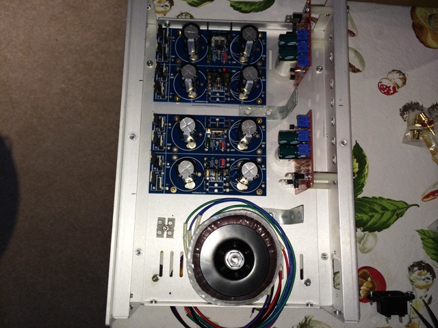

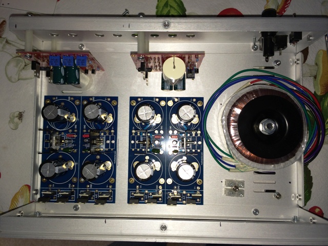

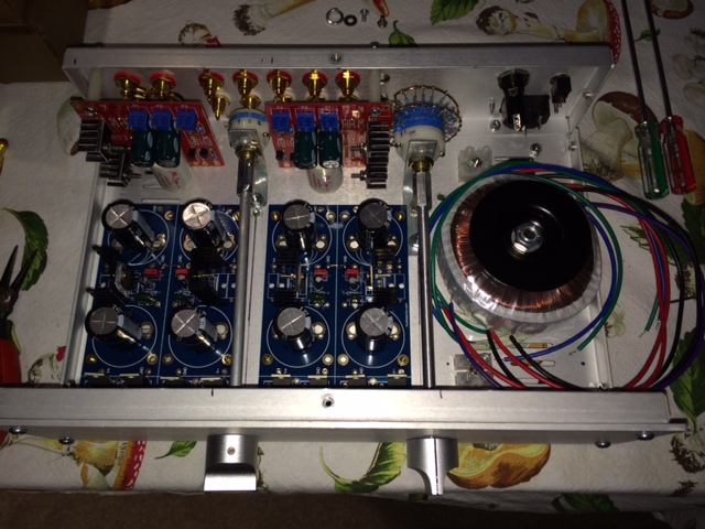

just noticed that servo. getting pretty handy with LT sPice. That's cheating.only for amusement BBA-3 with F5 feedback…..
Nice, you have separated the boards and dual mono PSU, for better channel separation?
Yes.

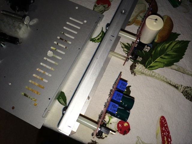

I have to be honest, I don't know how much of an audible difference there will be by extending the volume and input contol to the back of the case. It does keep the wiring away from the transformer and power supply, but is it worth it for a few inches worth of wire? I'm not convinced. If every inch counts then maybe it's worth it.
BTW- if anyone is interested, the shaft coupler is just a threaded rod extender from a hardware store. It cost a $1 for 3 of them. Just drill out the threading to fit a 1/4" dia aluminum rod. Used two set screws to join selector and volume to the rods. 4 set screws per coupler would have been better. More secure. It helps if you have tapping tools and a drill press vise.
Thought someone might find this useful.
