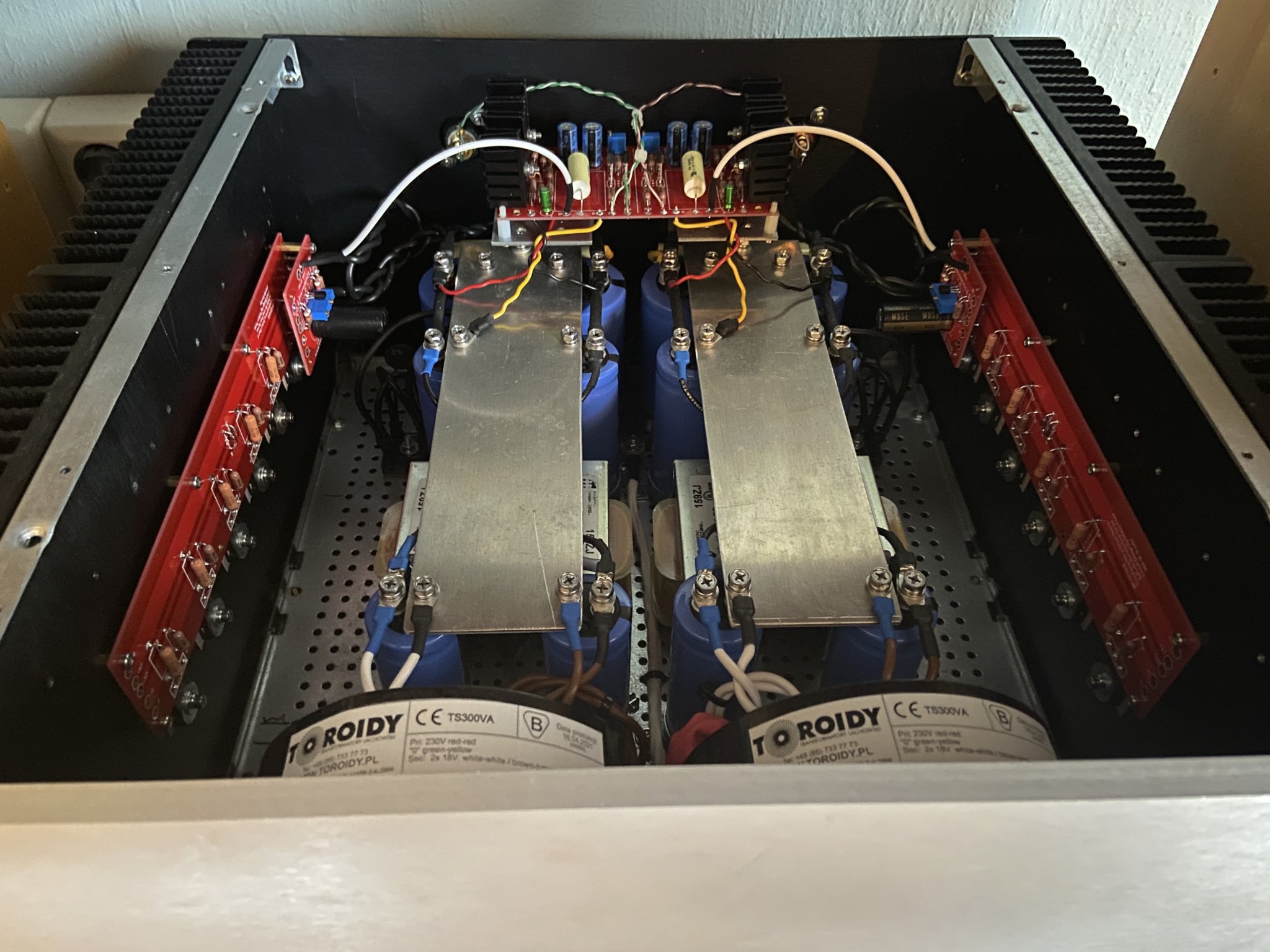

BA3 PP OS in common source mode, having drain as the output. 🙏I got lost. What is @wengtech trying to accomplish?
The BA-1 / BA-2 / BA-3 thing is maybe a little confusing. With the Burning Amp series, you basically had two front end options, a "typical" LTP w/FB, and one without FB. Then you have two back end options, i.e. output stages. One is single-ended, one is push-pull. The idea was to be able to mix and match the FE and OS options as you see fit. Read the articles for clarity. The First Watt F4 is basically the push-pull OS with a buffer stuck on the front of it, that makes it easy to drive with about anything (buffer has high input impedance). But the "front end" of an F4 is whatever you put in front of it, and you make sure that it (preamp whatever) has enough gain and voltage swing to meet your needs.
ok, but what is this accomplishing? What's the final goal? This specific design or certain performance numbers?BA3 PP OS in common source mode, having drain as the output. 🙏
Papa sez 10 mA in the BA3 article.
"These JFETs were chosen at Idss
figures of 10 mA (Idss is the current that flows when the Gate and Source are at the same
voltage). If you get lower values, you may want to consider higher values for P1 and P2, say
1 Kohm. They are best matched, but P3 can be adjusted to compensate for some mismatch."
I went with these and I am happy.
- BA-3 Amplifier illustrated build guide
