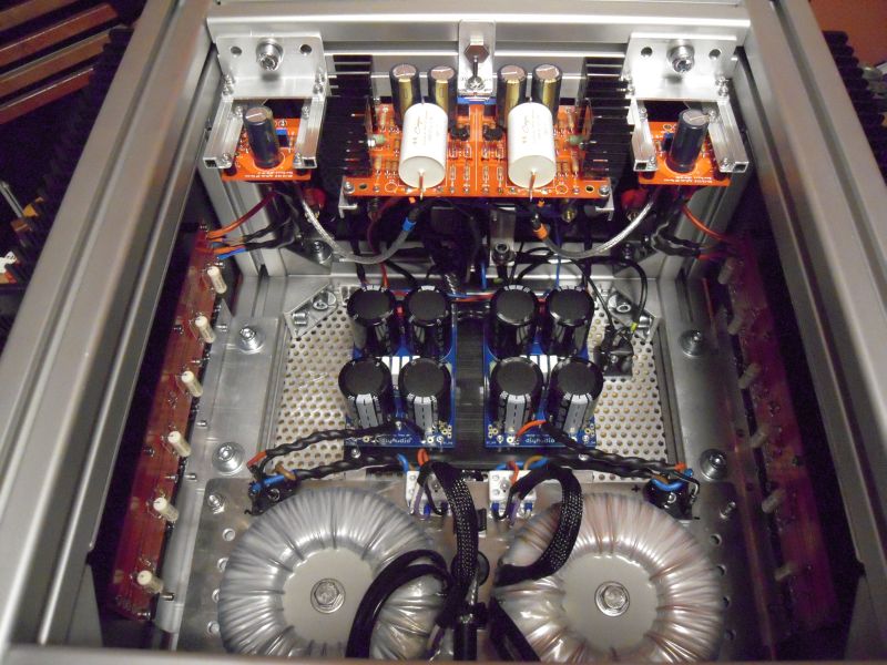

This is a pic, how I arranged the pcbs in one of my BA-3 amps.
One possibility. You can go many different ways.
I put the small bias -boards on top to have easy access to the trimpots.
My wires are circa 15cm long. I have no problems with noise. ;)
But I don't use horn-speakers with extreme sensitivity. My speakers are
91dB/W/m.
Greets
Dirk

A beautiful build. Truly! I am actually going to lay it out in generally the same manner, sans all the fancy and beautiful details =) I might also put the bias boards side by side the FE. And I am awaiting riser panels to mount the FE atop the PSU.
