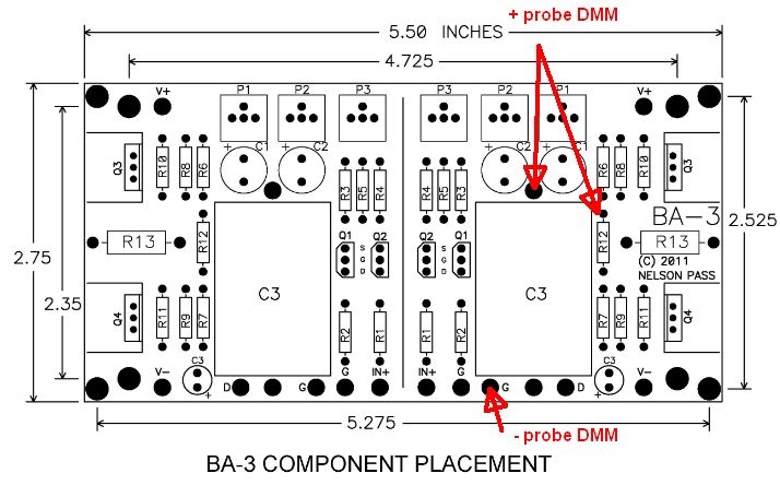

Hi all, I'm working on the ba-3 front end and have a biasing/setup question.
Everything appears normal, adjusting p1 and p2 change voltage across r10 and r11 and I can get those values matched with careful screwdrivering. My issue is that I cannot measure any voltage at all across r12. Even measuring in tenths of mVs, I get zero dc on the offset. Any ideas about what might be amiss?

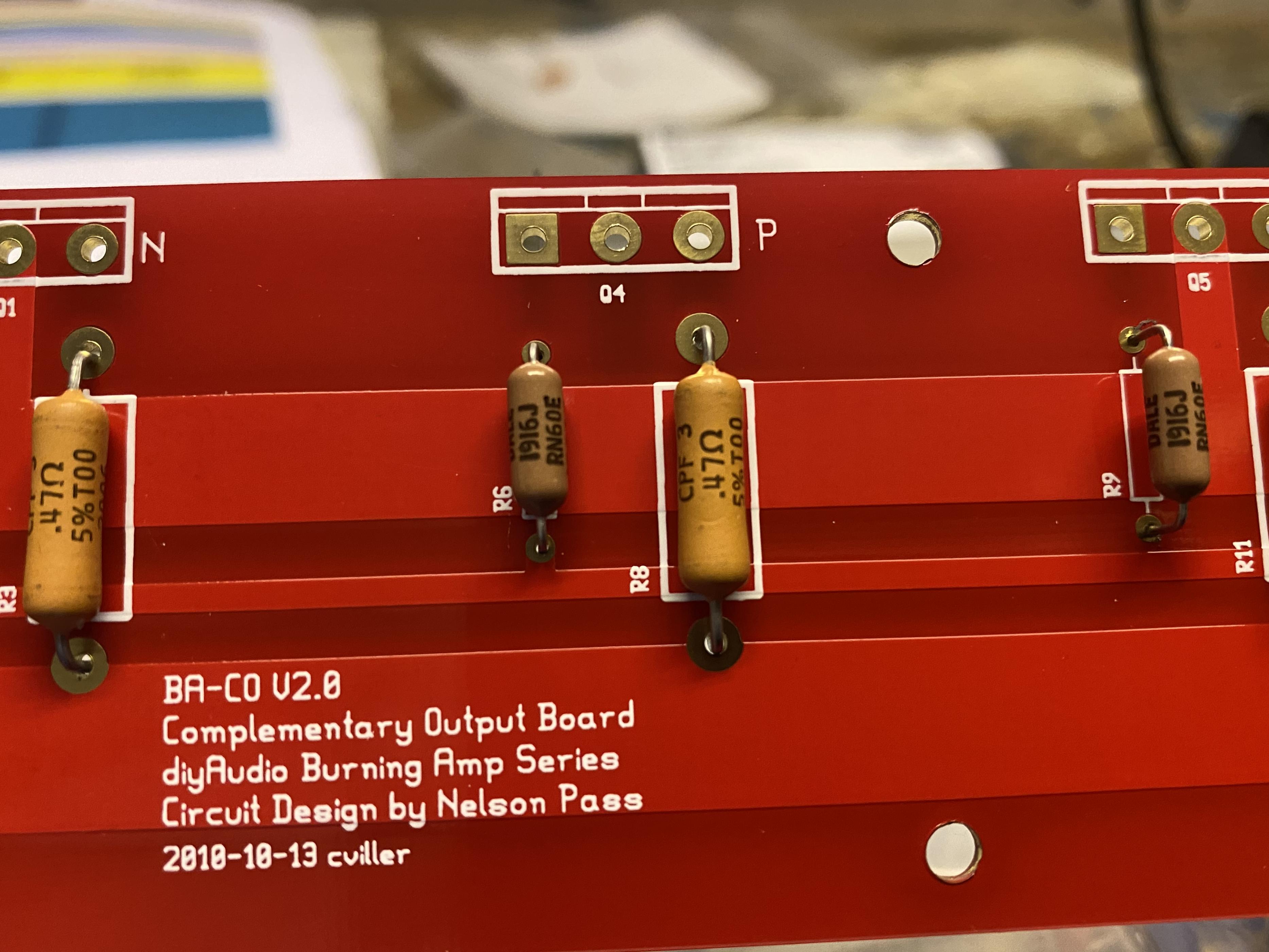

Please note that the PCB for each channel has only three N and three P channel mosfets
(unlike the original schematics, which has six of each). I would go with 0.47 ohm
source resistors (basically like the F4 without the front end jfets).
Thanks for the advice! I was thinking the same thing. But I just ordered the last bits from Mouser. Left out the 0,47 ohms for source, but how about using the specced 1 ohms to begin with, and see how that goes? Reducing source resistance when everything works, could be a cool test. Also, I have an identical spare PSU for the same purpose: when everything works and I it has been going stable for a while, I might det it up as dual mono.

I looked at the ba-3 as pre-amp thread and saw alternative instructions to test offset between r12 and ground. That worked for me...
to cal3713 #344
Hello cal3713,
if you want to measure your offset (while adjusting P1 / P2), then put + probe of DMM at R12 or C3 (inputside!) and black probe to G (ground) on BA-3 FE-pcb.
Check pic.
Greets
Dirk
p.s.. You don't measure the voltage over R12

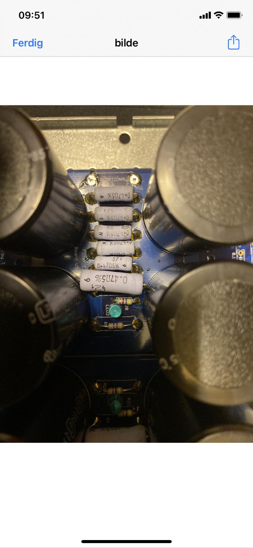

Or de-soldering, for that matter. This picture is from the PSU. I originally bought a failed F5T project, but it will now become a BA-3. as you can see, some strange choices have been made. Notice the extra big 0,47R resistors touching the caps. Also notice the bleeder resistors are of the none fireproof type, as far as I can tell. And the soldering work is not very successful IMO.
Makes me wonder if the PSU at some point was the reason for my predecessors failed project.
So I decided to redo the PSU, leaving only the caps. Those were installed by someone more competent than the original project owners. Only question now is, will I be able to do it better?
I hope so.
Still not decided whether to remove the caps IOT clean up the mess on the PCB. Guess I might have to.
Thanks a bunch for the advice!
I built with 1 ohm, the amp is wonderful. I would like to change to .47, but I just always hate "working on" an amp that works perfectly. If I were building it today, I would likely use .47 and closely match the mosfets. I doubt there is much improvement with .47 over 1 ohm, maybe. 1 ohm ought to give more protection from current hogging between output devices I suppose?

I believe I even saw a Nelson amp with MOSFETs cabled to the output stage. Then again, my memory might not serve me right. On second thought I might be wrong. Or maybe it was some test peoject in the works.
Russellc
Thanks, Russel! Also for your PMs on the subject. I checked Nelsons BA-2 article, and in thr end decided to go for 0,47 source resistors. Nelson does not say that you MUST reduce source resistance with less than 6 pairs of MOSFETs. However he suggests it be reduced in proportion, and says it might be the best choice. So half as many transistors as the original 6 pir BA-3, equals 0,5 ohm source resistors. So I went for 0,47. Bought CPFs from Vishay, and the same kind of MILSPEC Vishay RNs that 6L6 used. My first PCB soldering job complete, and only MOSFETs left to do on the output boards.
