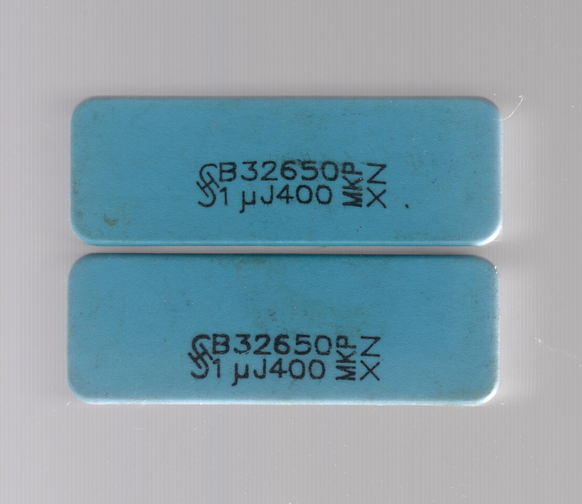

Anyone any views on the Siemens 1uF 400V MKP.
Would it be a better choice then the WIMA 1uF 400V MKS4 ?
Or should I go for the WIMA 1uF 400V MKP4 ?
I've got other MKP caps but they are of dubious origin.
I've also got a pair of WIMA 3.3uF 750V MKP4 but they are considerably bigger.

Well based on the general view that polypropylene is better than polyester I would say any of those would be a better choice than the wima MKS4 which is a PET cap.
Personally I just check the datasheet for the caps I'm interested in, and if the specs are similar I buy based on price and availability :)
Tony.

The Polyprops at the input have CERTAINLY brightened up the amp as I am trying to do.
I used the Siemens as posted in #424 because they were the right type and fit the PCB.
Just waiting for the Obbligato PIOs to replace the 2 x 4.7uF Metalised Film at the outputs. They should be here on Monday.
Any sceptics that think that caps don't make a difference - In this instance they do.

Nelson's B1 does specify MKPs as the input caps. Now I have (OK slightly different) MKPs at the input, my B1 is starting to sound like I would expect it to.
