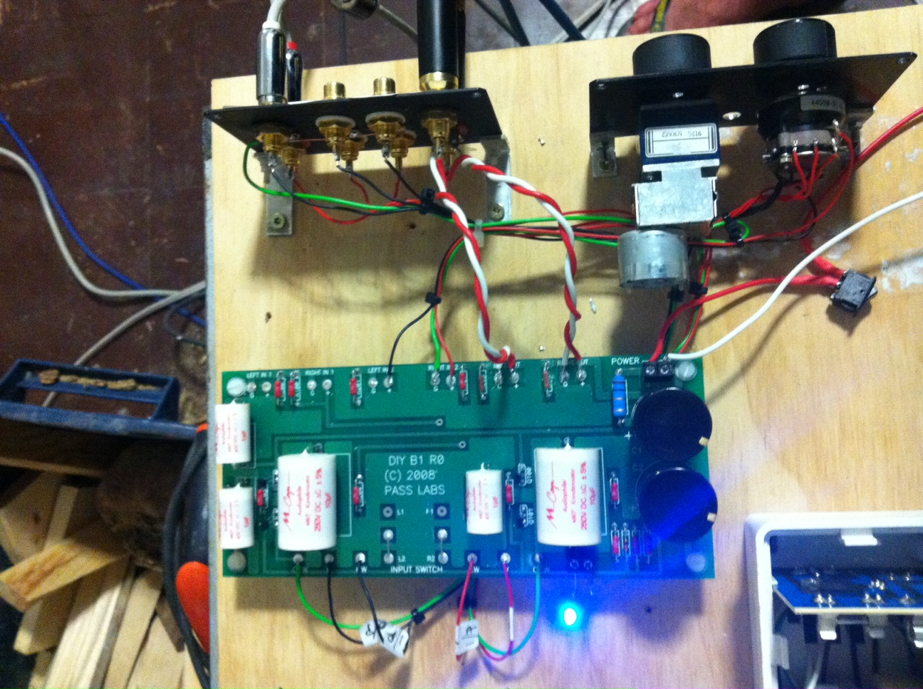

post238, correctly shoows the wiring of more than 2channels through to the B! input.
Note however, that the ground wire from the input sockets must follow the exact same route as the 3 Hot inputs, then pass close by the selector switch and again follow exactly the Hot line to the B1 input pad. This is to minimise the loop area of the inputs that the B1 will read and pass on to the next stage.
Ok , the selector between RCA input and board , board to Pot , pot to board ,then to output ?
left to one side of selector , right to the other - Bottom solder pins are L & R out put to board soldered in to L 1 & R 1 ..... CW ... I don't Waylon and Willy ,do I need to connect this ?

The Pot connects only to the board. The board has all the traces in it to let the pot interact with the rest of the circuit.
The input RCA jacks need to be wired to the selector switch, thence to one set of inputs (choose either set 1 or 2) and then the jumper needs to be added on the board.

OK , I have jumped Input 2 as per 6's version . Wired input switch ... Changed grounding
wire . I have ganged all ground pins on RCA plugs to one green wire . That connects to G on the PCB ?
I have soldered none of these connections till I get the all clear .
What gets wired to L1 & R1 ?

The wires from the selector switch can be taken to one or other of the input connection on the pcb and then a jumper soldered between the appropiate solder pad and the centre 2 pads of the six near the front of the board. Otherwise just run the wires to the centre 2 solder pads of the six.

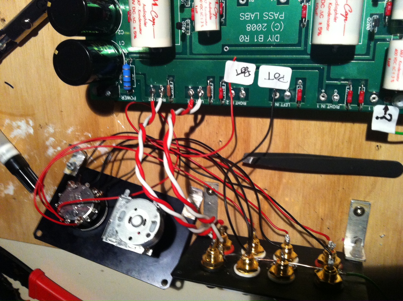

Now , the ******* Pot .. ! I know others have used the Alps Blue Velvet ...

KKKK , Just got this link . Can anyone help converting these letters to whats on my board please .

Most likely In = CW, Out = Wiper, Ground = CCW
The pot is the easiest of them all. It does not matter what orientation you have the pot in, if you are holding the shaft and the body is behind, counter clockwise ('anti-clockwise' in the Queen's English, I believe...) is always the same side.
So... With the shaft pointing towards you, put the left most pin to "CCW", the middle to "W" and the right most to "CW". There are two decks in a stereo pot, so one of them is left, and the other is right. Which is which doesn't matter, just don't have any connections common to the separate decks.
So... looking at your linked photo,
IP to CCW
OP to W
Earth to CW

Not wishing to be a " knowall " looking at the back of the board ccw is the ground ... I reversed o/p and I\p and got a backwards pot ..... LOL . Sorry 6

I still have one channel down . Can anyone help with trouble shooting this ?
All solder joints and cables are good so, Looks like something in the board .
There are no voltage checks on the schematic that I can see - its beyond my skills to work them out on my own .....
