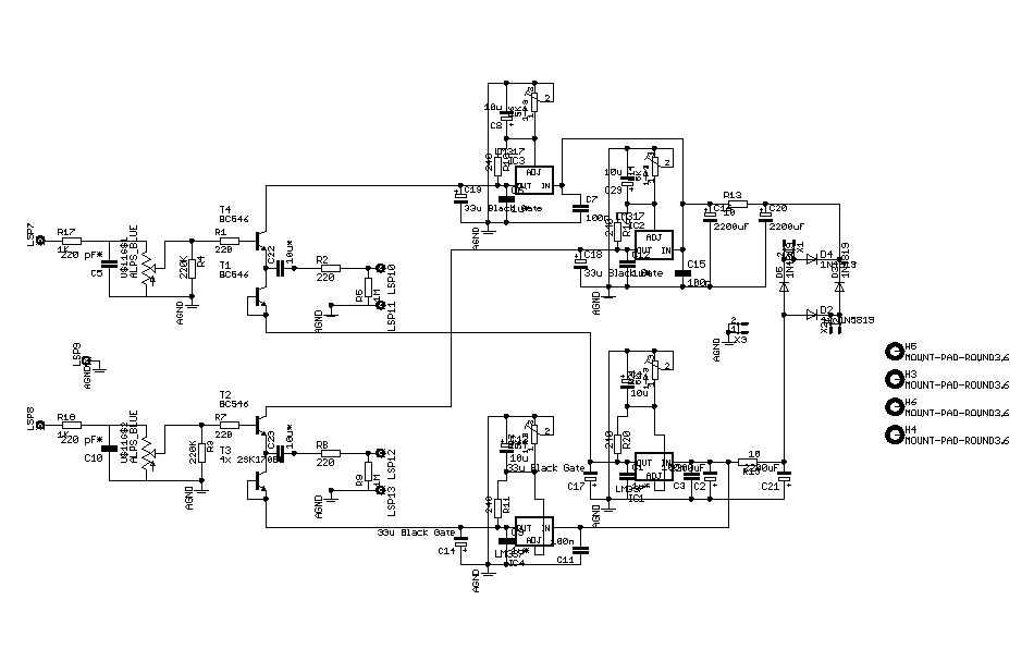

This is the updated schematic. I hope I did it right with Eagle....
I included double supplies and a Alps RK27 for volume. The 10 uF output cap can be jumpered for the aforementioned offset issues ( if they are a real issue that is ).
crt, please try to only jumper + and/or -, not GND.
As the file is too big I had to make it fit. Crt, if you want the original, I have mailed it to you.
jean-paul said:This is the updated schematic. I hope I did it right with Eagle....

No ! I guess 2SK170 was not in the library as crt choose BC types. This is not a BJT version.

Hi La Ode, the PCB becomes nicer with time but there should be caps before the 10 Ohm resistor. A 1/2 Watt type is OK for the 10 Ohm resistor as current draw is low. Please check the schematics for the extra 2200 uF caps. The jumpers to the regulators do not seem necessary IMO.
If the inputs would be at one side and the outputs at the other side wiring the PCB would be easier. The potentiometer would be at the lower right side ( seen from above ) and the outputs at the upper middle of the PCB straight to the output RCA connectors. Power connectors could be at the left side. Just like you would fit it in the enclosure.
You can still add the output relay like salas did to avoid nasty pops when the thing is powered when the amp is already on. We all like to think such things do not happen but they do
